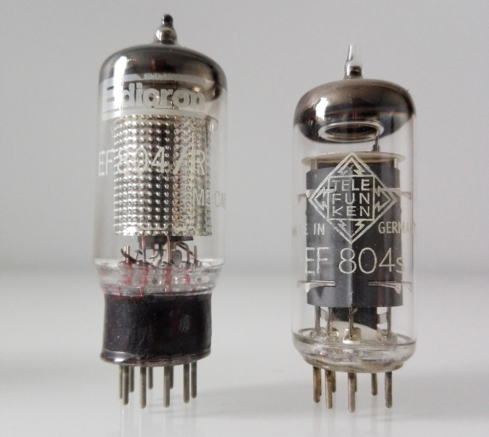

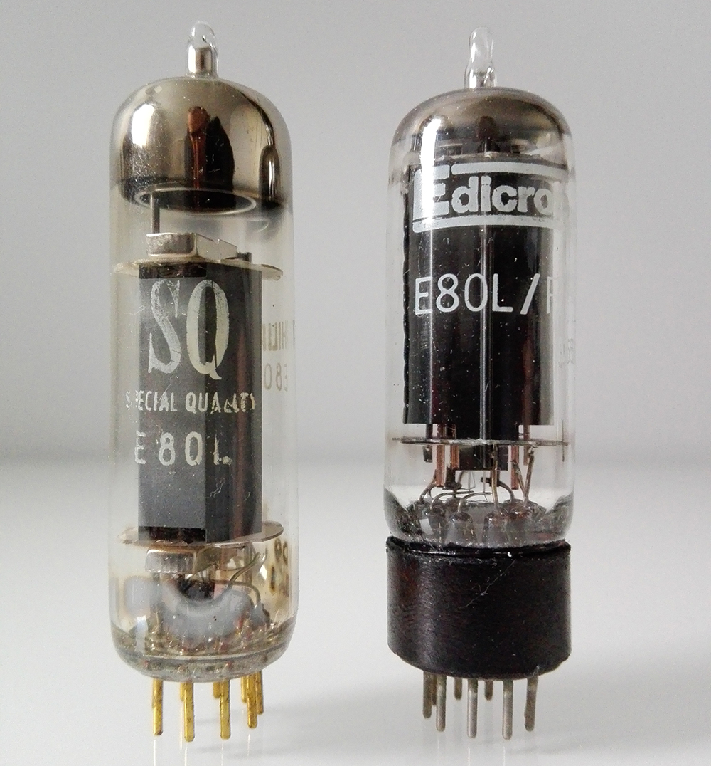

In my collection I have some Edicron EF804 as well as a few Telefunken EF804S. Also some Edicron E80L and original Philips E80L.
What I noticed is that the Edicrons look quite different to the original EF804 and E80L.
It looks like they both got another base and a different internals...
I'd like to know more about these weird versions.
Any clues?

The Edicrons are almost certainly a different but similar valve mounted on a base converter. For example, the Edicron 'EF804' might actually be a Russian EF86 with its pins rearranged.
Edicron are a British valve dealer/rebrander.

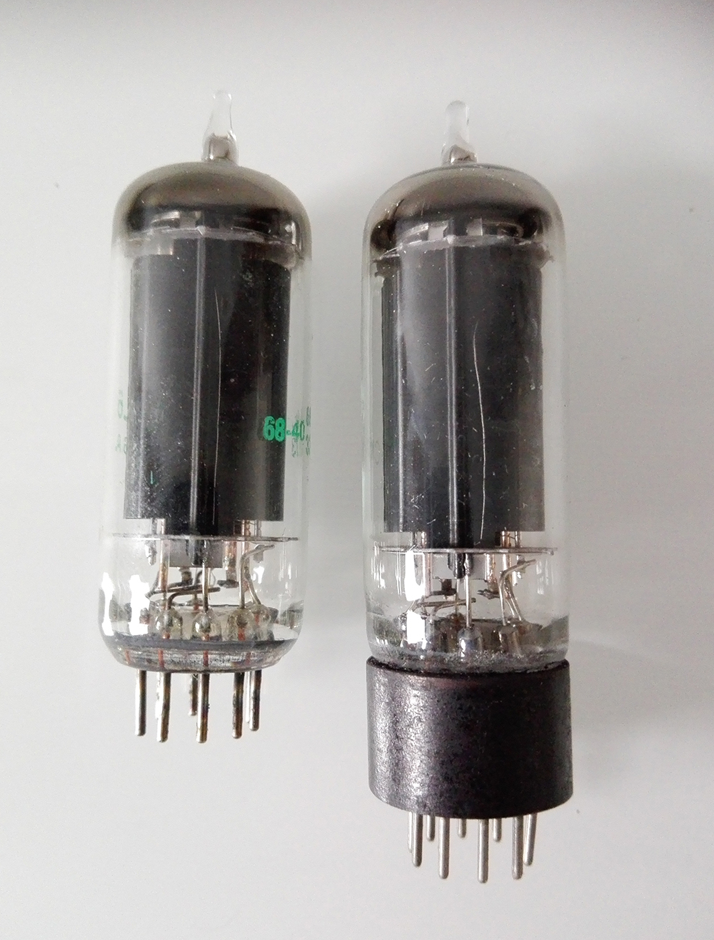

Perhaps. The E80L and 6CL6 have broadly similar characteristics. However, I would be annoyed if I paid for an E80L and received a 6CL6 instead.
Fortunately, I got those for free. 😀

The shiny screen/shield shown in post 1 is classically Russian. Looks quite different from western designs.
And… quite clearly, the bottom of the bulb is a classic mini pinout, metal-bonded-to-glass. The black base looks like a really crass approximation of the sturdy bakelite of Olde. To me. Ruskie retread.
Now I'll give this: Ruskie tubes can be of surprisingly high quality.
After all, the Russian military (and many civilian sectors) continued (and continue into the present) to use vacuum valves for all sorts of equipment that is too well built and expensive to toss-out-and-replace; the demands of such equipment continue to require "reasonable up-time", so the valves' makers must keep up the quality levels, or risk the wrath of the penny-pinching governmental maintainers.
So.
Even creatively post-packaged onto a pinout changing fake-o socket, the fundamental tube is still likely sound.
But I would imagine that having those close-to-the-grid-pin HF ringing damper resistors is even more important than with just the naked mini-pinout valve.

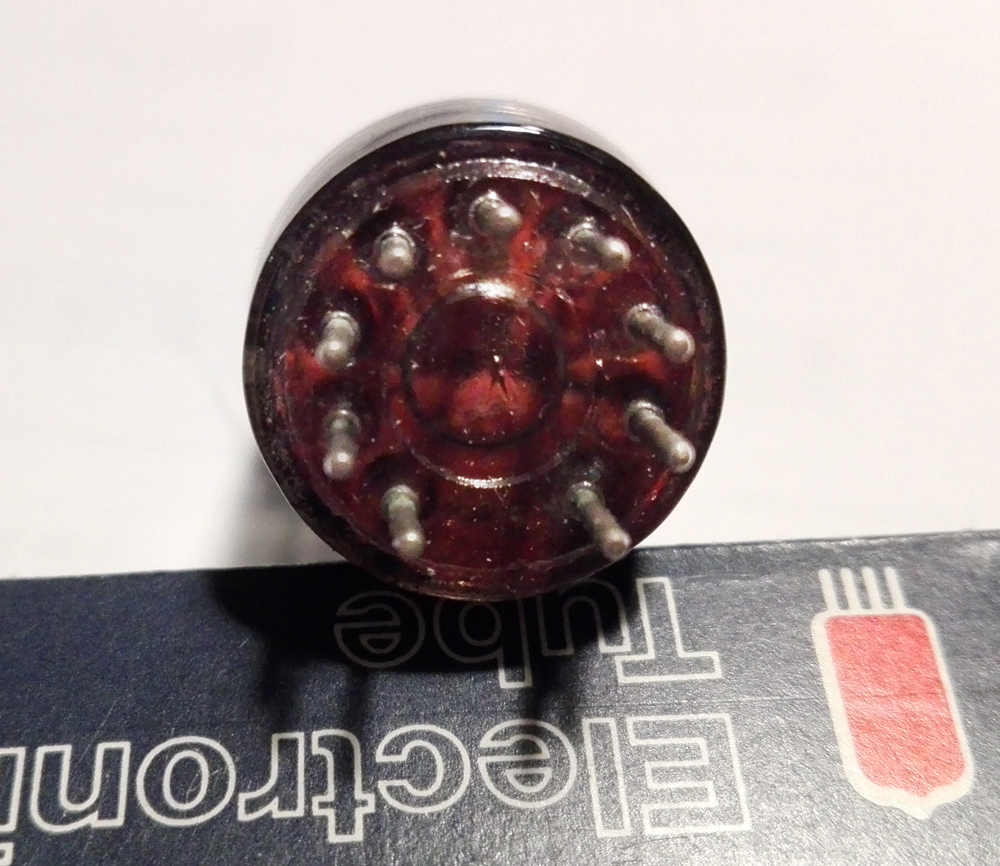

Here's a picture of the base. Some red substance is visible behind the second glass base.

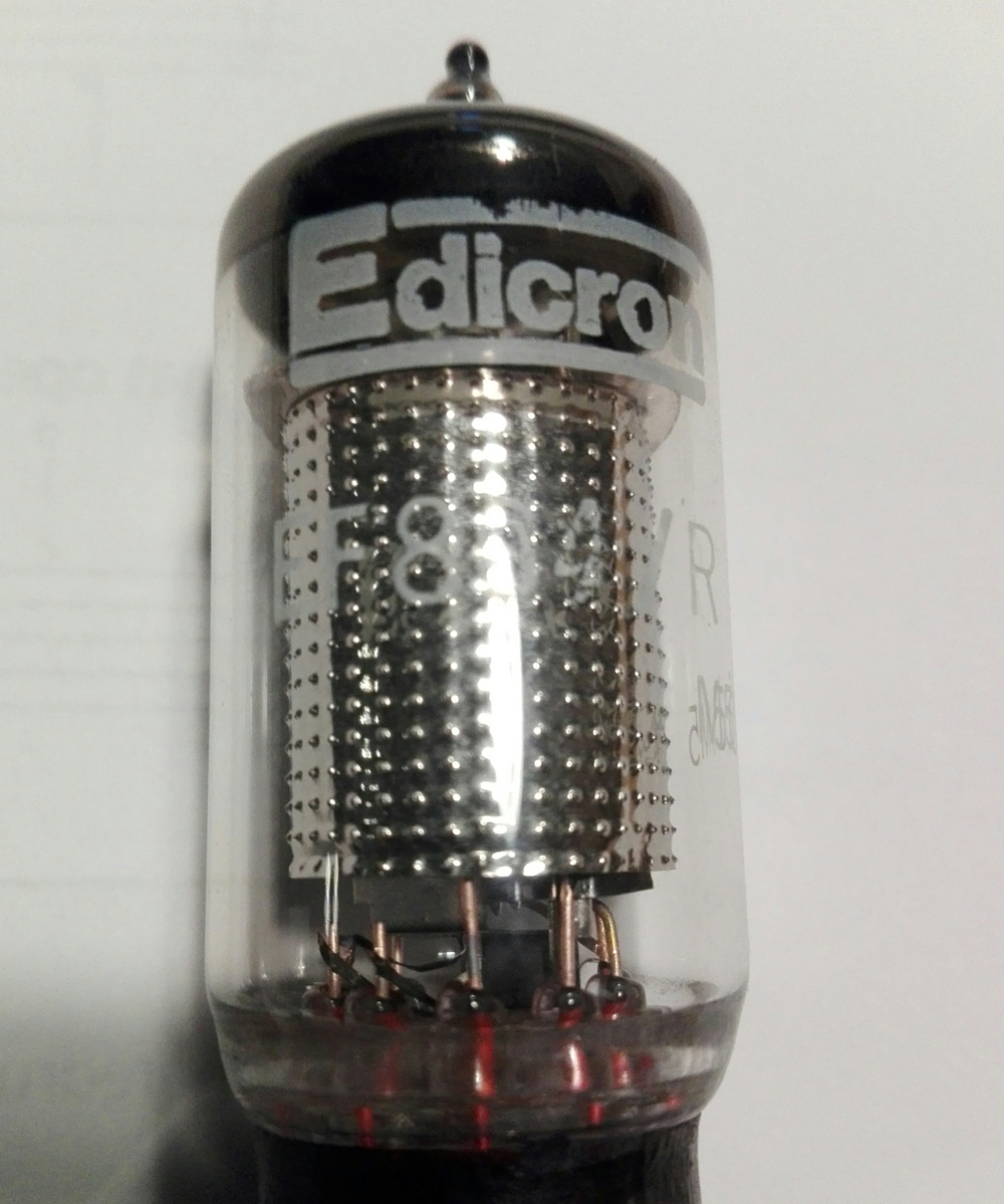

And another close-up of the plate structure. Looks definitely like the russian 'EF86'.
Using a good magnifying lens, you might be able to trace the real pinout of the valve that sits on top of this mysterious thang, and then compare it with the pinout of a EF804 on one hand and a EF86 on the other.
