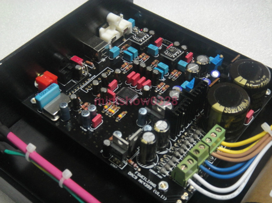

I've ordered one and have been reading up on mods for the 4396. I recently built a Beta 22 amp and i'm looking for mods that could benefit that amp in particular, perhaps direct out..?
How does the DAC9 sound stock?
I am beginner,so i have done it 🙄,direct out stolen from first resistor behind AOUTRP and AOUTLP. Datasheet says that internal switched capacitor filters the noise beyond the audio band. For my ears the woolen sound has gone,voices are incredible,bass improved by wide margin. I can do that because my Teac have input capacitors (2,2uF). Hi Markus, in stock i found DAC9 beter, more analogue.Don`t forget to buy sigma 11(wonderful power supply)Hoe long does it take to complete sigma22?
Now that's the spirit. My sigma22 took a while, the initial build was pretty quick but theni shorted it frying my beta22 and psu and it took a very long time to debug, but now it runs like a dream. Would i need caps on the output for the beta? I ordered a transformer from minishow, so i won't need a beta11 will i? (i've plenty of spare parts from the sigma22 and probably could build an extra beta11 if needed 😉

Looks as if the coupling capacitors are Silmic II.Slimic II are not suitable for digital decoupling, or ? I think also that the traces are a way too long.
I can choose between Wima MKS2 10 uf or 470 uf SEPC Sanyo. Any suggestions?

I tried Panasonic FM in place of FJ before lm7808. Wow, anything gone bad, no air, no magic, voices are far away. Anybody knows FJ? Can, t find anything about them.

here's some info on Fu Jack - ????? - ???????????????
weird that a cap before a voltage regulator can have so much influence on audio..

Build quality of the board is fairly good, all solders are clean and shiny, only "defect" i've noticed is that the optical socket is at a slight angle i.e. not fully seated, should be a quick fix.
I also bought some opa627's to replace those NE5534's but listening to the DAC out of the box i'm in no hurry to improve things 😉 Can't really hear any wool 😀 , but i guess i can't judge that until after i've compared with direct out connection.

I replaced the ne5534 with opa627 today, and did a few back and forth switches to compare, my first impression was that the vocals in moved a bit more to the front and i gained some bass detail, it's still very smooth but now more vocal texture, roughness etc.
Once i've figured out which output caps to use, if any, with my Beta 22 i'll check the DAC direct out lines.

I have this dac any comments on the sound quality?, i havnt tried mine yet still waiting for the power transformer, but i will be trying direct out bi-passing opamps. I am hoping it sounds better than the mini ak4396 modded..
First Impressions: I have been using this dac in direct out mode bi-passing the op-amps directly off the 4399 chip and one thing I noticed right away is that vocals have a more pronounced echo and the sss is clear and natural sounding, after burn in it should sound different so will soon see. I am going to connect a I2s usb reciever soon and it should sound even better than the SPdif connection i am using now. The difference between 4395/6 the 4399 has a smother sound with the same details, but everybody has their own taste of what sounds good, to me this dac is great without any mods maybe mods could make it even better.
