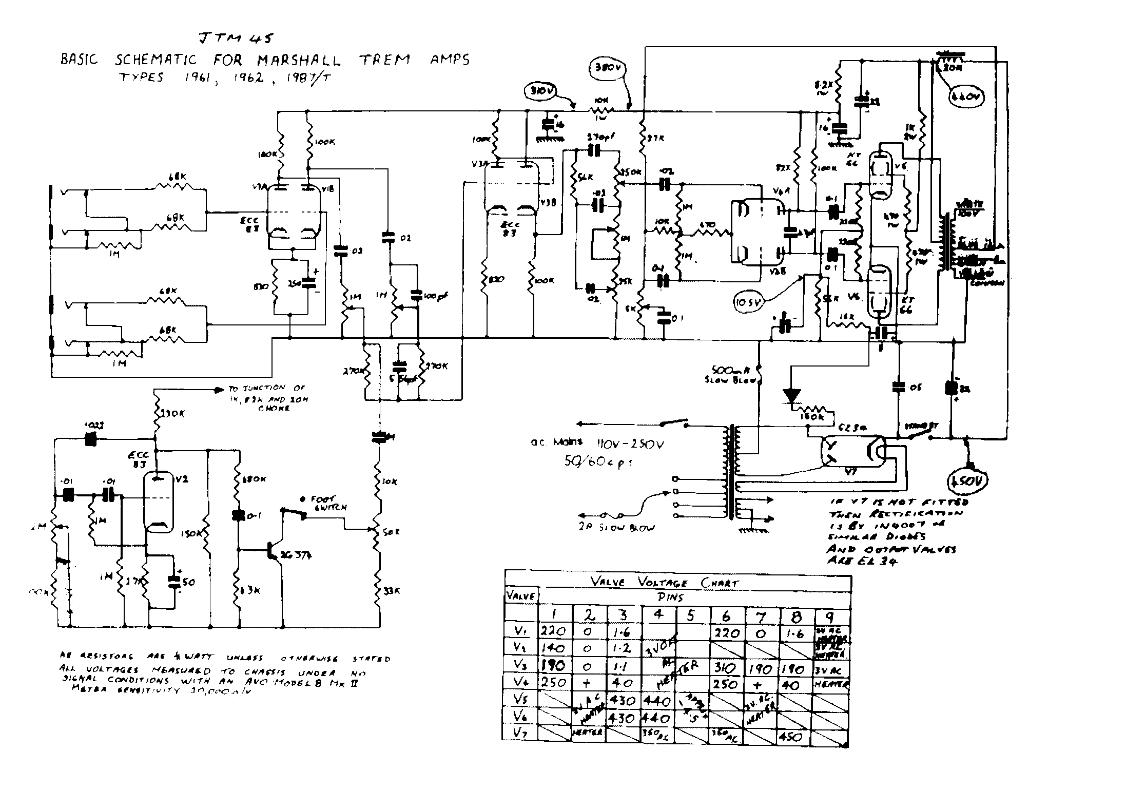

I'm sure the oscillator can modulate a FET or transistor for a variable resistance modulator, as in the JTM45T:
You'll have to modify the driving resistors because the around 3V RMS available here are much less than the 30 or 40V RMS available from a tube oscillator, of course.
