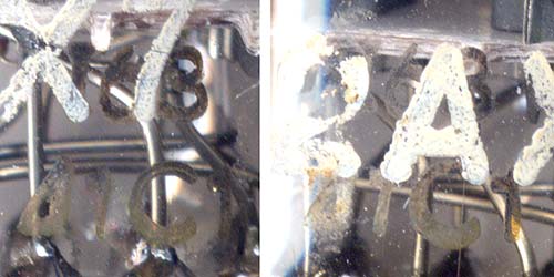

This page is useful in deciphering the Philips codes.
The attached picture is a scan of some small codes... the delta means that they were made in Herleen, a B instead would indicate the Mullard plant at Blackburn.
dave
