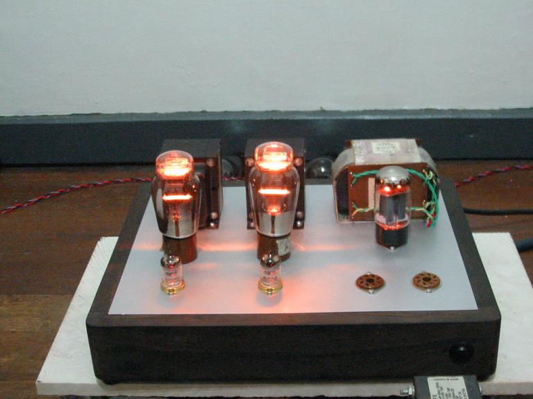

I got it to sound to my liking in this prototype -
And I used it for months, until friends saw them and thought they're ugly. So I looked for a "nicer" chassis which I posted at the pictures section of diyAudio (bad pic actually)
In the end I was gifted a pair of 50, made sume adjustments and I posted the project here - http://www.diyaudio.com/forums/showthread.php?s=&threadid=54336

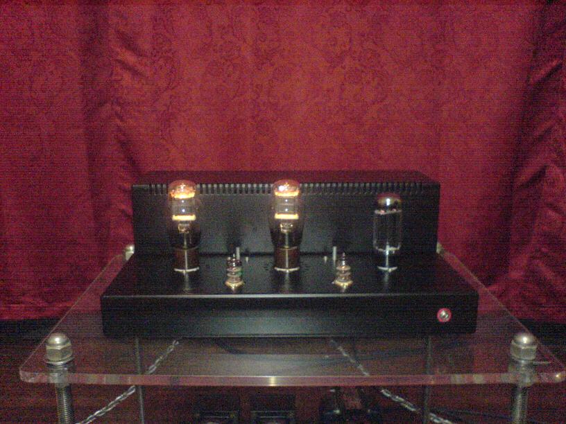

Here they are now in a "nicer" chassis-
It uses a 417A variant- the Amperex gold pin 5842 and now uses LEDs on the cathode.
My 45 uses plate choke on the drivers but in this chassis I don't have a place for another transformer so I will be putting in a pair of diyAudio's CCS boards in a coming experiment.
Why the 417A (and variants)?
1) Simple to implement (1 tube)
2) Have balls as a driver
