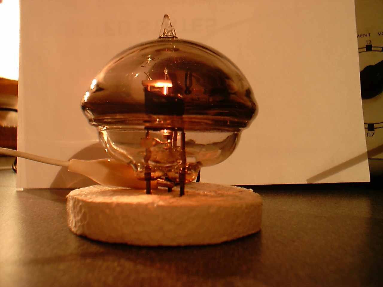

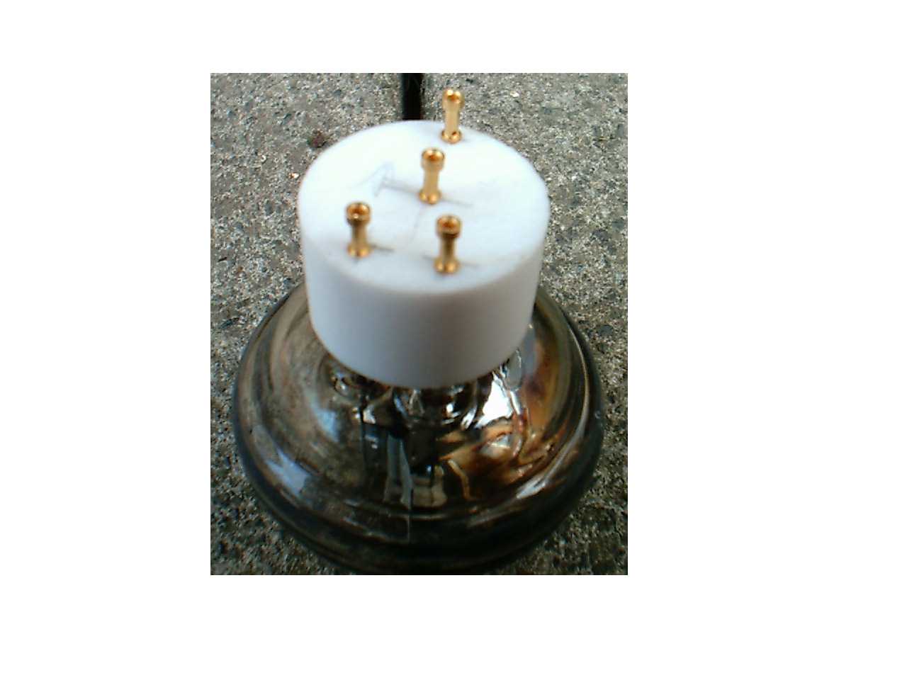

316a is pretty useless as an output stage , but should make an excellent driver . I played around with these things a while ago , and found it can more or less be considered to be a lower dissipation 801 . Ra around 4k , mu 8 . Sockets are unobtainium , I made mine from teflon and receptacles from a V35 connector (as pictured , hope this one is not also stolen......) Another alternative is just to use clip connectors for testing
ps That is my kitchen in the background ! Should read : 'Picture courtesy of 316a' . Please do not steal my pictures in future without prior permission !
cheers

Hello members,
Thanks for the info.
Yamamoto is building a tube amp with these tubes ,so it is possible to use the 316 in an output stage !!!!!!
Sorry that I borrowed your picture (steeling is not the right word)
Martin.

Yamamoto canes the life out of his 316a's ! Did you see the operating point ? I have no idea how long these valves will last at 25 watts or so dissipation . Compare the size of the anode to that of an EL34 or in fact an EL84 . To me , and what I have been advised by folks who use this as a driver , it's 8 watts max . It's a class C rated device remember : pulse operation . Pushing the dissipation to 10 watts or so and the anode starts to cherry-up , where they got the figure of 30 watts I don't know . These things are fragile enough already , just getting them sent in the mail is bad enough , they're such a beautiful valve , it would be a pity to cane the nuts off 'em in an output stage . One of many valves missing from Western electric's datasheet page unfortunately , I'd love to see the original specs/curves for these if anyone has these .
