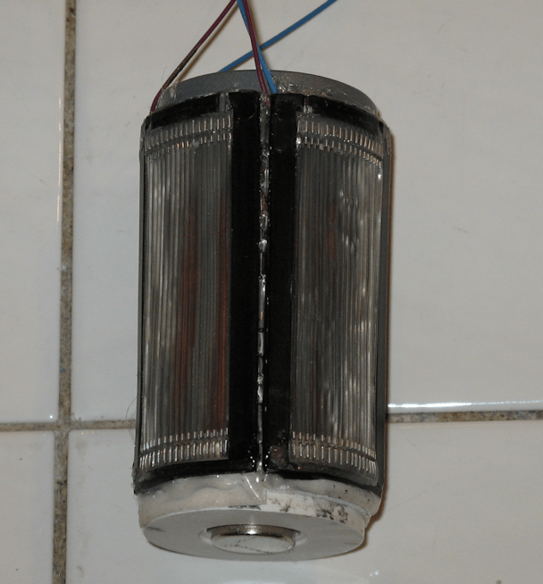

It is Christensen Audio AMT driver:
http://www.christensenaudioip.com/home.html
Also used in Aria AudioLabs AirBlade:
Love the 3 ways pictured... Airblade atop 777, and a pair of opposed 12" reverse mounted woofers.

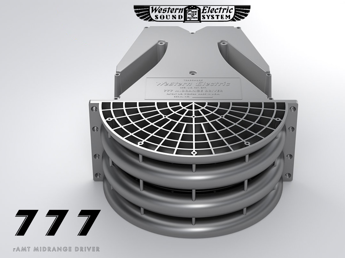

Just saw this nem midrange driver from Western Electric, the 777 Midrange driver.
Any ideas how it´s built?

The large AMT Dr.Heil invented has a large rectangular driver surface, the winged look comes from the magnet configuration. Since I too just saw these last night we can speculate if you turned this rectangle on its side, bent it into a crescent, reconfigured the magnets and built some kinda trap for the rear wave you could come up with something like this. If we just continue to speculate the original large AMT had excellent horizontal but poor vertical dispersion, this could be an attempt to solve this issue? Maybe Dave will chime in and end my poor speculations…
https://audioxpress.com/news/wester...-ramt-midrange-driver-at-high-end-munich-2022
The new midrange driver is the continuation of the work of loudspeaker designer and inventor E.J. Christensen, which audioXpress readers know already from its "wide-range, wide-angle, true point-source speaker driver," described in US Patent 9,124,964 (among others)

Yes, the back-wave are must certainly trapped.

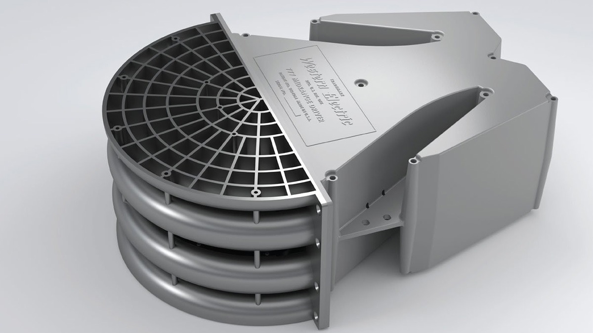

These are pictures from the press release from AudioXPress, hope it´s okay to show them here:
One can clearly imagine the trap.
When it comes to the front wave, the front magnetic structure must be in the two middle parts.
This as it looks like the upper and lower just are parts of the wave guides.
The hard part must then be to achieve an even magnetic flux between the front magnetic structure and the supposedly back magnetic structure.
I suspect the magnetic structures are a mixture of magnets and pole pieces; I don´t see that the magnets are placed at the ends as an ordinary AMT.

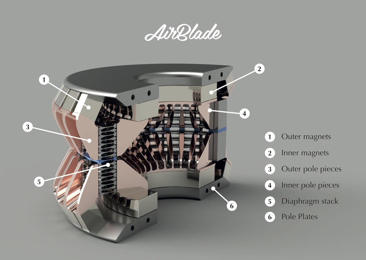

Thanks for the link, it was very instructive.
But it says about Heil´s patent: "These views don’t show much detail of the magnet structure, but give an idea of how the diaphragm would radiate in all directions".
So I would love to the outer shell of this (picture from the link above):
And how one accomplishes an even magnetic flux between inner and outer magnetic structures.
