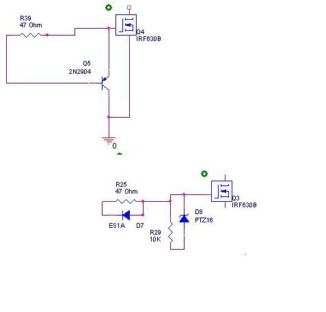

I was doing a test on MOSFET. the circuit that i used is a resistive switching test circuit. So when a voltage pulse of 15 V with 95% dutu cycle is applied to the gate. The drain to source would be 0 for 95% duty cycle. But the problem here is when the gate pulse goes to 0V after the 15V pulse, the mosfet is not discharging properly and the drain to source voltage is merely 0V. what are the possible ways to make the mosfet discharge faster.

Discharging the MOSFET
I could understand that the MOSFET you are operating in 95% duty cycle is not discharging fast enough.
Normally i use a reverse diode from the Gate to Pulse generator.
One more option will be using a discharging transistor.
I have attached 2 sample schematics. for both the solutions.

Hi jtkraj,
Your second circuit is alright but first circuit requires a diode as shown in s.g. mahbub's first one - fig.1. If diode is not provided after 47 ohm resistor, then when the gate charge will be grounded, then the input gate driving pulse will be also grounded which will distort the gate driving pulse.

Another Option is to replace the gate resistor with a small inductor. The inductor will block RF oscillation while providing maximum current flow.

Techguy, you made a mistake. TLP250 as shown in option 3 in s.g. mahbub's attachment, is not just an optocoupler. It is an optically isolated dedicated MOSFET / IGBT driver made by Toshiba and has current capability of upto 1.5A and frequency upto 25kHz.
Yes, modern drivers use MOSFET totem-pole stages instead of BJTs, but there is a problem. To drive the driver MOSFETs in the totem-pole stage, you need another gate driver, but for BJT, it is not required, so for novices, BJT is preferable for learning purpose, so that afterwards they can use dedicated MOSFET drivers.
To omit the VCEsat voltage problem, you can place the pnp on top and the npn below. It will act as an inverter totem-pole stage but will still drive the MOSFET at 12v (that is, if the supply voltage is 12v).
This stage practically has no frequency problem, as BJTs can operate at VERY HIGH frequencies. e.g. I use the BC327 and BC337 which can operate upto 10MHz.
But, for learning purpose for novices, a BJT totem-pole stage is the best choice.

I realized that the TLP250 was a gate driver. A BJT totem pole will still have a voltage drop across the transistors. The purpose of using a totem pole is to elminate resistance and to permit faster turn ons but it doesn't eliminate Vce(sat) as well as reduce switching losses created when using a series resistor. Take the TLP250 or a set of NPN and PNP transistors and measure the gate voltage when its turned on. If your supply voltage is 12V it will probably be between 11.7 V and 11.3 V (lower if the NPN has a really lousy Vce(sat)) You will have a voltage drop caused by the Vce(sat) of the NPN transistor. When you reset the BJT totem pole, the gate voltage will fall to the Vce(sat) of the PNP transistor. Although this shouldn't be a big deal unless the Vce(sat) is so large that the MOSFET never turns completely off.
A modern Gate Driver such as the IR2110 use built-in Mosfet totem poles instead of builtin BJT totem poles. See Page 4 on http://www.irf.com/product-info/datasheets/data/ir2110.pdf
The TLP250 looks like an outdated design. 25Khz is a pretty low switching speed. Put the Tr and Tf are very slow (measured in microseconds). Tr and Tf for the IR2110 is measured in nanoseconds. The slower the Tr and Tf is, the more switching losses are created. When a Mosfet gate voltage changes the it switches out of full conduction or from non-conduction into a semi-conduction state causing resistance. This resistance causes energy to disapate into heat. Ideally you want fast gate voltage rises and falls when switching.
Hi Tech Guy,
Thank you for thread bare analysis of TLP 250 and in depth analysis regarding modalities of modern gate drivers. You are absolutely correct in your perspective, but here the scenario is different. Here, a new entrant in the world of power electronics wants to know the all pros and cons of gate drive techniques, which requires lot of theoretical as well as costly, lethal and time consume practical knowledge. So, question to you,
What do you prefer for a new entrant, try to learn through basic configurations within the frequency of < 25KHZ and when perfection is achieved, then going to greater KHZ freq. using the ICs like IR 2110/2181/2185 etc. or straight way landing in higher frequency range with the drivers you mentioned, when even basic modalities are still unknown to him.

Jegandren, you should move slowly but steadily in the vast field of Power Electronics. Don't try to move fast. If you do, you will find your lot of energy, effort, money, time and material is wasted. Make your foundation stronger, and then you can move fast. In dynamics, there is a formula, time of ascent = time of descent. It is applicable in the Power Electronics field. Keep it in mind. Do not rush and land up in S.M.P.S. minefield.
