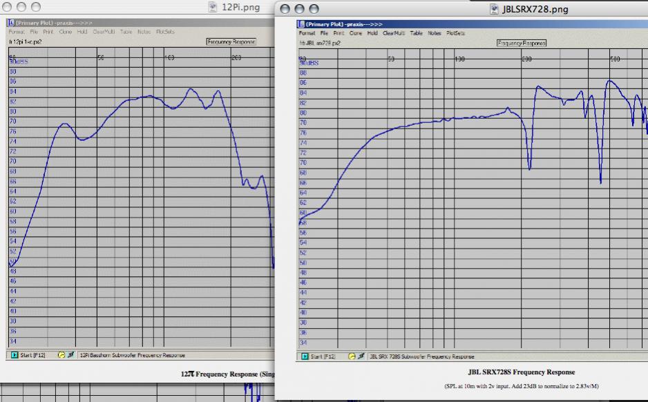

The 12 Pi is almost double the volume of a typical dual 18" box. That 45" depth may not be a problem outside, but indoors may be. I have not used 45” deep cabinets since the late 1980’s, they just didn’t fit in too many venues.yeah it is similar. i have plans for the labsub also, but actually it is a little more intense to build due to some compound miter cuts. thought i would look at other forums on opinions. seems on the prosound forums everyone is biased towards the labhorn as with Bill Fitzmaurice's designs on his forum. i have been wanting to build some push-pull dual 18 cabinets, but i forgot about Wayne's 12Pi and how they used the push-pull concept also. the box is big, but would only be deeper compared to a dual 18 cabinet.
If you compare the graphs of the 12 Pi to a JBL SRX 728 ( 98 dB one watt one meter at around 80 Hz) you see the 728 actually puts out more level at 50 Hz.
You could put almost two of the 728 in the same truck space as the 12 Pi, and two 728 would give another 6 dB over one.
My single 18" Keystone cabinet, 45” x 26.5” x 22.5”, about exactly half the volume of the 12 Pi, is very close to the same sensitivity and frequency response of the JBL SRX 728, the 728 has a bit more output below 37 Hz, the Keystone a bit more above 80 Hz.

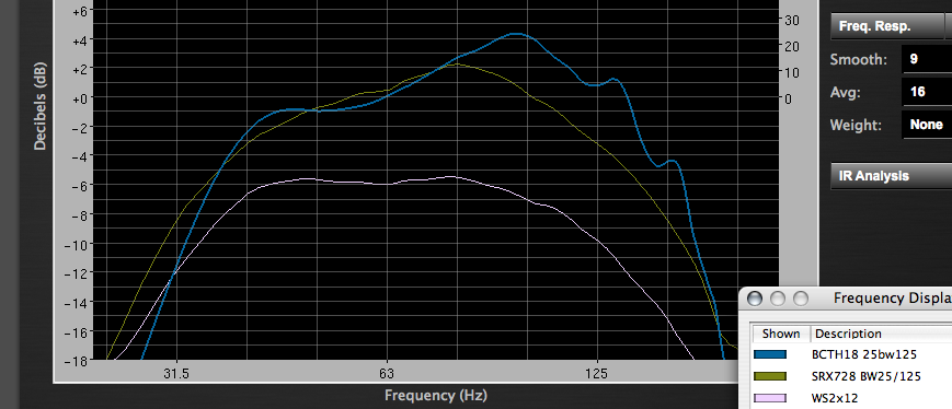

Two Lab 12 in the Keystone enclosure are even more sensitive than the BC18SW115-4, but can't take as much power without thermal compression and running out of excursion, the BC18SW115-4 will put out more SPL given more power.
Two dual Lab 12 in ported cabinets half the size of the Keystone sub comes out to the about the same size and level as the single 18” Keystone, but uses twice the amplification.
Two dual Lab 12 have more LF output than the JBL SRX 728 and take up less space.
You could fit four of them in the space of one 12 Pi, and not get a hernia doing it.
As far as the reduction in distortion due to push pull, a brief look at the 12 Pi distortion compared to the Lab 12s in ported or TH cabinets shows that the 12 Pi has perhaps a bit more distortion than the normally mounted ported 12”, and a bit less than the normally mounted 12” in the TH.
As long as the Lab 12 is run below Xmax, distortion is not much of an issue no matter the configuration. The BC18SW115-4 will get a lot louder with less distortion than a pair of Lab 12s though.

EV MTL-4s get loud and punchy, but roll off steeply below 45 Hz, about 10 Hz higher than the Keystone.
If that low corner works for you, and you can afford all the cones, the MTL-4 design would be hard to beat, output vs. truck space.
However, LF extension always comes with either an increase in size or a loss in level.
I have not tried the Low rider 18 in the Keystone TH. From Hornresp simulations it looks OK, but is not close to the power handling and excursion capability of the BC18SW115. I'd expect it may "mush out" if driven hard in a TH.
