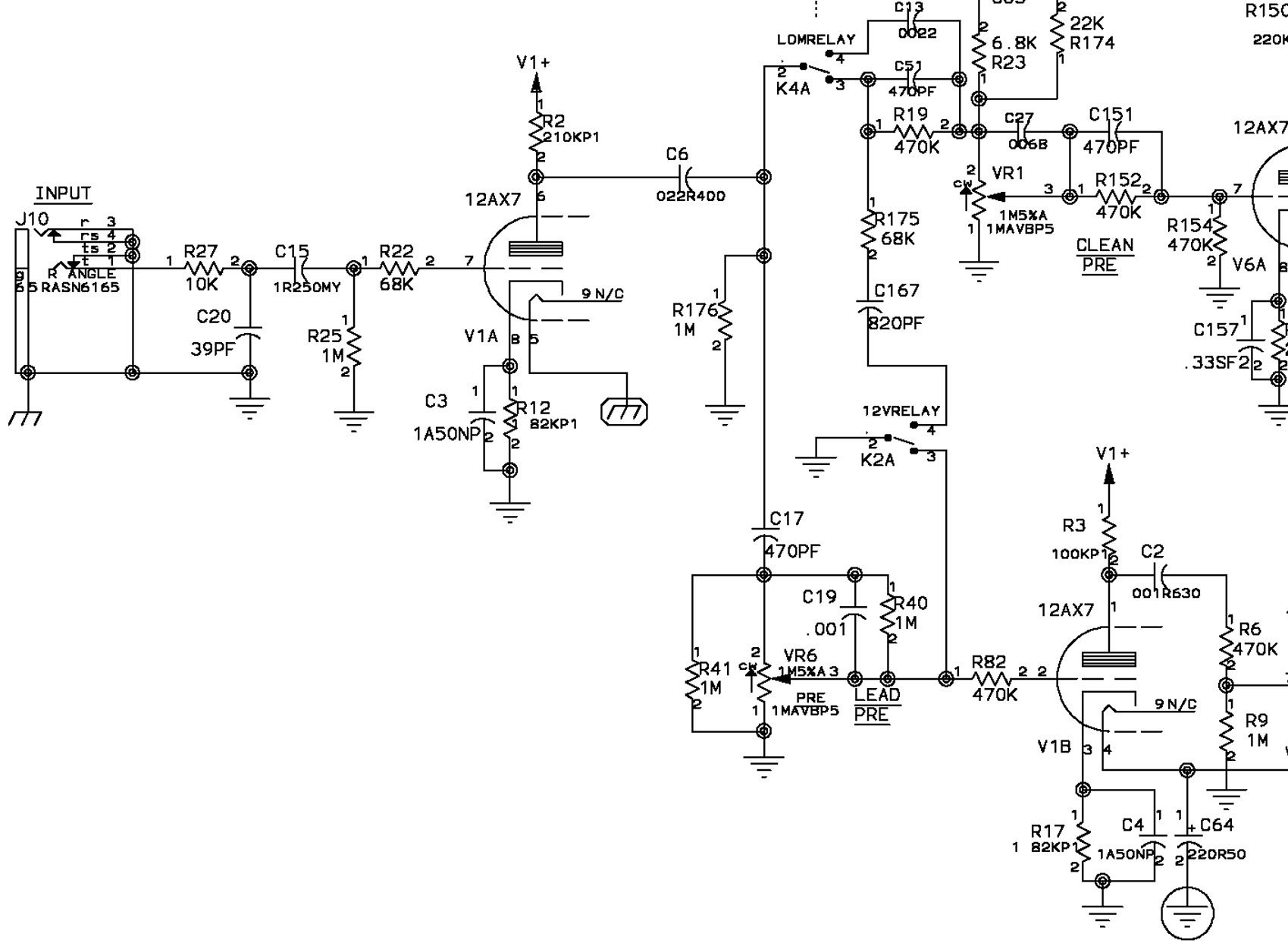

Hi, I've been trying to pinpoint the source of a noise in a 6505+ head. These things are notorious for a bit of "extra hiss" on the lead channel, but this is a roar like a waterfall. With the gain up to 75% or so, and the master just barely turned past 2, it's so loud that it's unplayable. It's just as noisy with no instrument connected. I tried replacing all input tubes one at a time, and I noticed that upon pulling V1 out, the amp is nearly silent, even with the master all the way up. I tired running it with the input stage plate resistor disconnected, and it was a little quieter, but still too much. I noticed that the first gain stage of the lead channel has a 470K series grid resistor (stopper?). Replacing it with a new metal film didn't quiet anything down either. Then I replaced every series resistor in the entire front end (input and 1st and 2nd gain stages of both channels) with new metal films. No change in noise. I am presuming that the original amp was at least playable, so I am still looking for a fault somewhere before I start trying to modify something. I looked at all solder joints under a microscope and there is no evidence of cracking or cold joints. Any advice would be wonderfully appreciated!

That's a very large series resistance, going to create a whole lot of Johnson noise. Grid stoppers don't need to be anything like that value, try 1k to 10k range perhaps?I noticed that the first gain stage of the lead channel has a 470K series grid resistor (stopper?).
In a sensible design most of the noise is from the input stage only, since it has enough gain to put the signal out of reach of noise later on.
Careful!
If that 470k is capacitor-coupled from a previous gain stage, reducing it to 10k will make blocking distortion ("farting out") more likely.
[ETA: I dont have the schematic to hand to check this.]
Also, it will increase treble response: that resistor also forms a high frequency roll-off in conjunction with the tube's Miller capacitance

Thanks everyone, I appreciate the help!
It is indeed capacitor coupled. I wanted to be careful about lowering that series resistance for all those reasons mentioned plus the assumption that this thing was at least useably quiet when new.
My review of my Blencowe/Kuehnel/Jones books remind me that early stages MUST be kept clean, and it's probably a series resistor (johnson) or an early gain stage tube causing the noise. I suspect having the input stage plus Lead stage 1 on the same tube was to contain it a known quiet tube to handle the initial gain.
I got zero change with AX7/(moderately used)7025 tube swaps, even an AU7 made little difference. I've replaced all series resistors in the first couple gain stages with good quality metal film, with zero change.
Pulling V1 silences the amp. This makes me think it MUST be input or first lead gain stage. When I lift the input tube's plate resistor, it's better, but still noisy.
Lead stage 1 is fed from the input stage through a 1M Pot to ground(Lead Pre control) paralleled with a couple of 1M resistors. On low volume the lead pot would short the grid to ground without that 470k resistor. There is no explicit grid leak resistor, just 470k plus Lead pot...
My confusion is what could have CHANGED to cause this much noise. Should I suspect the Lead pre pot?
