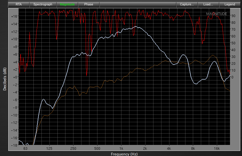

It looks like the MEH wizard simulates response like this... (2")
(and 8")

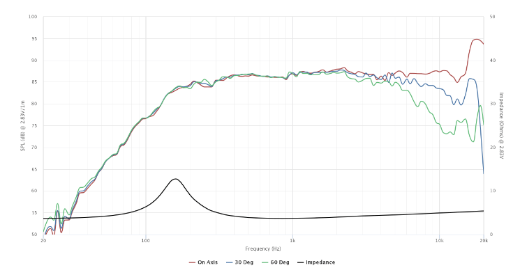

Your drivers are four ohm nominal, the 2" sensitivity spec is 85.9 dB/1meter at 2.83 volts (two watts) around 82.9 at one watt (2 volt).
- HF response on the 2" falls off. 2" spec is 85 dB @ 2.8 V and basically flat to HF on-axis.
The conical horn won't increase the 2" sensitivity much above 1kHz or so.
That said, upper sensitivity rises to ~87.5dB on axis above 1kHz.
Check that it does not exceed it's 1.55mm Xmax at SPL levels you'd like to achieve at your listening distance (-6dB for each doubling of distance, 88 dB @1m, 82dB @2m, 76@4m).

Oh, VTC, ok I see it. And ATC... and AP1 / AP2 and the length, like a horn segment. Oh man, I had just figured to have a hole (cylindrical), but put expansion (reduction?) on it? I wonder if that does anything useful, I'll have to play with it.Yes, the VTC (volume of throat chamber) will bandpass the woofer.
But I see the bandpass upper frequency on the woofer as a hole in response for the 2". That makes sense, a resonance going both ways. It looks kind of alarming but I wonder if it's really something to stress about.
I figure the radiation from the 2" will eventually narrow enough to not get much off the horn. So I've been wondering where that transition would be. The sim predicts output above nominal (85ish dB, sim is also at 2.83 V) until about 4k. But then it predicts falling below that level, which I'm not sure I trust. The FR from the data sheet suggest 60 deg off-axis is holding on until about that same 5ish kHz (give r take). If the driver is wide dispersion up that high (it's only a 2") I figured it would still be feeling the horn as a load / getting sensitivity. Am I off-base?The conical horn won't increase the 2" sensitivity much above 1kHz or so.

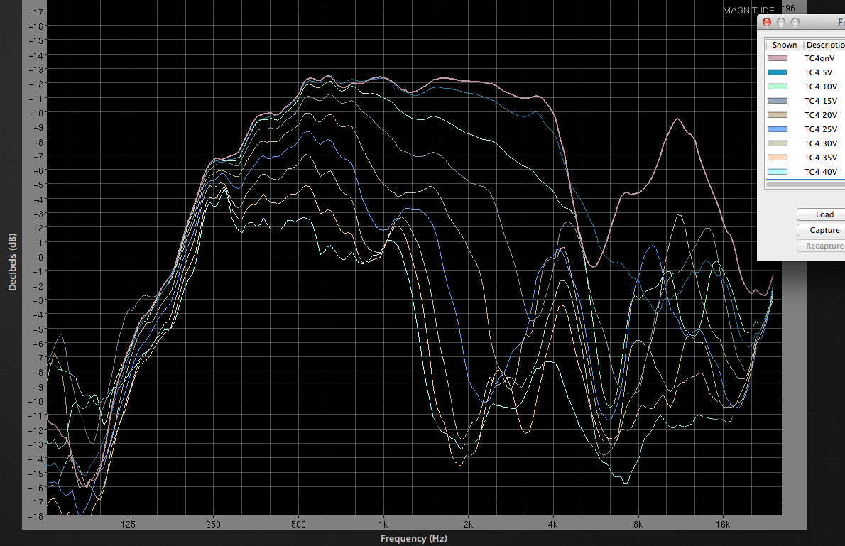

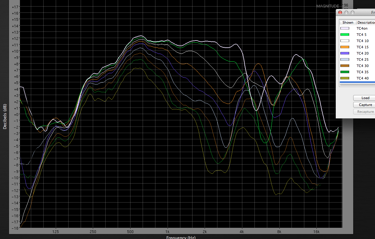

Using a small full range driver, depending on the horn's design and wall angles, probably looking between a -6 to -20 drop before a throat dimension notch, then a Hf shelf.If the driver is wide dispersion up that high (it's only a 2") I figured it would still be feeling the horn as a load / getting sensitivity. Am I off-base?
Using a 3.5" Tymphany TC9FD-18-08 the response difference between it on a cardboard 45x30 degree horn and front loaded on a 1liter bottle looked something like this:
There is a lot of throat detail work required to get the most out of small "full range" drivers:
https://www.diyaudio.com/community/...point-source-horn.285030/page-63#post-4644522

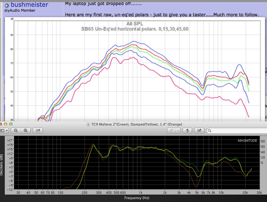

Oh, that's a big thread, but it looks right on the money. They got good HF results, but you think that's b/c of their more advanced horn geometry, have I got that right? I'll see how much of that thread I can wade through.
Conical horns have polar response drawbacks compared to other horn profiles.They got good HF results, but you think that's b/c of their more advanced horn geometry, have I got that right?
The throat transition area will create a problem for any 2" cone driver.
A conical family waveguide should normally be adapted at each end as to have no significant issues, regardless of the driver.

it looks like @bushmeister managed to get pretty good results after doing some throat work. I've got a 3D printer, and have already done up CAD for a circle to square adapter to fit my 2.5" driver to a 6 cm square. But I see bushmeister brought his adapter in over the surround and used some wool, so I'll have to keep at the thread to see if I can find more detail into that work. I've got other questions about how they did what they did as well, I'll prob pop in there to ask after I've read some more. I've seen a number of neat @xrk971 projects by now, and that seems like one of them. But their results look positive, so are you suggesting that I would need equiv throat transition tricks to get as good on-axis, but my polars would never be as good based on a conical horn?Conical horns have polar response drawbacks compared to other horn profiles.

Yes.But their results look positive, so are you suggesting that I would need equiv throat transition tricks to get as good on-axis, but my polars would never be as good based on a conical horn?
I've compared a number of conical horns polar response to other horn designs, they just are not as good as other "constant directivity" designs can be.
Conical horns are not bad, but since you have 3D printing ability, no need to limit your prints to flat surfaces, especially in the critical throat area.
