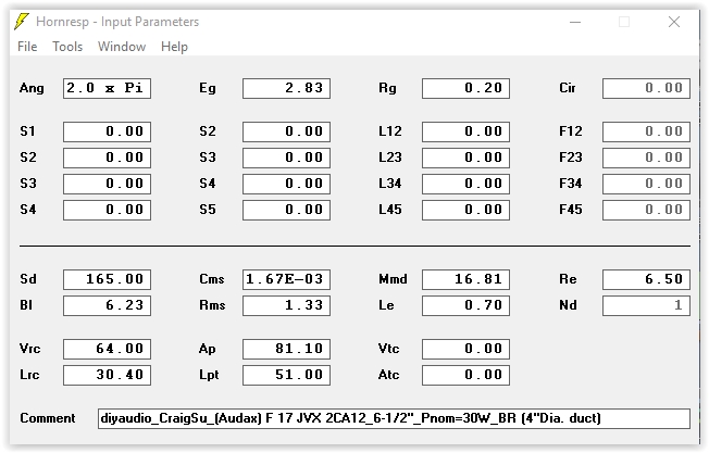

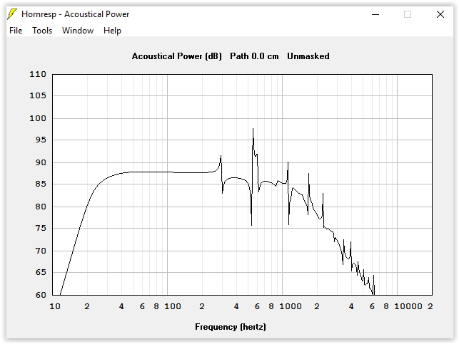

There is still a lot of data needed to arrive at an optimum suggestion, e.g.: external volume and aspect ratio, desired maximum volume, and I have not been able to find the Xmax parameter for the Audax driver. That makes it hard to evaluate how well suited this driver is for a subwoofer.
I recommend you download Hornresp, and use it to evaluate your options in addition to the good advice you are getting from Planet10. Hornresp gives you all the options to evaluate regular as well as isobaric systems (closed, vented, 1/4-wave). Keep an eye on the port particle velocity, if going vented you'll need at least a 3'Dia. (4"dia would be better) duct, or equivalent rectangular opening.
I'll attach a quick and rough example.

Hi CraigSu,
