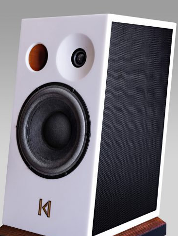

I noticed that the Kroma Mimi monitor (SS 854x + OW1) uses a waveguide for the tweeter carved into the front baffle itself, which looks quite nice, IMO.
Does this generally work well and is it difficult to do from a woodworking perspective? Not sure how the tweeter is mounted on the inside plane.

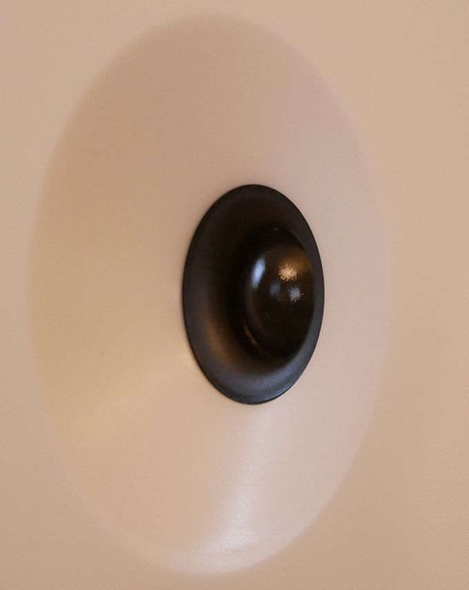

From two extra photos, I can infer that this manufacturer has kept the tweeter's faceplate attached, so one can surmise that it's just screwed on flat to the inside of the front baffle. The baffle itself doesn't look particularly thick, so the screws/bolts for the tweeter cant be all that long; though they must be secure enough, I guess.

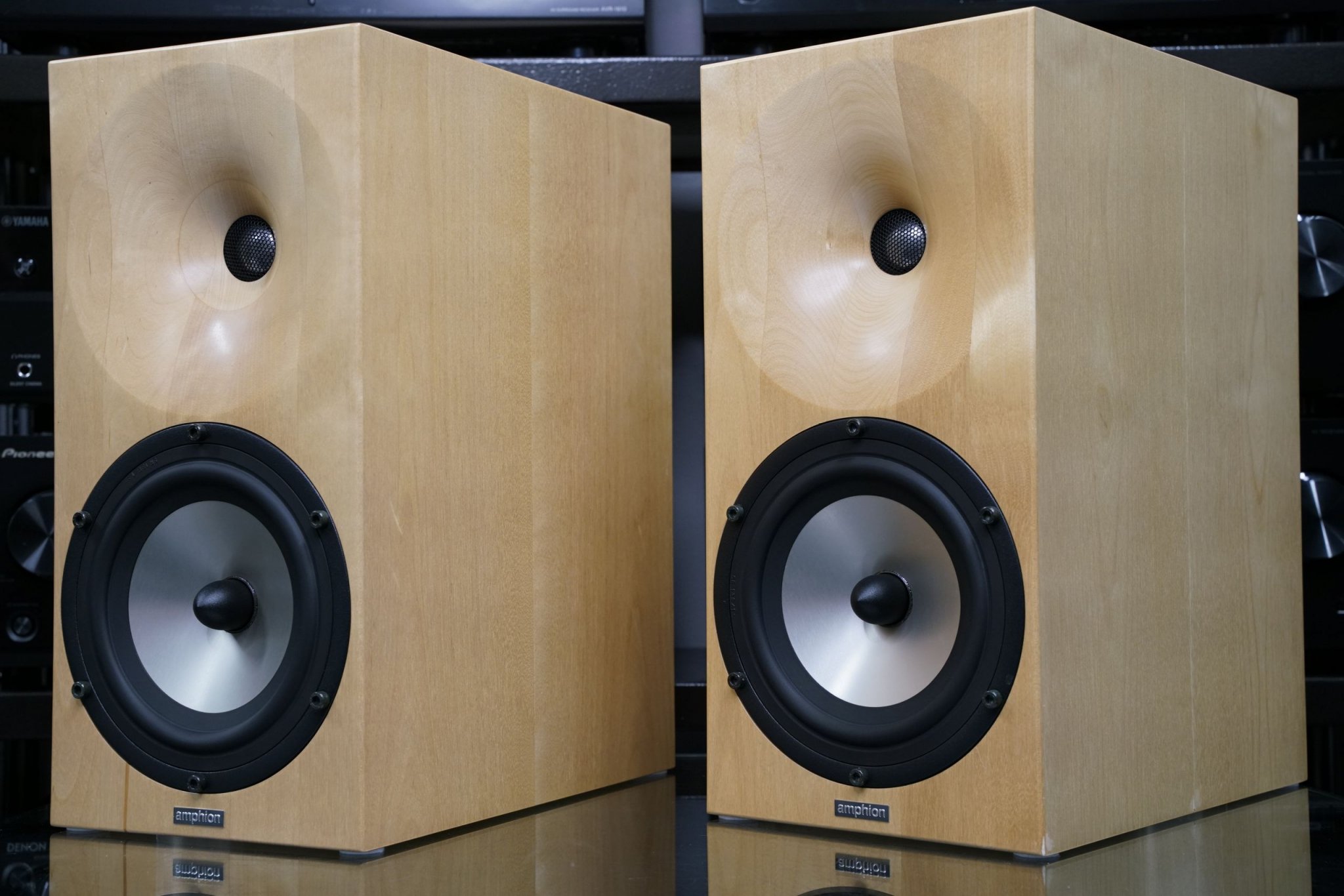

20 years ago Finnish Amphion Argon revised edition 2 was quite popular and well regarded. Birch laminate and some CNC... Actually seating the tweeter must be done very carefully to avoid major interferences above 10kHz.
http://www.soundstagenetwork.com/revequip/amphion_argon2.htm
https://www.soundstagenetwork.com/measurements/amphion_argon_2/

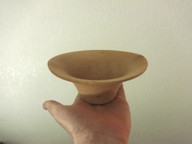

Thick wood baffle horn-porn. Ya, I can see it can be done. But how would I program a CNC to cut z depth as a function of r? What's the function?
I found a bowl someone made at a thrift store with an interesting shape - doesnt help much. Even if there were two...

Ah yes, Amphion have been doing this all along. I wonder how their tweeter is mounted, and if they remove the faceplate.20 years ago Finnish Amphion Argon revised edition 2 was quite popular and well regarded. Birch laminate and some CNC... Actually seating the tweeter must be done very carefully to avoid major interferences above 10kHz.
Although this photo shows they also use a discrete waveguide.

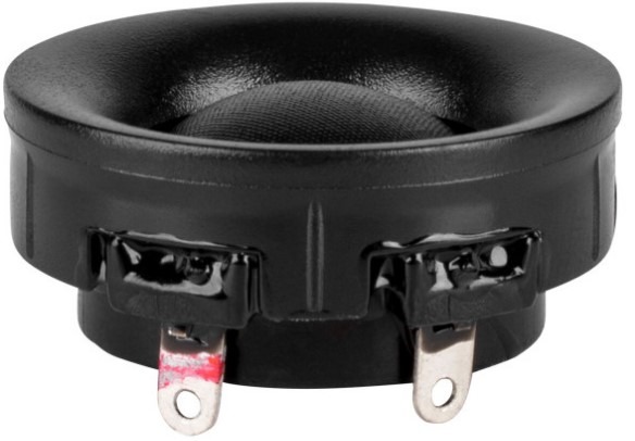

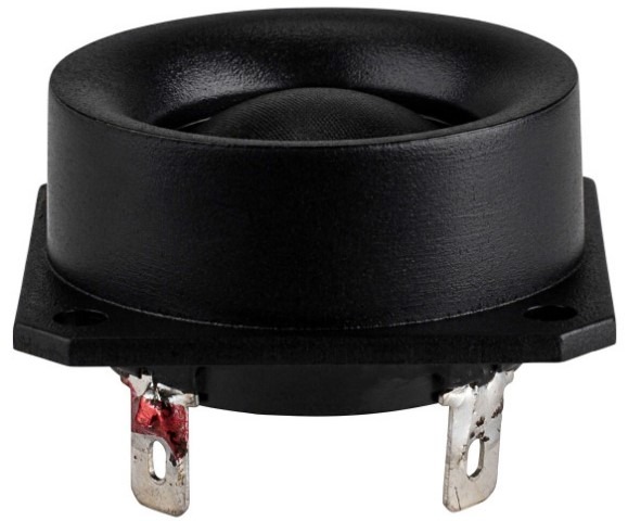

No idea, I have a pair of HeliumII and some speakers with SEAS coaxials. They use(d) SEAS drivers and most likely the tweeter is 27mm alu unit like this one (spare) from their coaxials
https://cdn.shopify.com/s/files/1/0...-4298-8198-70899425a69b_650x.jpg?v=1617626032
You can find many similar tweeters if you search for automotive speakers

They probably request Hiquphon for a specific OEM face-plate for the tweeter.From two extra photos, I can infer that this manufacturer has kept the tweeter's faceplate attached, so one can surmise that it's just screwed on flat to the inside of the front baffle. The baffle itself doesn't look particularly thick, so the screws/bolts for the tweeter cant be all that long; though they must be secure enough, I guess.
If they don't then it could be that they simply mill-out the face-plate (except the waveguide) and then use a "cup" (with it's own mounting) that pushes the tweeter to the baffle.

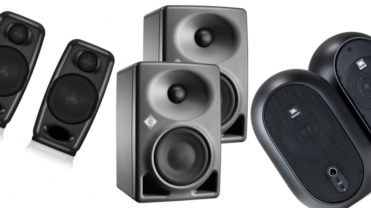

also consider doing a small monitor with a "real" horn instead. commercial mini-monitors (JBL I have seen) are going in this direction.
you can put a dome or ring radiator in a small horn and cross it much lower than on a baffle, get better directivity match with the woofer. there are threads here about that too.

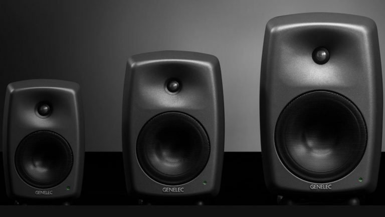

^ and all of those are going to be molded enclosures.
(..the Kroma Mini looks more like slab Corian in the same size panel used for baffle, top, bottom, and rear panels - and just milled for the baffle. One of the cool things about "Corian" and similar materials is that you can create a monolithic result with their "glue" which is effectively the exact same material as the panel itself - for joining those panels together, which is what the Kroma Mini looks like at the "joints" for those baffle, top, bottom, and rear panels. My grandparents had kitchen counter-tops & back-splash that were joined together in the same manner that created a monolithic panel, partly because my grandfather worked for Dupont - creators of Corian.)
Today, along with CNC, 3D printing is a viable means to achieve a similar result - especially if the print resolution is excellent (..as with many of the new Resin-based printers). 3D printing can also create forms for molds with other materials which might include casting a sufficiently dense polyurethane to achieve a look very similar to those molded enclosures above - like the less expensive designs from Genelec (..there more expensive loudspeakers are cast aluminum).
