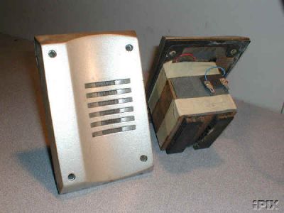

Indeed they are... but I didn't think they were so HUGE before seeing them with my eyes.. they measure about 10x15 cm and are quite heavy, more than 1 kg each.
I hope they really sound "as clear as light"

Raka, you forgot this
They are vintage ESS Heil Air Motion Tweeters, the smaller brothers of the worldwide famous AMT1 (oh AMT-Freak, where art thou?).
Those buddies have a lot of fans around the world... very hard to get them at a reasonable price even if used!

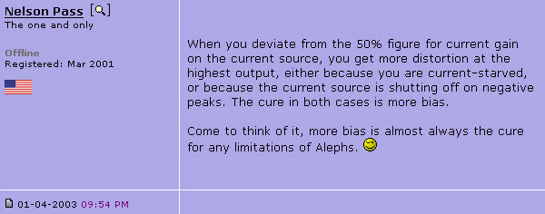

Some light at the end of the tunnel!
O.k
After alot of search on the amp and many hours
, I found out that the current source should be at exactly 50% setting otherwise distorts all signals above 10Khz very much. Moreover I found that feedback cup should be more than 10p(to my amplifer) towards 15-18p to remove the square wave ringing and distortion. Additionaly the 1n cap between the gate and and drain of negative side mosfets is very much needed as installed in the aleph3 and aleph5. Biasing the circuit to 3 amp without the active current source in the game(R21 removed) gave the best square and sine wave responce by far. Obviously the active current source is more of a marketing trick to get some more power in 4 ohms(flames welcomed

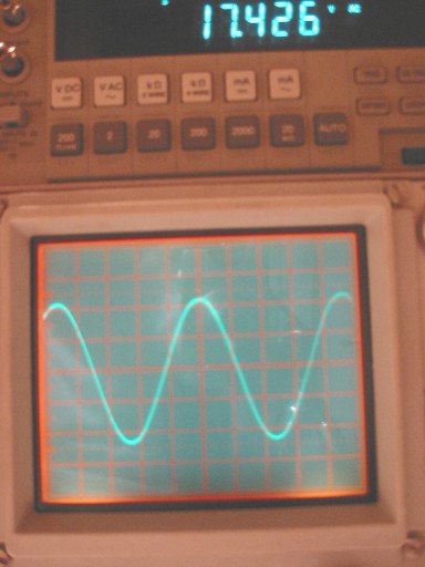

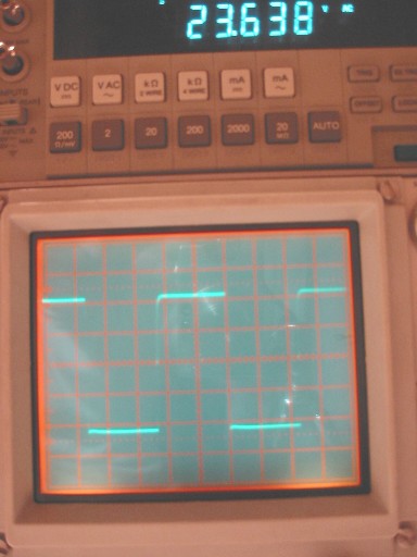

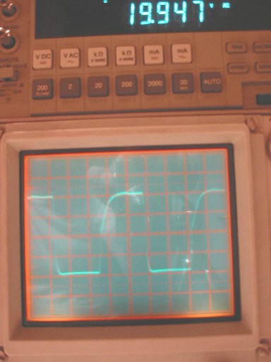

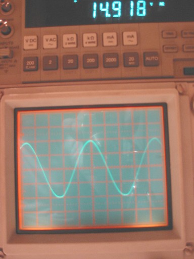

Measurements
I finally found some time to take some pics of the measurements I described earlier in this thread. After 1 hour warming at 60 degrees celsius, +-28v, biased at 1,6A. At top of scope is an RMS AC voltmeter and coresponding readings. No1 and 2 pics are 1Khz sine and then 1khz square just before clipping using the same setting on my signal generator, just pushing the square button after sine.
No3 and 4 the same at 10khz.
No5 and 6 the same at 20khz
No7 clipping sine at 1khz
No8 testbed
And my final question is: are these measurements typical of aleph topology or something is wrong? Soundwise the amp got lots of power and good control to my 15" Tannoys, but compared to my gainclone is a bit tiring to the ear although a bit more "alive" but less gentle and analytical compared to the simple gainclone using the same powersupply.
No8 testbed
