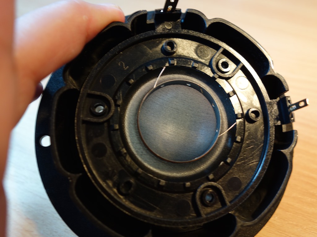

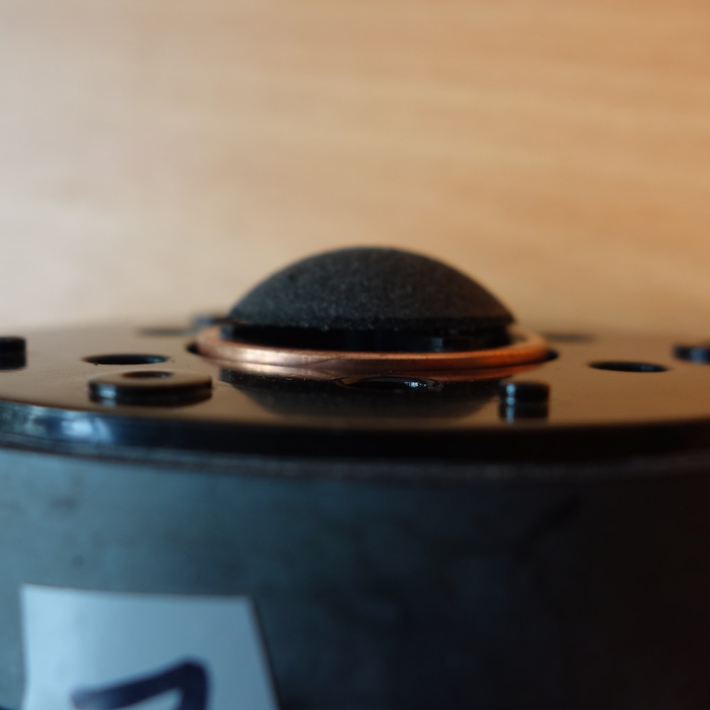

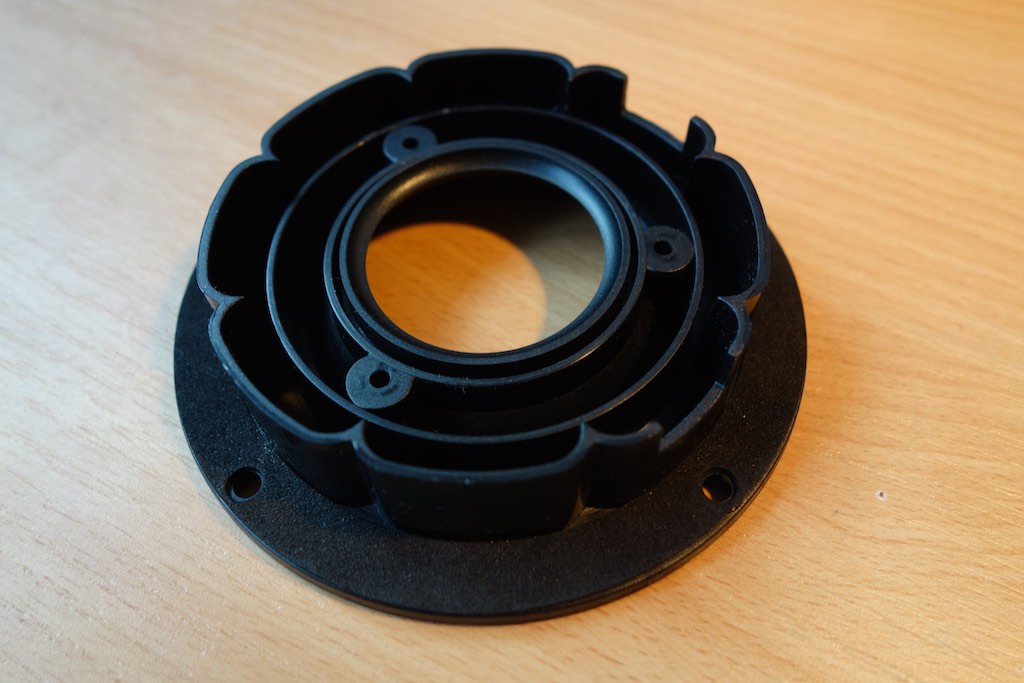

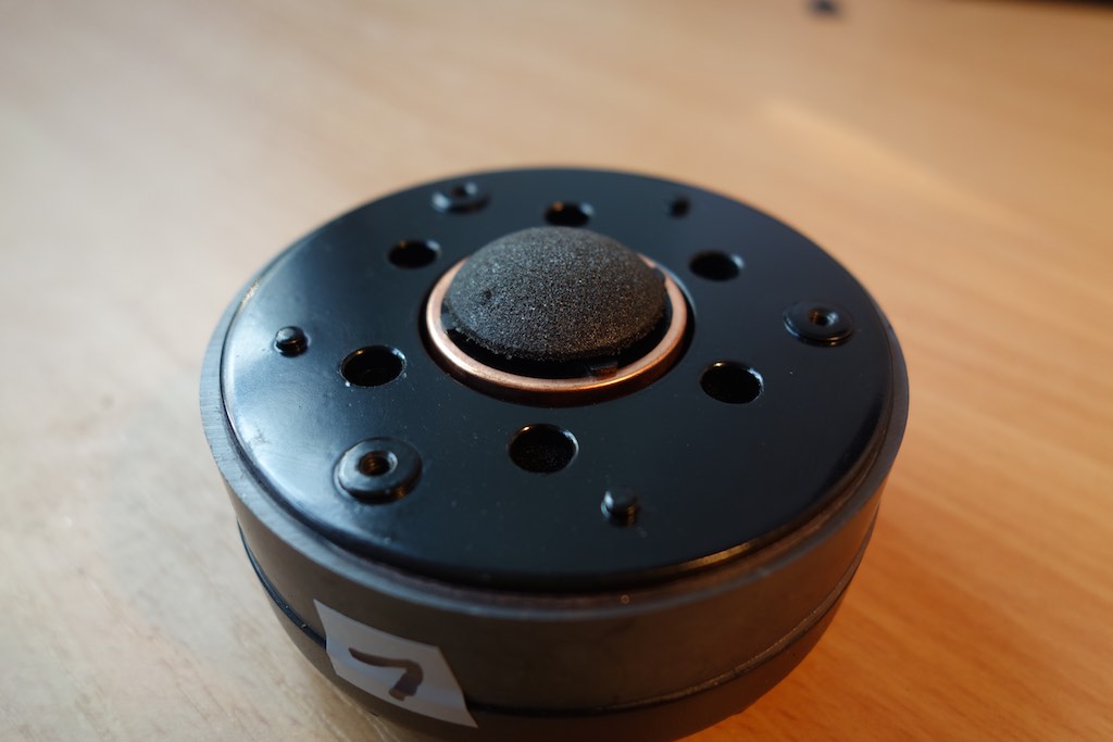

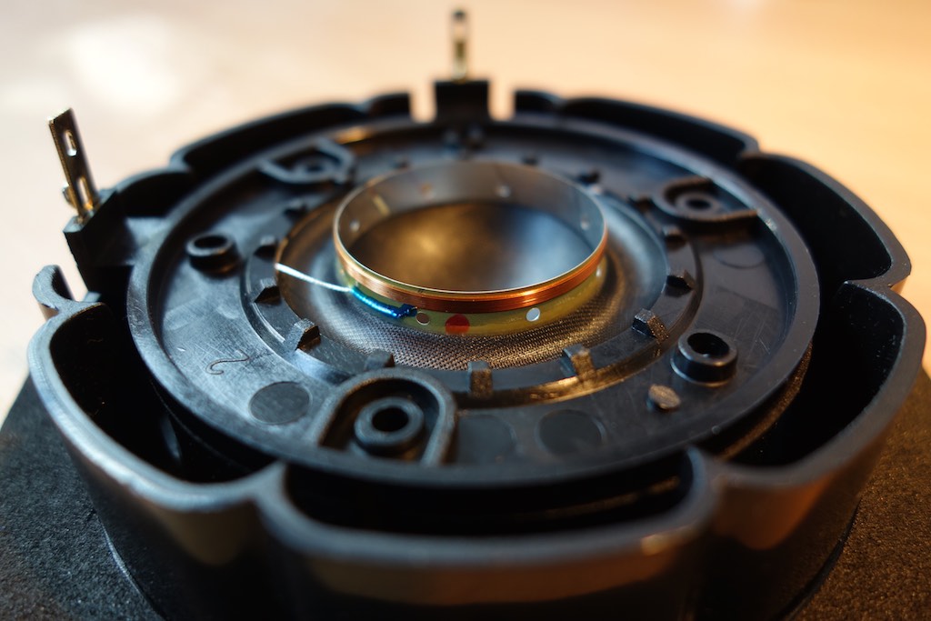

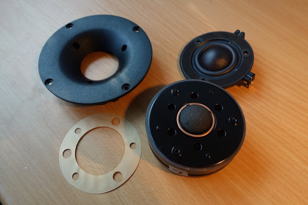

After pouring some tea over the tweeter (pls don't ask) I stripped the unit to get it dry. The view was so interesting that I wanted to share it. There's a heavy copper shorting ring combined with many ventilation holes above the voice coil. Additionally Wavecor is using space in the faceplate to expand the air volume - very nifty.
Bye the way, the patient is still alive. Perhaps they made a liquid test too. Re-assembling was a bit fiddly, but finally it worked.
