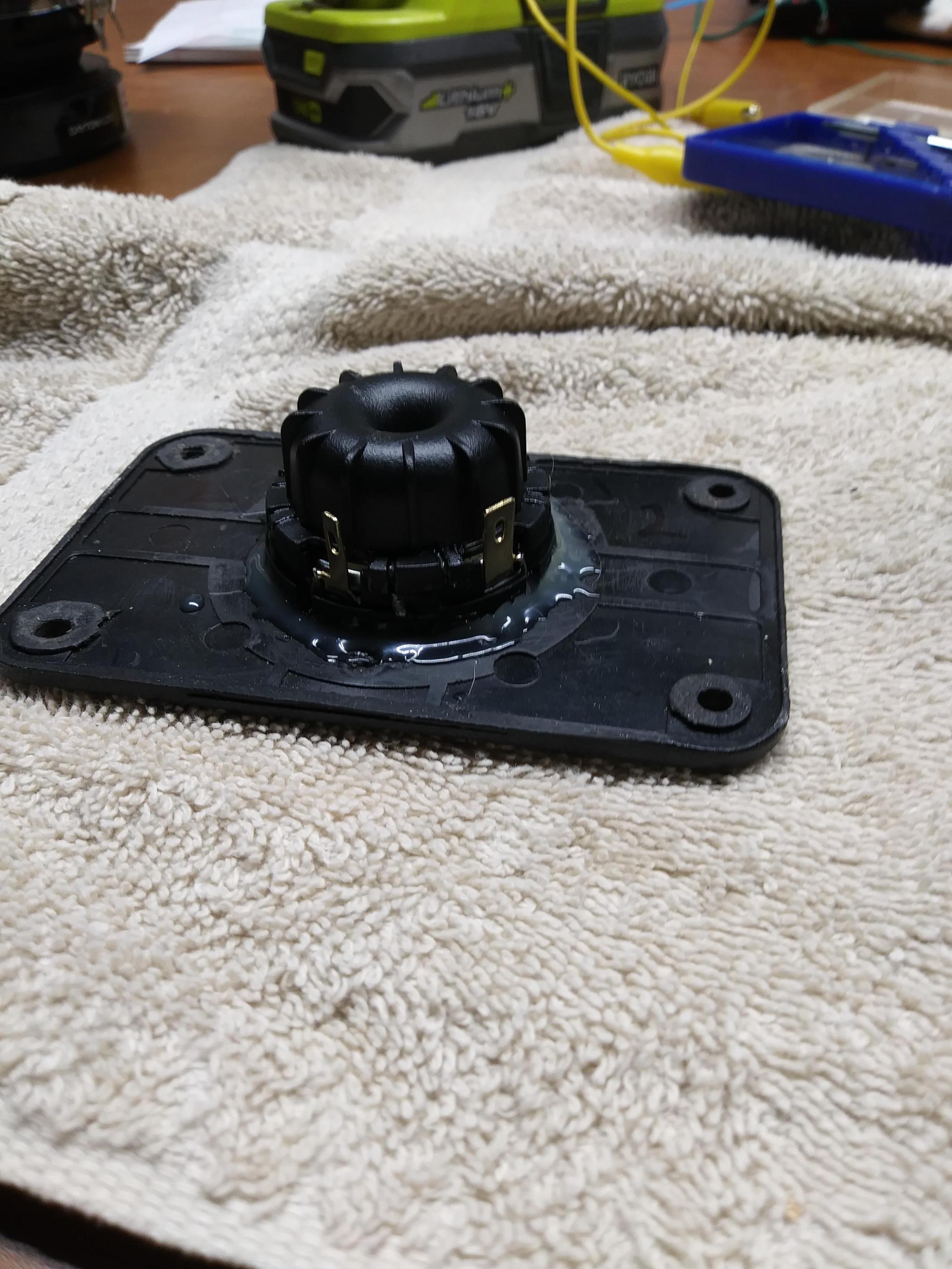

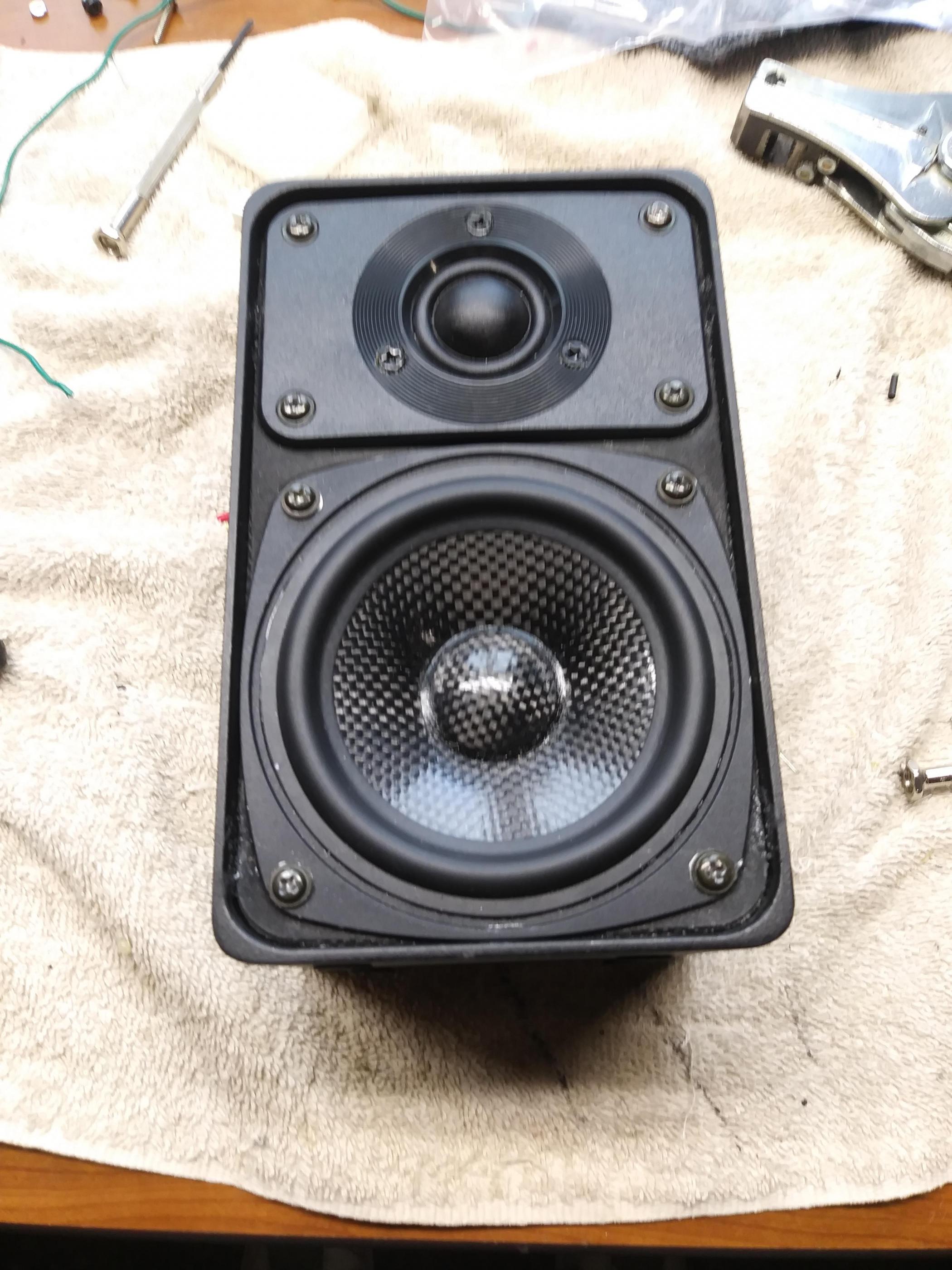

My application was a bit non-traditional: I deflanged them and mounted them into the original Radio Shack Minimus 7 tweeter mount. Along with new woofers (Parts Express CF120) and a new crossover these speakers really sing. I brought them to an Iowa DIY event and received a lot of favorable comments. Of course they need a good subwoofer for the low end.
