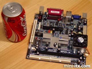

For a PC based solution, these new ITX motherboards look good.
http://mini-itx.com There are versions without fans.
I noticed there is a link to one that interfaces directly to an LCD display.

That mini ITX is really cool . Certainly would be quiet, and I guess it has the required horsepower even for DVDs.
My brother lives on a boat and I sent him the info: 12v, low noise low power consumption, can be sealed in an ammo box to keep the salt air out! perfect for him perfect for us.
