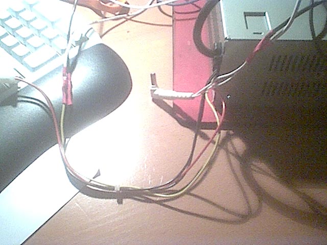

REGULATED POWER SUPPLY
do not run to Radio Shack to buy there 19.99 or 29.99 powersupplies....
run to your old pc's that you have kept in the garage, cellar or attick and remove the usually perfect working powersupply
then take a yellow and black cable from the ps and that should be a nice 12 volt and more than enough amps to cover the need of your lcd panel!!!!!
by the way, yes you can buy the small jack that enters the panel in a Radio shack to connect to the panel....
just one little addition:
If the PSU is ATX you've got to short the green wire with a black one (mainboard plug) in order to turn it on. 😉
