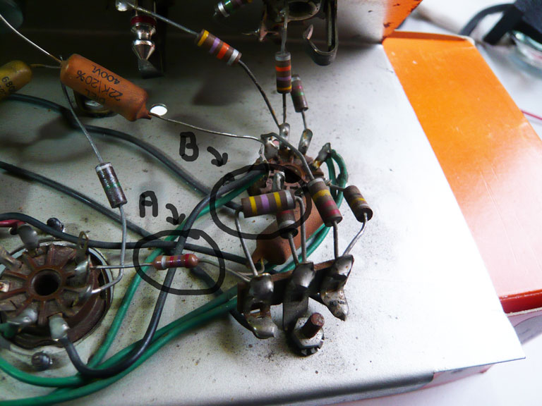

I'm quite new to tube amplification, and to improve my knowledge, I've decided to try to fix a friend's vintage guitar tube amp'. 🙂
The amp is a GEM Electronics (Italian brand) "Deluxe 10" model. It was probably build in the end of 60's.
I've found what was wrong, I've drawn the amp schematics and to complete my work, I'd like to determine what kind of resistors are to be used in place of the original ones, in case somebody would like to build his own "Deluxe 10"...
In the attached file, you can see a picture of the resistors.
Type A is only found on the grid of the EL84 and is the only one of this type. Is it a 1/2W or 1W resistor ? Metallic type or Carbon ? I've read that carbon type a more noisy, that could explain the metallic one on the grid of the power tube ?
Type B is found everywhere... Again, I don't know if those are 1W or 2W resistors ? 😕
If someone could help me, I would be quite happy to finalize my brief study... Thanks !

Hi Nick,
The A resistor appears to be a film resistor. Whether it's a carbon or metal film is difficult to say. Probably a carbom film and it looks like a ½ watt rating. Prefectly acceptable type to use here. And since it's on the grid, a higher wattage is unnecessary. The other B resistor is a carbon composition type and looks to be ½ watt also. Wattage is based on physical size, and I'm looking at the other components near by.

So you think both are 1/2 W, despite their different size ?
I have to study the different types of resistors...
As it's not easy to guess dimensions on a photo, I've taken some measures :
Type A : diameter=2.2mm length=7.5mm
Type B : diameter=3.6mm length=9.4mm

nio101 said:So you think both are 1/2 W, despite their different size ?
Yes. First I enlarged and lightened the photo to see it better. Then comparing "B" to the others as well as the terminal tie point, the tube sockets and body to wire size, it's a ½ watt. Carbon comp resistors have a thick molded body over the carbon rod that provides the insulation. Were you to break one in half, you would see this. A film resistor has only a thin coating of something (epoxy?) over the film-coated ceramic rod for insulation. Trust me, I've been working with electronic components long enough to have developed a well calibrated eyeball.
