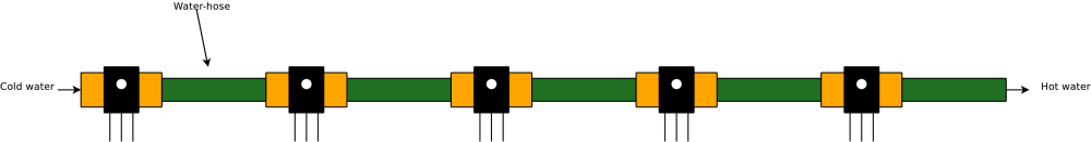

Ok, so my amp is the F4, not the Zen, but water cooling is what I'm interested in.
My question: does the water conduct enough voltage to become problematic between fets should I decide to not use mica isolators?
I will daisy-chain plastic tubing between fet cooling mounts--the mounts will be some type of brass plumbing fitting from Home Depot that accepts compression connectors.

Unless you got somewhere like a pond in the garden, a huge radiator or the like, where you can dump the heat.....the point of water cooling is moot. But you already knew that, didn't you?
The math behind cooling is fairly simple. You got X watts of energy, and you got Y surface area to loose that energy from, which results in Z temperaure rise per watt. All you have to add to this simple math, is the thermal resistance figures for the path from the device to the finns of the heatsink.
Now if you mount the devices in need of cooling directly on the heatsink, or you put a heat transfer system in between the device and the heatsink, makes only one difference, and that is the thermal resistance of the heat transfer system, that being water or just a plain lump of aluminum. So you actually need to ADD heatsink if you use water to transfer the heat from the device to the heatsink, in order to keep the device at the same temperature as if it was just bolted onto the heatsink.....bad business!
The reason to use watercooling in a computer, is the space constraints, you have no such when building an amplifier, so you can just bolt the devices directly onto the heatsink.
There are options that can lower the working temperature of the device, like a copper heatspreader, or even better, a carbon heatspreader, but we are talking details here, not something in an order of magnitude worth considering generally.

Hi Magura,
My primary concern is that voltage may carry through the water to the other fets if I don't use mica isolators.
For the sake of simplicity, I prefer not to use isolators; I'd rather physically separate--and isolate with plastic tubing--the water cooled fet mounts.
At low voltages, I'm inclined to think that voltage transference through water will be negligible; just wondered if anyone else had experimented with this concept.

carpenter said:My primary concern is that voltage may carry through the water to the other fets if I don't use mica isolators.
If you are using resaonably pure water, there should be no
problem. Sea water would probably conduct too much.

The water will become contaminated over time no matter what you do. However there is another solution that looks somewhat more attractive.
If you use oil you will largely be able to ignore the issue of conductivity of the coolant.

Is this carpenters idea?
How long does the orange joints need to be in order to transfer the energy to the water at a given velocity? And how about thermal tracking between the fets, wouldn't that be a lot better if they were all mounted on the same lump of iron?
I doubt waters thermal conductivity is sufficient for such a setup...

Distilled water (available at most drugstores) is completely non-conductive.
It also doesn't corrode copper.

Now all you need is to tell us what the actual difference is between a radiator and a heatsink when it comes to dissipating heat? 😉
Radiator= heatsink with liquid running through it....hence thermal resistance calc looks like this:
Thermal resistance from device to cooling block + thermal resistance from cooling block to liquid + thermal resistance from liquid to heatsink (radiator)......or you could just lay low and stick to thermal resistance from device to heatsink 😎
Magura 🙂
