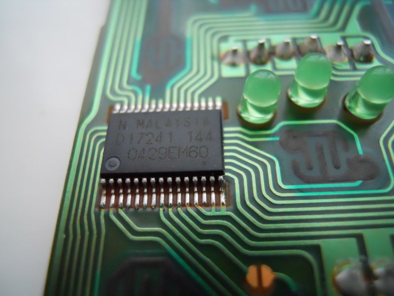

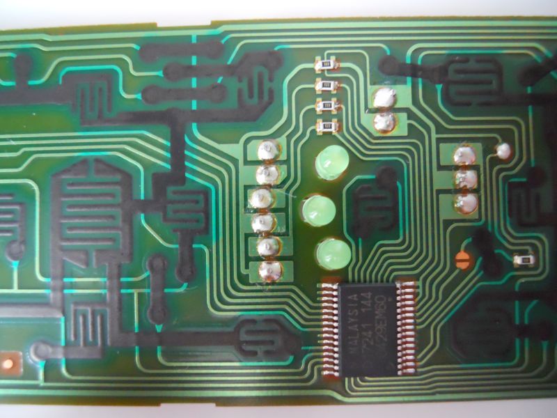

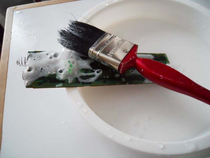

I actually had cause to wash a PCB today, OK so it was only a remote control but it was a good example.
Having rinsed the PCB I added a few drops of ordinary washing up liquid poured neat onto the PCB. Soft brush to clean both sides, rinse, shake, pat dry with a paper towel and dry on a radiator.

Yes, just ordinary dish washing liquid, and placed on top of an electric storage heater to dry.
Even the best cared for remotes can have a problem with the flexible neoprene keypad leaching a gooey sticky substance onto the PCB (plasticiser of some sort used in the manufacturing process). Some remotes are immune, for others it was an issue.
(and as a service tech I've washed off much worse than that from both remotes and large PCB's)

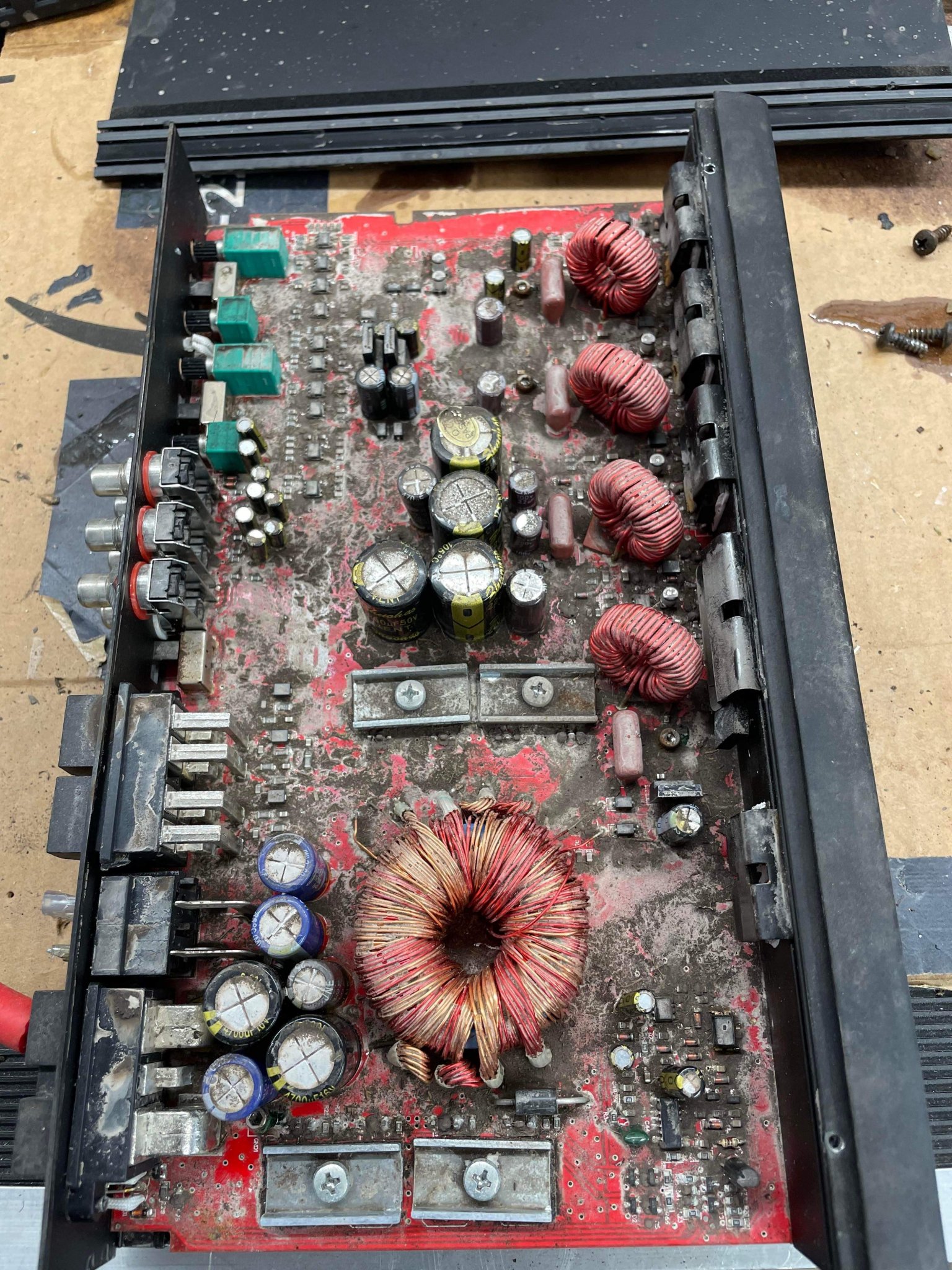

Someone sent me this photo just tonight. Died by mud flooding. When they come in like this it’s simple green/water to the rescue or straight to the parts bins. After water I use a hair drier and a fan. They come out pretty clean.
