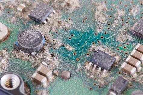

My "high-end" neighbor likes to bring me his new found treasures that require servicing.
It's not always a pleasant job of course.
And this one job I'm currently doing is the focus of this thread.
It concerns vintage equipment that has a known, dangerous, and deadly element known as Cadmuim.
It was used in many things as a plating on metal parts, and perhaps you've seen a white or yellowish powder on old equipment.
Chassis, speakers, and other components are all affected.
It MUST be CAREFULLY removed.
Cadmuim is as bad as Asbestos if you breathe it.
A mask, gloves, and eye protection is mandatory.
And it has to be done OUT-doors, carefully.
I won't go into the whole procedure, you can look it up for yourself.
This is a close-up photo of the 1964-ish Thorens TD 124 motor assembly on my bench that was seized-up but serviceable.
It's gonna be a messy job, most of the turntable's parts are also contaminated with the white powder too.

The white powder is cadmium oxide.
Here's its Hazardous Substance Fact Sheet for reference:

The other nasty substance that I've had to deal with is sometimes found in old vintage radios.I thought you were going to mention the dust comprising the human detritus of strangers (skin cells, strands of hair etc.) that one finds lying inside amplifiers and suchlike.
Nasty stuff to have to clean out, but, compared to cadmium dust, a minimal health hazard!
Asbestos!
They used it to insulate the cabinets from the heat of the tubes.
Sheets of it glued to the cabinet walls.

In some of those old vintage radio cabinets, I've removed the glued-on asbestos sheets per proper safety procedures, and the resulting cabinet area is then coated with paint or laquer to secure any possible bits embedded in the wood.Used to be in all sorts of things where, perhaps, you'd not expect to find it. WWII gasmasks for instance. Generally glued isn't safe to remove. But there's a big difference between asbestos (as wadding for insulation) and the asbestos cement that usually had <5% gray asbestos.
Times have changed a lot since Rawlplastic asbestos screw fixing compound...
This is to adhere to safety codes, protect the customer, as well as myself, and eliminate any future possibility of a liability case. - the same goes for any "uprading" modifications of the wiring.
The heat shielding now removed, is replaced with aluminum flashing, sometimes over a layer of fiberglass insulation and/or standoffs, and if possible, shaped or angled to give a convection airflow out of the cabinet to prevent any heat damage to the outer finish.
