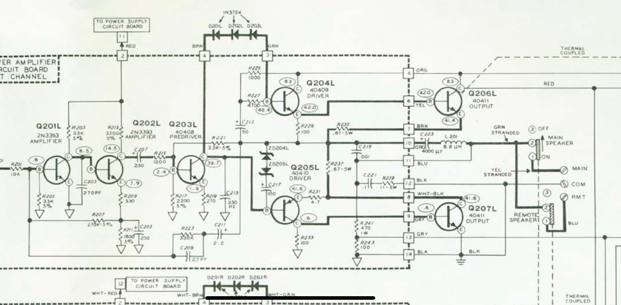

I’m fixing an older Heathkit AA-15 integrated amp for my father. It had many capacitors that were open, high esr, or highly reduced capacitance. Another major issue and the main reason I had it was that once channel had a pretty major failure. Nearly all of the transistors in the one channel were bad.
Original outputs were 40411 and are now MJ802G
Drivers were 40409 and 40410 and are now TTA004b and TTC004b
Predriver was 40408 and is now TTC004b
The two 2N3393 at the input of the amp are now 2N5551c
These were the closest replacements and were recommendations. With these changes the idle bias current is quite a bit higher than I’d like to see lol. Measuring across the 0.67 ohm emitter resistor I’m seeing close to 100 mV or just under 150 mA of current. Is it possible to put in a trimmers in order to bring that down a bit?

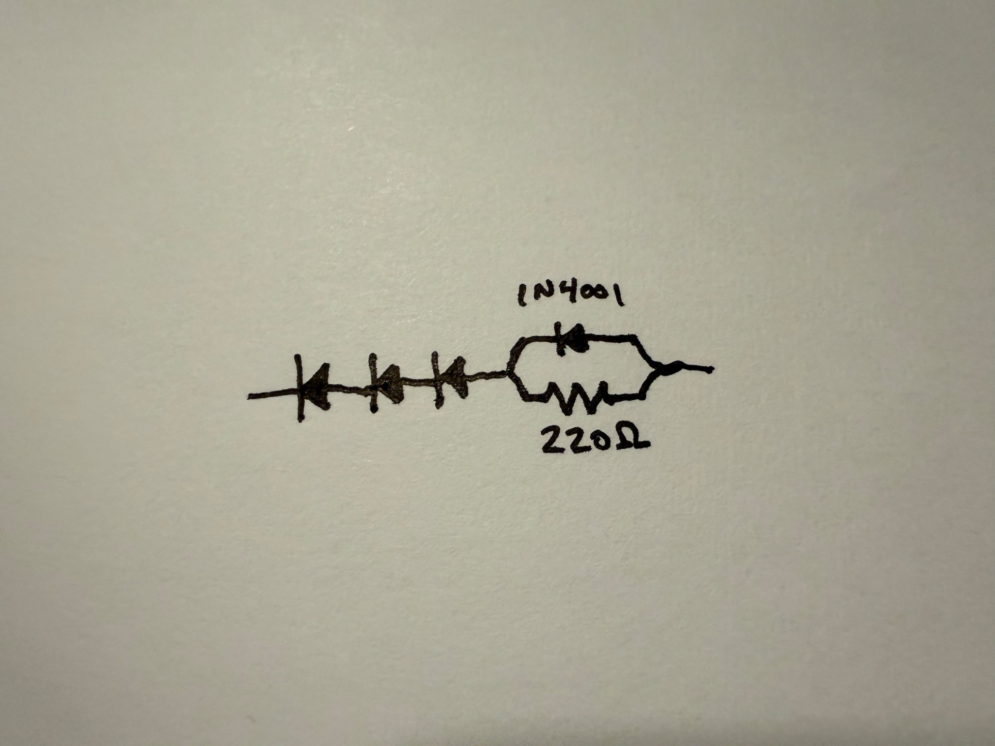

You'll probably have to redesign or replace the fixed bias circuit, which is D201, D202, D203.
Have you got crossover distortion? If you have add a 1n4001 with a 220R preset across it in series with the three bias diodes.

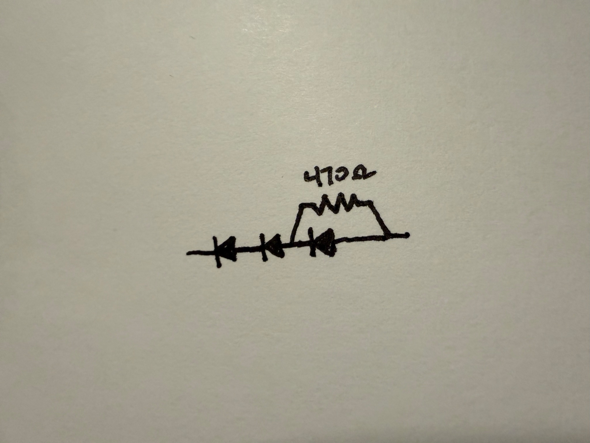

If you have too much quiescent current, place a 470R preset across one of the bias diodes.

MJ802? You like living dangerously? They don’t like 40V rails, despite the current and power ratings. MJ15003 is the “correct” part. It’s vbe is “too low” too, requiring the same bias adjustment.

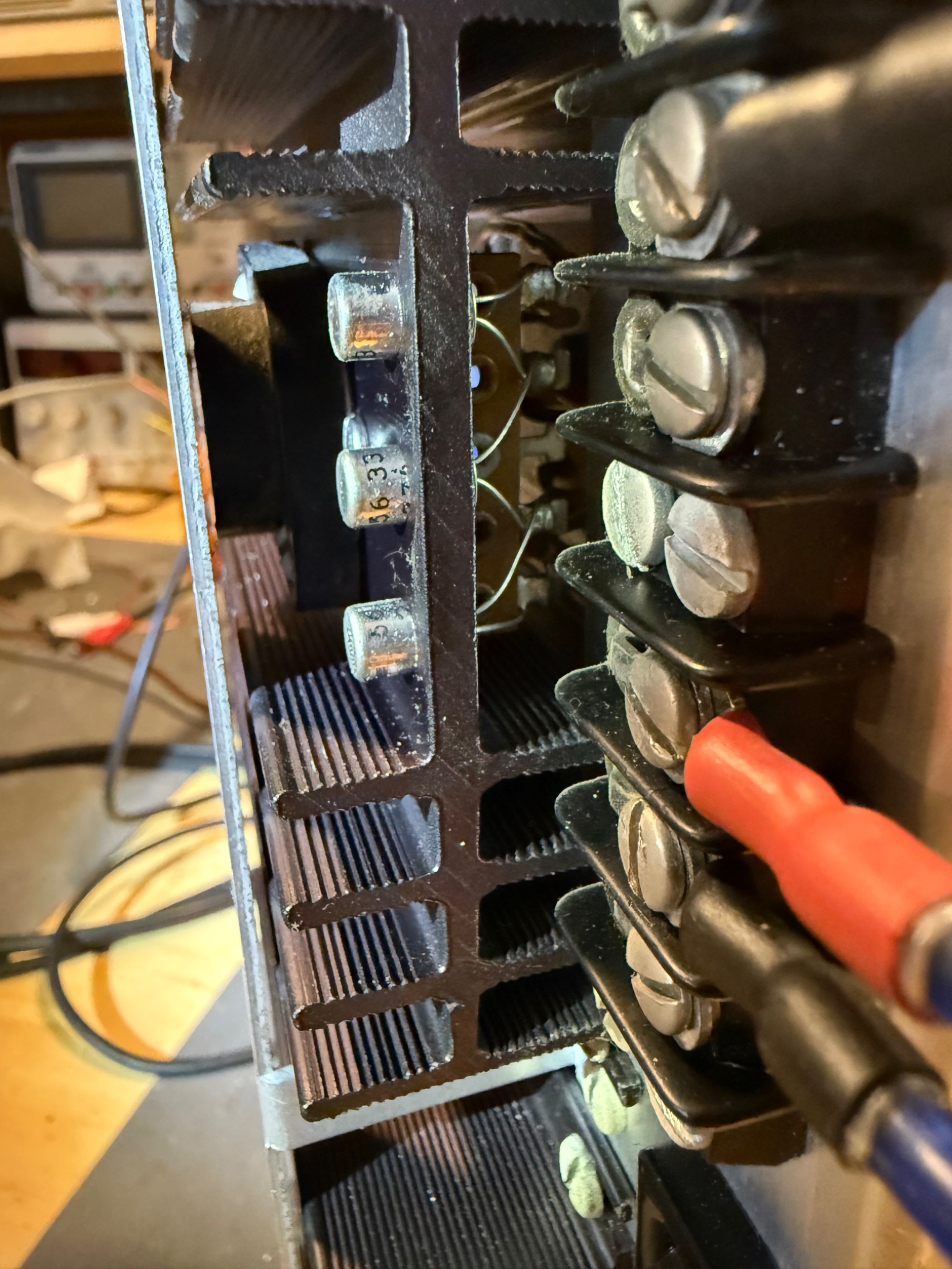

That would be a bummer, at least more difficult than adding a variable resistor. They currently use three metal can diodes mounted to the heatsink, going through holes.

So if there is crossover distortion I would want to do this? Does it matter which side of the three bias diodes it’s placed on?
If I have too much current then I’d want to do this? When you call the resistor a “preset” are you meaning a variable and setting it at that resistance to start off?
I would put a 1k potentiometer across one of the diodes d201 d202 d203. If that gets you down to 20 ma idle bias, clamp the pot with a schottky diode. Pot wipers are subject to the wiper losing contact due to oxidation. Or perhaps the schottky diode alone is close enough to give a fixed lower bias current.
Lol, this is why I love this place. I have plenty of MJ15003, I’ll place in a quad of them first and then tackle biasing.

Picture 1 is what jonsnell said, but If you have 150 ma of idle bias current there should be no crossover distortion.
Picture 2 is sort of what I said. I'd put a 1000 ohm pot at first, remote with a couple of wires, then set the voltage on the emitter resistors to 13 mv (20 ma), then depower and measure the pot value. Then put in a fixed resistor of that value. Or clamp the pot with a parallel schottky diode, which can be suitably tiny to fit right in between the two leads of one silicon diode. Say MBR1100 or BAT48 .
If you have a scope you can look at sine wave output for crossover distortion, but I do not expect any at 20 ma idle bias current.
Allen organ sold thousands of S100 amps with a pair of MJ802 as outputs, They were very reliable at +-35 v. This if I can read it, is +-46 v. A whole different ball game. MJ15003 or same price MJ21194. I would change the mica washers with new ones, or leaving out the heat sink grease, silicon pads. 50 year old mica washers are IMHO at expected life.

15003 has higher gain at 15A, a better match for the original hometaxial types. That’s why someone suggested MJ802 (high gain at 20A), but it’s SOA as you know isn’t good enough for the voltage.

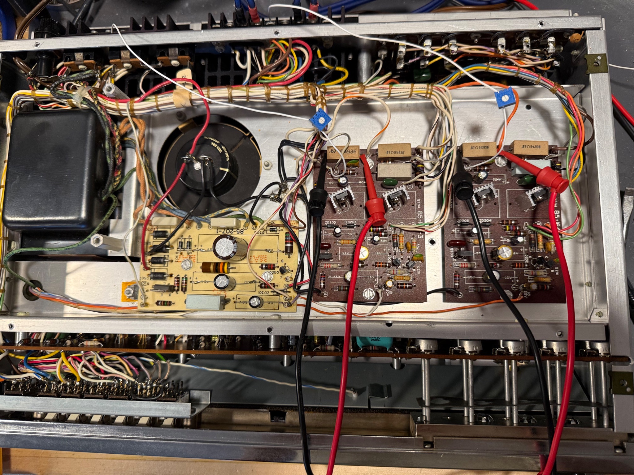

Well swapping over to the MJ15003G helped a bit all on its own. After swapping the bias voltage across one of the emitter resistors is sitting about 64 mV on one channel and about 70 mV on the other.
I will get the trimmers install installed and adjust for correct bias current. I will likely try to go for a fixed resistor once I measure the resistance. Appreciate everybody pointing out the MJ802 not being a good fit. And I did indeed mica insulator with a new one. I’ll report back.

Alrighty, so I put a 1k trimmer set for 470 ohm across D201 of each channel. It’s just a sloppy install as once I get the value I need I’ll take all of this out and put in a resistor and run the wiring appropriately.
Edit: I have found that the 1 kohm trimmer doesn’t really have much affect until you near the end, I meant about 850 ohms and I am close to the 13 mV target. Using these trimmers, I have in there it’s quite hard to get it dead on, so I’m going to be swapping in some 25 turn trimmers. Get a lot more accuracy.

Well measure the emiiter resistor idle voltage. 470 ohm is just a shot in the dark. 13-15 mv on R235 is 20-23 ma idle current.
Note R237 is in the collector of Q207, not the emitter. 40411 had some built in emitter resistance. Modern epitaxial transistors do not. I would put at least .51 ohms 5 W between Q207 emitter and negative rail. I did in my ST120 with NTE60s (green box MJ15003 I think), and got about 6 years out of it at up to 14 hours a day without a meltdown before a wire popped off and it started humming.

I did see that they’re not truly both emitter resistors and actually I’ve been measuring across the resistor that’s on the collector of the output. Does that matter? I went ahead and swapped over to the .67 ohm resistor that was on the emitter. Now that I’ve swapped over to the new trimmers, I went ahead and set them for 820 ohms. That’s going to get me a lot closer to the 13 mV target. I will check for crossover distortion at 13, but maybe I should just set it for 15? Anything over the minimum for eliminating crossover distortion is just going to be wasted extra heat, correct? Once you eliminate that crossover distortion that is where the idle current should be set, correct?

Well holy crap, dialing these in is definitely not linear. Even with these 25 turn pots 1/10 of a full turn will take it from 20 mV to 10 mV. It is very touchy. The smallest amount of resistance will change the bias fairly dramatically. I don’t think substituting in a resistor will work very well. Let’s say I get the trimmer to 940 ohms, if I were to put in a 910 or 1k that difference will make a large difference in bias current. Really, I am quite shocked by how touchy this is on a 25 turn trimmer.

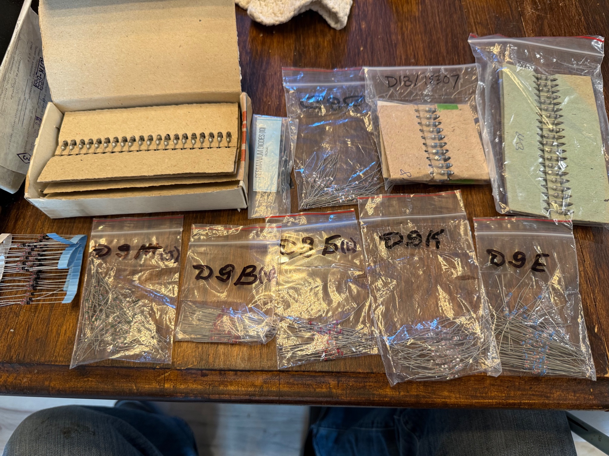

Out of curiosity, how would a germanium do here? I have quite a large collection of different germaniums. I’m just asking about them as they have a lower forward voltage like schottky vs the silicon. I have no idea if they would work, which is why I’m asking. I grabbed several of the Russian options from a seller in Ukraine. I also have some of the American options like 1N34A
Edit: I forgot to ask, after I set the schottky diode across the trimmer it would be wise to set bias again? How much affect will that have on the bias current?
