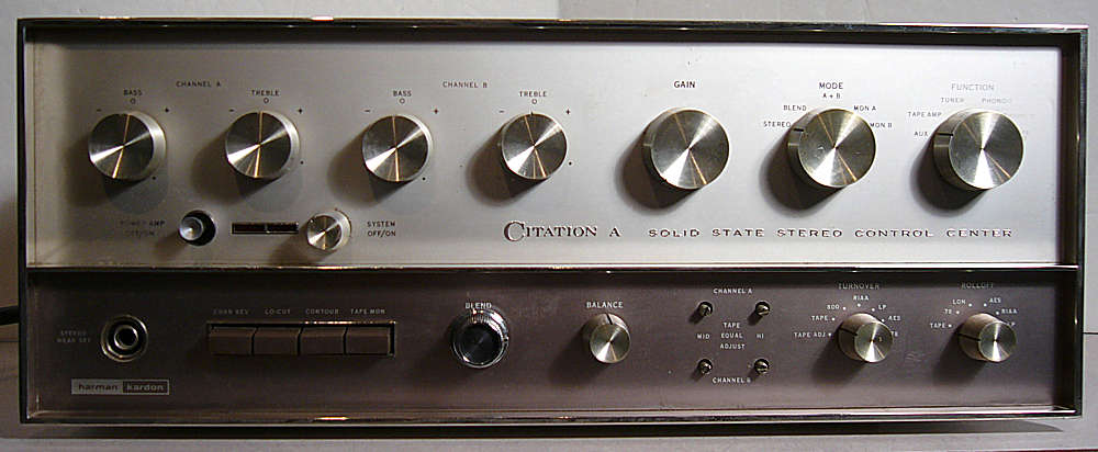

The associated pre amp "Citation A" you will find about Ebay Item number: 250653508448

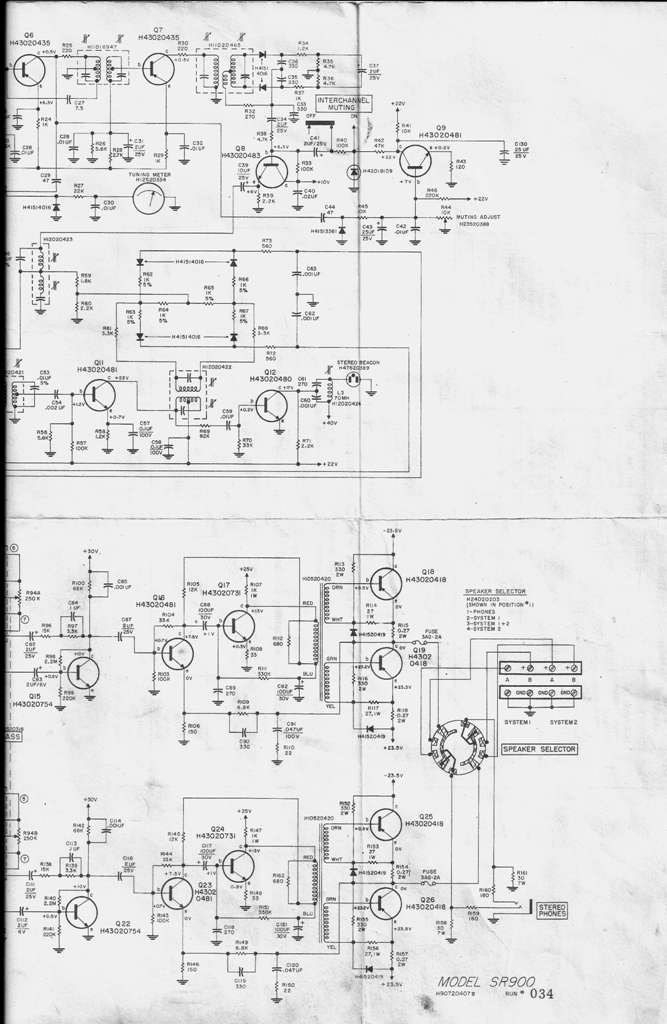

If this can help, I'm posting the schematics of a nice sounding Harman Kardon receiver of the same year, the SR 900.
I can send better definition files by email.
Dear Orit-
I am trying to repair a HK SB900 with a blown channel and am in need of a copy of the schematic. The one on this post is too small and blurry to follow. Could you please e mail a copy to stevecutler@verizon.net. Thank you. Also the question on the output transistor is that they are selenium PNP and the closet modern equiv. is NTE 104. You cannot use a silicon variety since the gain (hfe) is too small-you will need a gain of at least 70 hfe since there are no other drivers in this stage unlike silicon amps which use many gain stages of low (20-30) hfe. The outputs are driven by a push/pull pair of PNP/NPN germanium drivers. Surprisingly these were not damaged and the output fuse is still good. The main fuse was blown. Most likely when the outputs short the emitter resistors .27 ohm one watt are also blown. They are not flameproof and should be replaced with flameproof resistors. I was able to get one channel on the unit to play well and it has a strange funky sound reminiscent of early transistor radios. It is hi fi but the distortion level is quite high by modern standards (.25 THD) for solid state units due to the selenium devices. It sounds like a high quality car radio of the era. The tuner section is good for an early unit with good reception and selectivity. Also the MPX of the tuner works well with an adjusment in the rear for stereo capture. This HK is quite a nice unit considering how primative it is.

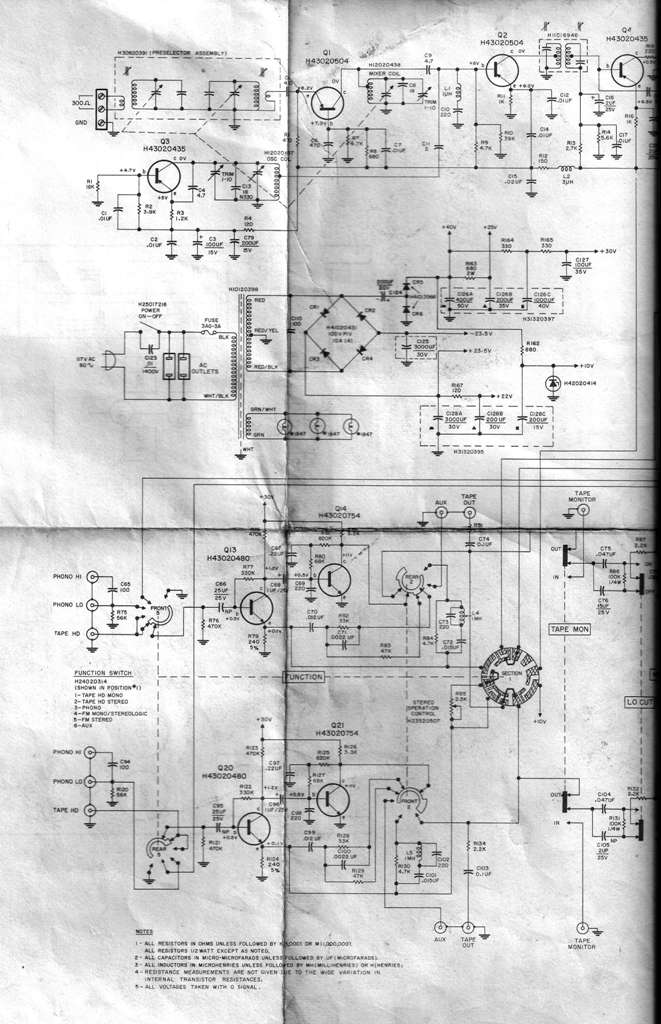

I have a working Citation A and a working B. It had been serviced before I bought it (20+ years ago). The repaired channel has 2n3055 output devices. These are silicon devices. The transistors on the PC board are encased in screw apart heat sinks. I brought it here today to variac it up and it still works. The original output transistors, even though branded westinghouse look like early Pacific devices. I would also recommend checking all of the electrolytic capacitors for high ESR. Mine has had one replaced but I think I may change some due to age. I don't have a schematic on this piece but I do have one on the A. The most curious thing I find about the B is the individual bias (idle) controls for the output stage. I would also recommend an easy load as this amp does not strike me as extremely stable. It does sound better than most solid state amplifiers of that era.
Scanning the A schematic may be a problem as it is large. It is also a very complicated piece.

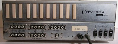

No connection to sellers, hope you find interesting to see:
Citation A preamp:
Vintage Harmon Kardon Citation A preamp stereo control center | eBay
Citation B power amp:
Vintage HARMON KARDON CITATION B STEREO AMP.NR | eBay
Enjoy!
Citation A preamp:
Enjoy!
Thank you very much for the schematic.
