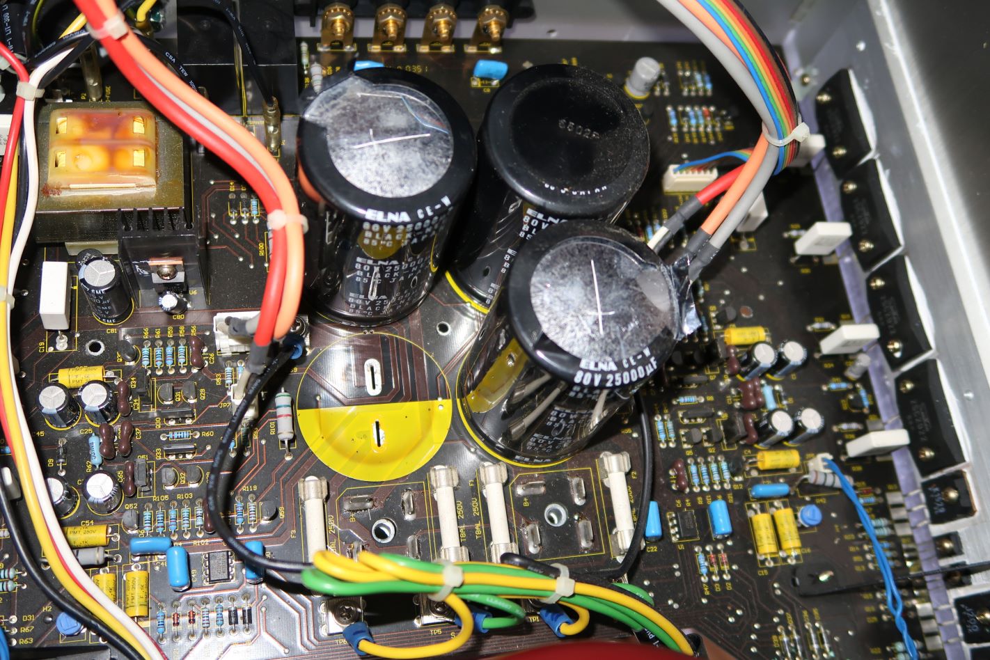

I'm after a supplier for 4 off the following.
Electrolytic caps.
~25,000uF 100v
Termination can be; Pin, Snap in, Tag. Not screw.
Pitch of 10mm to 28mm
Normal two pin. Not multi pin. (double sided board with tracks under the cap)
Maximum diameter of 53mm
Hight up to 140mm
I've tried; rs, e14, digikey, mouser, dalbani, hifi collective.
Any other suggestions or links appreciated.

The original is 25,000uf 80v.
But they run right on 80v.
If (when) the mains goes up obviously they'll be over stressed.
So I'd really prefer to replace them with a higher voltage.
But it looks like I'm trying to find unicorn tears.
I don't want to go to screw terminals as that means a whole lot of lateral thinking to make them fit.
But I may be forced down that road yet.

The caps in question are ps filter caps in an amplifier.
The owner (a friend) asked me to investigate several faults.
When I opened it up I saw the caps bulging. (Not the main issue, but still need to be fixed in my opinion)
He and I are a bit ocd so I need to replace them for my own sanity 😉

Pic is worth a thousand words as they say 🙂
Yes the originals are the old school solder tags that I remember from the 70's
Yet, these have the vent on the other side of the cap facing away from the terminals.
The board is double sided plate through.
The cap 'slots' on the board will take 11mm - 29mm pin spacing.
So with a tiny nick in one end of the board I can fit in the modern 10mm snap in.

Right so the best looking option I can find is this one.
https://www.digikey.com/product-det...cs-cde/382LX273M100B102VS/338-1991-ND/2256599
Cornell dubilier. 27,000uf 100v 85degree.
Sadly it has extra pins. But I can sort that out.
Does anyone have anything good or bad to say about CD as a brand ?

Update for anyone thats interested 🙂
I used cornel dubiler 27,000uf 100v 85 degree from digikey.
Seem to work. Glad I went for 100v not the original 80v as the supply rails are right on 80v.
There a 5 pin unit, so I cut of the three unwanted pins.
Made an insulating shim from 1mm blank fiberglass to go between the cap and the pcb,
Used a smear of neutral clue silicon between cap and shim, and shim to pcb.
Did this to provide arc over insulation and provide stability.
At 80vdc im not expecting any sort of arc over risk.
But I'm a bit ocd about things like this 🙂
