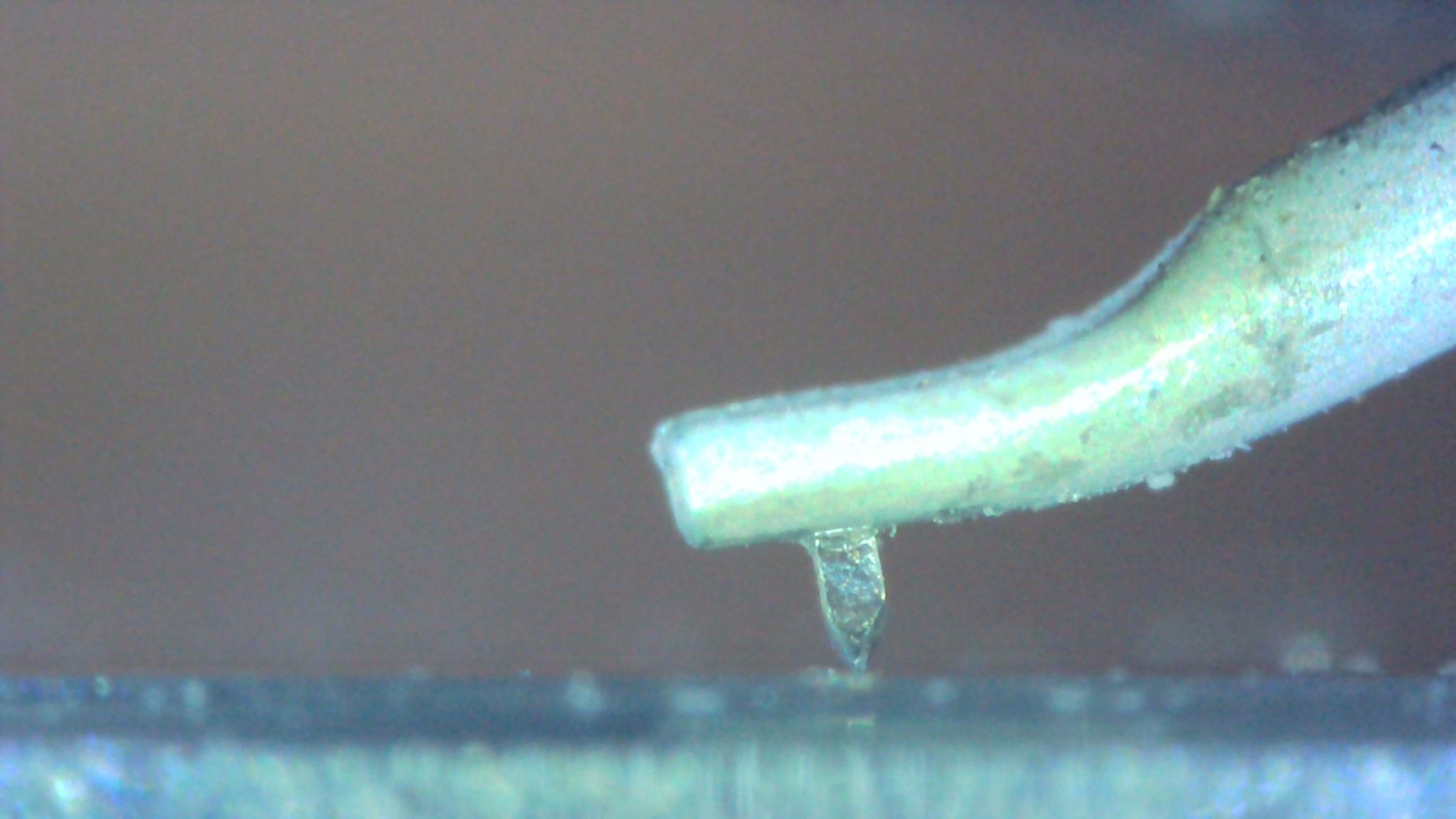

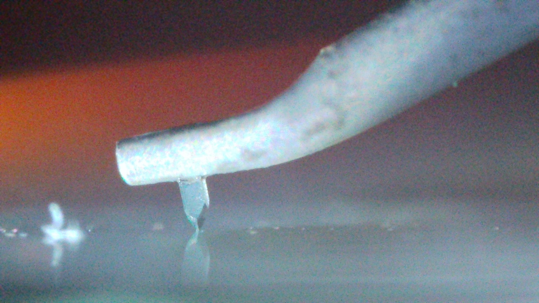

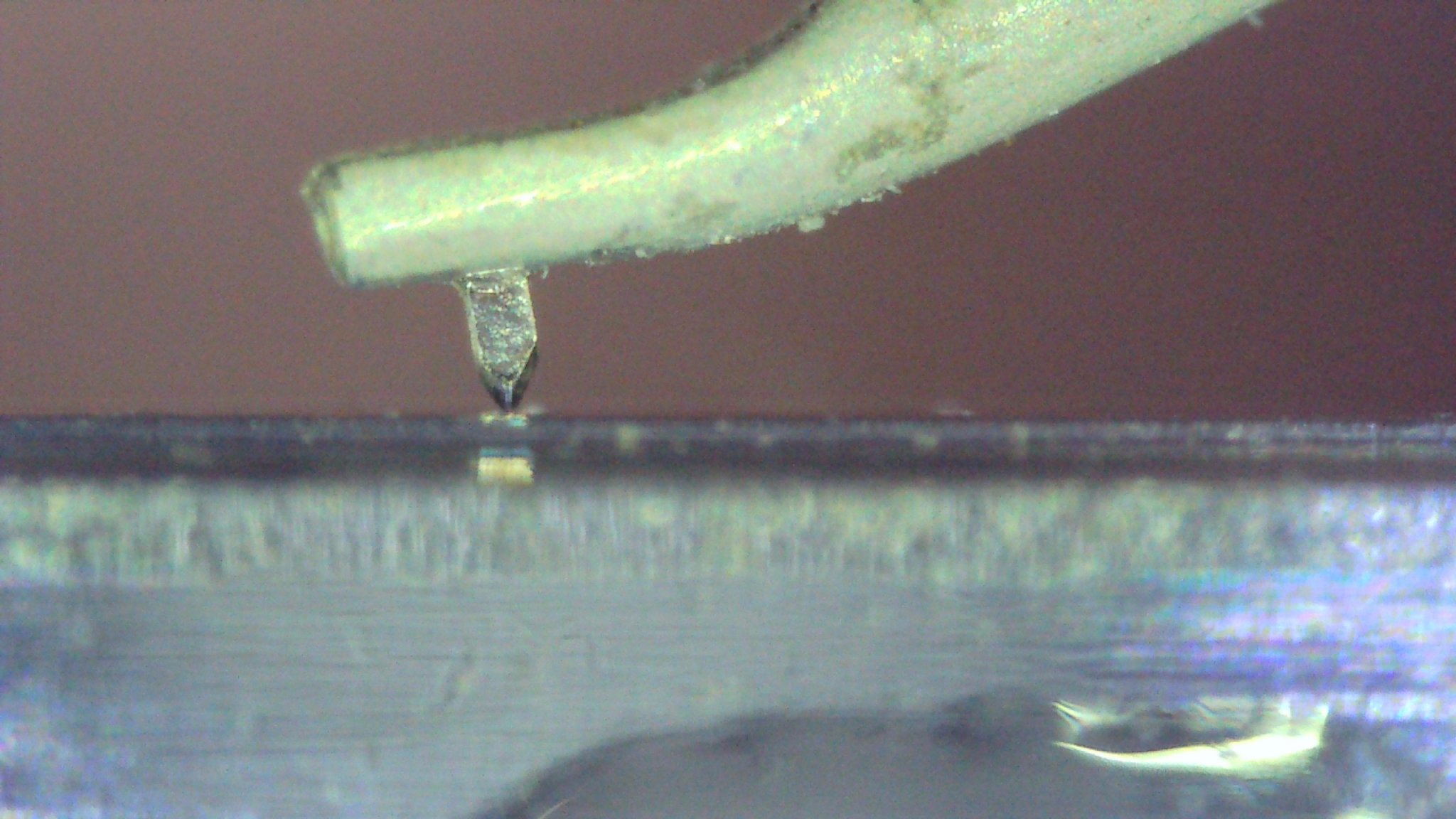

I've got a VTA adjuster on my RB300, and also the Origin Live cartridge enabler so I can set azimuth somewhat. I do have a USB microscope that I used to take some okay close-ups of the stylus, but I need to spend a bit more time getting the lighting right to make the contact edge more visible to measure. The images I've attached weren't taken with the microscope perfectly adjacent to the shank so won't be great for measuring anything. Have you been successful in measuring SRA with a microscope by any chance?
edit: please note these images will all have different vta/sra as I did some with/without a mat and also different tonearm heights.
Digital USB scope is the best way to check SRA for us mere mortals. The angle of the cantilever looks really close to 20°. There are also online protractors you can use to dial in.
Hi, Glad you got it sorted out, of your 4 photos No 3 is the correct alignment. I also use Conrad's alignment chart but always use "B" as I play mostly classical LP, which tend not to be as full as Rock etc.

- mkane, the problem with the HAN is that they have fitted 3 totally different styli to one cantilever type, so the 20 deg rule will only be OK for one of them, but which one, nobody knows.
