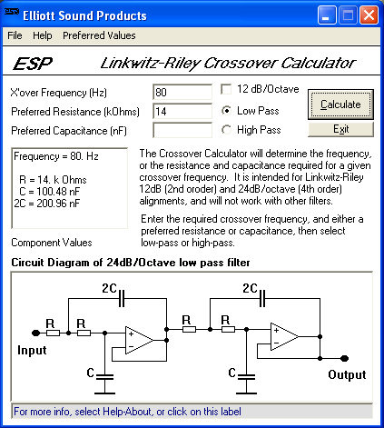

Wanted: Simple 80Hz Linkwitz-Riley 24hz/octive ready to print, etch, and construct low pass filter PCB. After a few months of searching ‘The Google‘, I can‘t find any such thing, and even though I am electrically illiterate, I think that I am ready to try my hand at printing-out a PSB board and soldering it up if that is all I have to accomplish and if anyone knows of such a thing and will hold my hand while I attempt this new endeavor. 🙂
I own four sets of home stereos based on PA speakers (2 Altecs, 1 PV, and 1 EV) and all of them sound great, but are crying out for subs. It might just be cheaper to purchase four Crown XLS 1000 Drivecore amps with built in low pass filters, but I need and would at least like to try building one.

You can build the filter for 80Hz break frequency using 14k resistors and 100nF capacitors:

Thanks Dr EM, I have been reading Elliott Sound Products web page a few times, but it's been confusing and over my head. I see that you picked the resistor first although ESP says to pick the capasitor first, and how did you know which value to pick?
Pick the cap first. They come in fewer values.
If you can measure the cap to better than tolerance, use the measured value.
Resistors can be adjusted by series and parallel additions.
The example has 14k and ~100nF, try 150nF and then your resistor ~10k. Even lower (5k to 7k) will have less noise.
It actually is more practical to pick capacitor first, since there are fewer values available. Resistor values should be between about 1k-30k, too low and the op-amp gets loaded down, too high and noise increases (not too big a deal with 80Hz break LPF mind!).
Capacitor value doesn't strictly matter so much but you should select a resistor large enough to afford use of a commonly available film type capacitor, since electrolytic types do not have close enough tolerances to produce an accurate filter without matching.
The values of 14k and 100nF should work well and even a TL071/072/074 op-amp will have no problems with loading here 🙂
