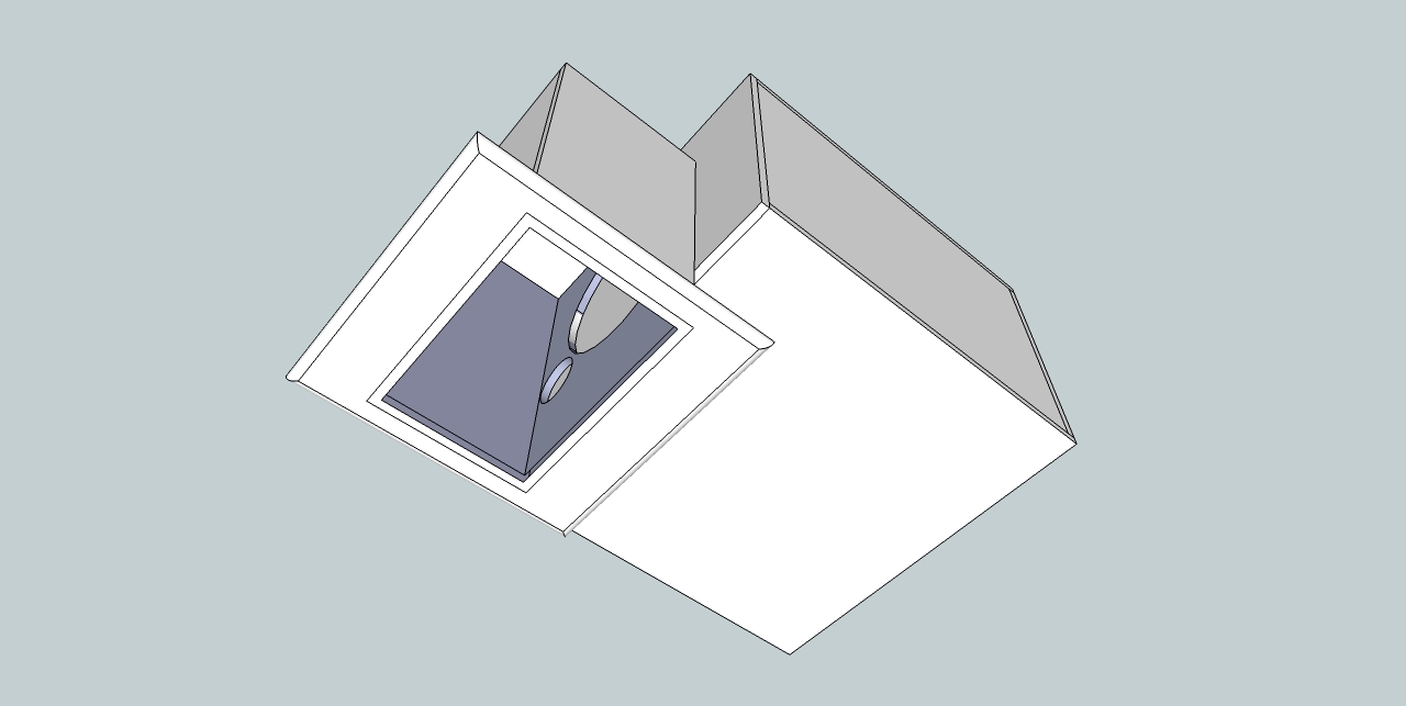

IB systems work well for home theater but they have drawbacks. Unless your attic is sealed (it isn't) everyone near your home will know you're watching a movie. If you want an attic sub I'd use two rss390hf-4 in two 12ft^3 ported boxes (one driver per box) directly above the L/R mains in a recessed slot using 500w, HP at 14Hz. Port tuned to ~14Hz (6"dia x 27"L with flairs) (for info on slot loaded drivers check out http://www.diyaudio.com/forums/subwoofers/177905-thread-those-interested-ppsl-enclosures.html )

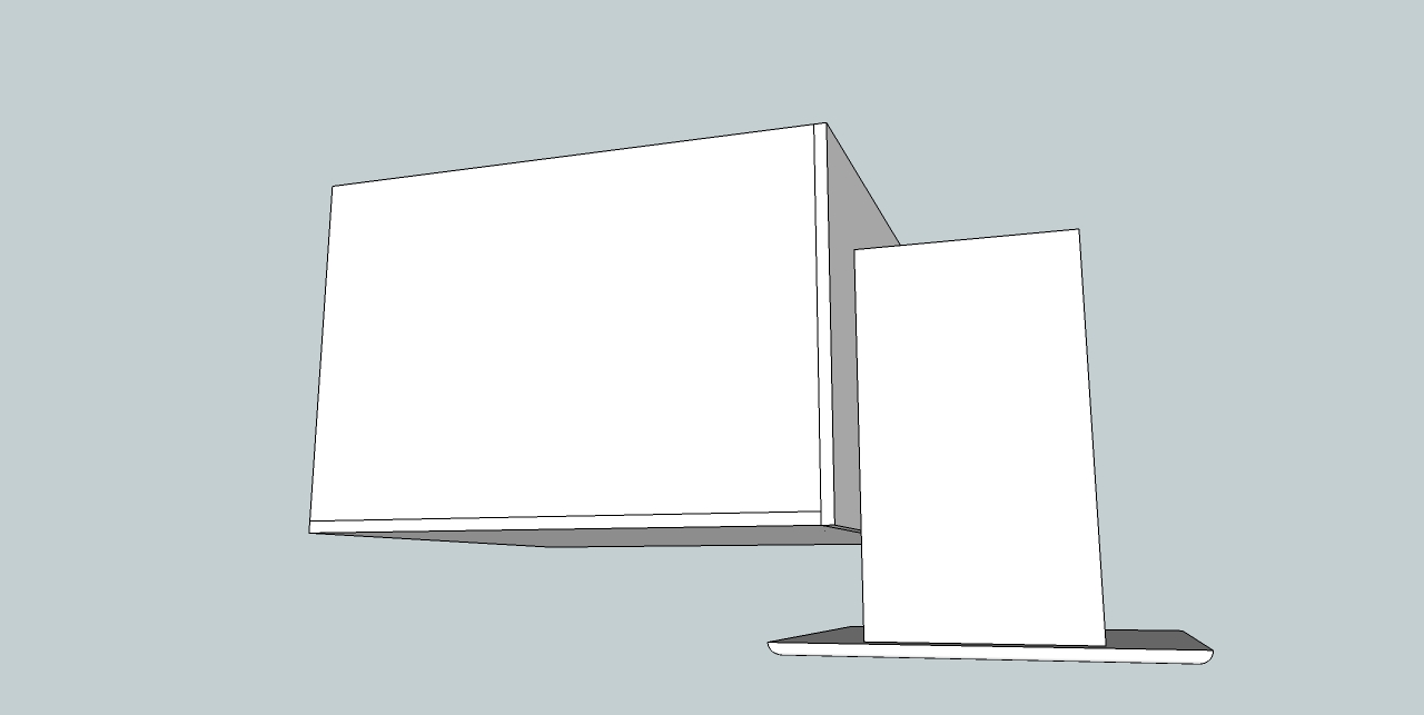

When building a speaker into the ceiling, I tend to build a baffle about 24" x24" of baltic birch to mount the driver or driver slot to then the box gets built into the attic.
