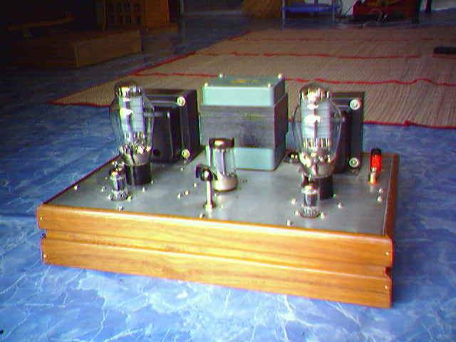

That is a nice lookiing amp 🙂
I'll hazard a guess and say - SE 2A3?

no! ti is 300b .. i love triod. i think tetrodes is not goog as triod

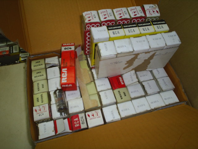

Whoa! It looks like you have about seventy 6C4s there, and I can see some other valves which I can't quite make out in the box at the top left of the picture.
Dave is right - the 6C4 is essentially half a 12AU7/ECC82/etc...
Why not try making a massively paralleled amp - maybe something along the lines of the Tim's Hept'AU7 <- why isn't this link working?

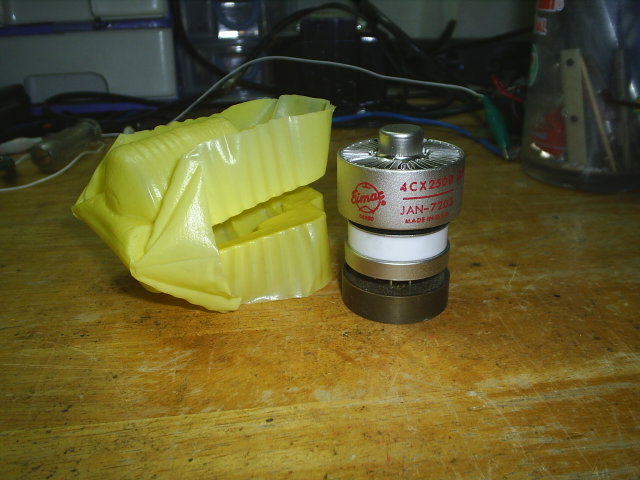

day said:this is my RCA8121 it look nice . today i saw new tube 6C4 . IT can be preamplier and how dose it sound.

That is a 4CX250B
4 elements... 4CX----
CX = ceramic & metal
250watts of plate dissipation.
Useful for class C RF or Class AB modulator service.
Very high voltage ~2kv and up.
Not a very good audio tube, but usable in a stable circuit.
Eimac and RCA showed some applications as modulators.
High plate impedance makes it tough though.
FORCED AIR COOLING (noise)
NOT a preamplifier tube!!
Nice tube for RF, a pair will do ~1kW PEP as a linear - the tube is useful up into the VHF spectrum.
Again, sell or trade to a licensed ham radio operator! 😀
