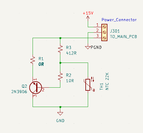

Also there is a thermistor circuit on the power supply PCB which is connected through the pin 3 of connector J301 to the base of transistors Q304 , Q306 and Q307, what is the purpose of this circuitry? , is it for protection or for automatic gain adjustment in the NJM13700 OTAs (Operational Transconductance Amplifiers)..?
