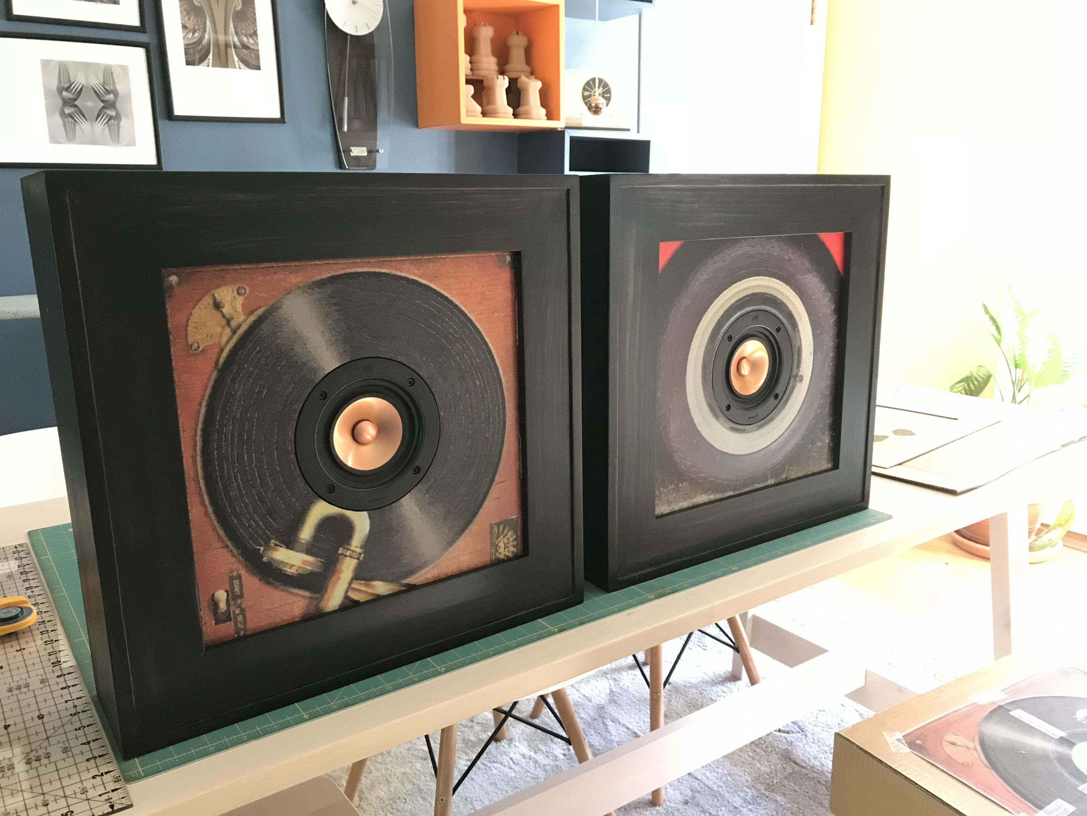

Beautiful example by bentspoon1:
Super example by theaspin:

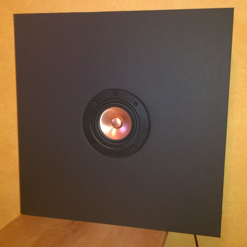

My foamcore example:
Super setup by IanLenco:
So you could say it’s a pretty well tested and liked design.
