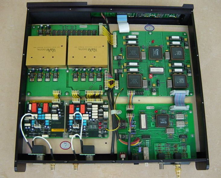

Hey guys, anyone know anything about these are they any good, cost new, vintage, what dac chip/s, outputstage etc etc. There's not much info for me on the net, love to see a circuit diagram on them if anyone has one.

wadia was the granddaddy of high end digital for a while there. the 64 is an older unit. not sure how it would compare to the newer stuff.

That's a start, thanks for that, I did just find out that the were 1300000yn in Japan when new, that's about $13,000.00!!!!!!!
Has anyone any ideas what dac chip was used? for that price I'd expect and want discrete, or at least something very special.
I think I can remember they may have had an output stage, that they called the Sledgehammer what ever that meant? then it could have been another US company.

the sledgehammer output stage was a Wadia deal. they got slammed in some early reviews due to a weak output stage so they beefed it up. I am not an Wadia expert but i do love there products!

There is another sub section/layer under the whitish board that houses a massive power supply, transformers ect, also.

Basically the output stage and DAC's are not really a special thing in these Wadia players. Shurely they are well designed, but the real secret of these players is the software (or (re)programmable FCPGA or DSP).
The interpolation algorithms are what makes a Wadia player different from others. Basically they use a 11th (or 12th) order polynomial function to generate the extra samples for oversampling.
And maybe the fact that the analog filter (because of the previous stages) is very simple and not castrating.

Probably. Wadia are first DAC with NOS DAC sound. Except it interpolate to 32x or 64X.renaudagnes said:So you think the really true secret of these ooold Wadia is the algorithm ?

Wadia X32 uses Digimaster filter software, so yes, true Wadia but lower in food chain then X64.
The one Wadia that is not, ie, no Digimaster software IIRC is the later baby DAC, Wadia 12 .

"French Curve" was the original name for the Digimaster software. They used that name for only a very short time.
Both are based off the exact same idea. Using Lagrangian curve fitting (thus the name "french curve") as the first part of their re-sampling process.
There was one minor difference though. The "French Curve" was a 12th order algorithm while the later Digimaster was an 11th. But functionally and audibly they are the same.
The first intent was to allow end users who were familiar with computer programming to write their own digital filters and write them to replaceable eeproms on the dsp board. They quickly abandoned that idea and named their own algorithm as "Digimaster" with the intent of licensing it to other DAC manufacturers. That also pretty much failed. The company went bankrupt for the first time, the original owners/designers moved on, and the torch was picked up by a new set of engineers who ran with the Digimaster idea keeping it fundamentally unchanged since that time.
