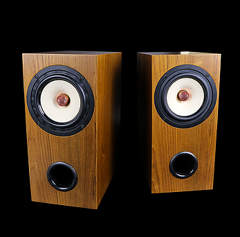

We are delighted to announce the W5-FR-SP. This unique loudspeaker stands out from its competition by proving itself more than capable of full range output from an extremely compact form — a feat which most bulky full range speakers struggle to achieve.
The W5-FR-SP is capable of delivering high-quality sound without the need for an extra crossover circuit and does so with high efficiency (sensitivity: 88 dB). These bookshelf-sized speakers readily pair with any amplifier. Aesthetically, they blend seamlessly and beautifully into any interior design.
Unlike most other Full Ranger designs on the market, which leverage ‘back loaded horn’ cabinet designs to enhance bass — often resulting in a big, heavy, tall-stand enclosures, Enigma Lab created a ‘vented box’ design, using front-venting apertures to enhance bass output. This was the highly successful result of a great deal of effort and extensive lab time devoted to establishing a completely different approach to loudspeaker design.

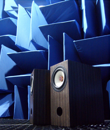

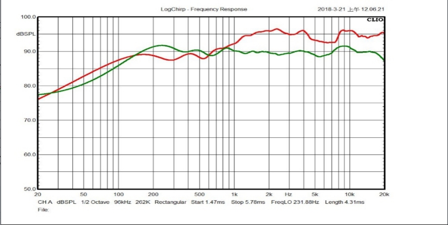

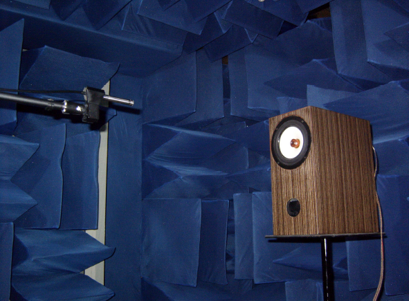

The beautifully smooth frequency response results tested with CLIO and DASS systems are highly satisfactory: Only 1 dB of deviation across the majority of the frequency bands, which is exactly how Hi-Fi Speakers should be.

Attachment is our frequency response of W5-FR-SP. Green lines shows W5-FR-SP, and the red one is actually the earlier design of full range loudspeakers. Actually W5-FR-SP is the second version of the design.
