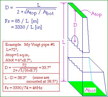

I'm definately not the best person to answer your questions, not calculate your box for you, but I can hopefully help point you in the right direction. Also if I understand the voigt pipe, look that up. If that is right, what you have designed is a folded voigt pipe essentially. Below should help to design a voigt pipe.
Good Luck,
Josh

Bob's site: he has some excellent articles there that will help you understand the design proceedure with Martin's mathCad worksheets.
http://www.geocities.com/rbrines1/
The Worksheets are actually easy to use -Martin's done all the math for you. You just need the T/S parameters and to specify the dimensions.
So = the top (sealed end) of the line.
Sm = the far (or end with an opening of the line).
Mass loading means the end of the line is constricted, with a port -the air mass provides additional loading to the quarter waves the cabinet is designed to utilise.
The rest is fairly self-explanitory -driver positioning, stuffing desnsity etc. With a bipolar setup, Sd (the driver surface area)doubles, Vas doubles, impedence halves (if they're wired in parallel).
As for what's there at present, the basic geometry is fine, but for the love of heaven, don't use So=0 (i.e. don't bring the top, sealed bit of the line) to a point. Except in very specific circumstances, this is A Bad Idea. I've actually already posted the dimensions for an unfolded bipolar pipe using these drivers a couple of days ago -see my last post here:
