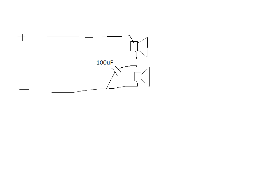

I figured that a single 881 in a sealed box would suck for a center. How about two of them in a ported box?
Attached is a little diagram to make myself more clear. I realized after you might not know what cap shading is. Just strap that 100uF cap to the terminals of one of the drivers. The drivers MUST be in series for this to work or you'll short the system and have no high frequencies (and possibly damage your amp).

You would be correct tuxedocivic, no idea what capacitor shading is. Nothing came up on a google search either, is there another name for that? Would like to learn a bit more about what I'm doing.
Would that still be for a sealed box? Two drivers, double the volume of the enclosure?

Edit to add that your diagram makes it perfectly clear, just wanted to read a bit on the subject.
It's not a common technique. Most people parallel the drivers and use an inductor in front of the second woofer and call that the 0.5 woofer. Problem is though it presents a 4ohm load and causes 6db of added output below the 0.5 cut off (usually around 3 or 400hz). This little driver actually doesn't need that compensation. I measured mine to be quite flat, even in a very small enclosure. The inductor is also very expensive, as much as the driver in this case. So a cap shade is a better way to go imo.
Normally though, a 0.5 woofer is probably better if a $10 inductor isn't a big deal, a robust amp that can handle 4 ohms, and the need for upper bass lower midrange boost.
I'm not sure where you can find information on this technique. Like I said, it's so rarely used... Maybe try and good "baffle step compensation capacitor" or something.
