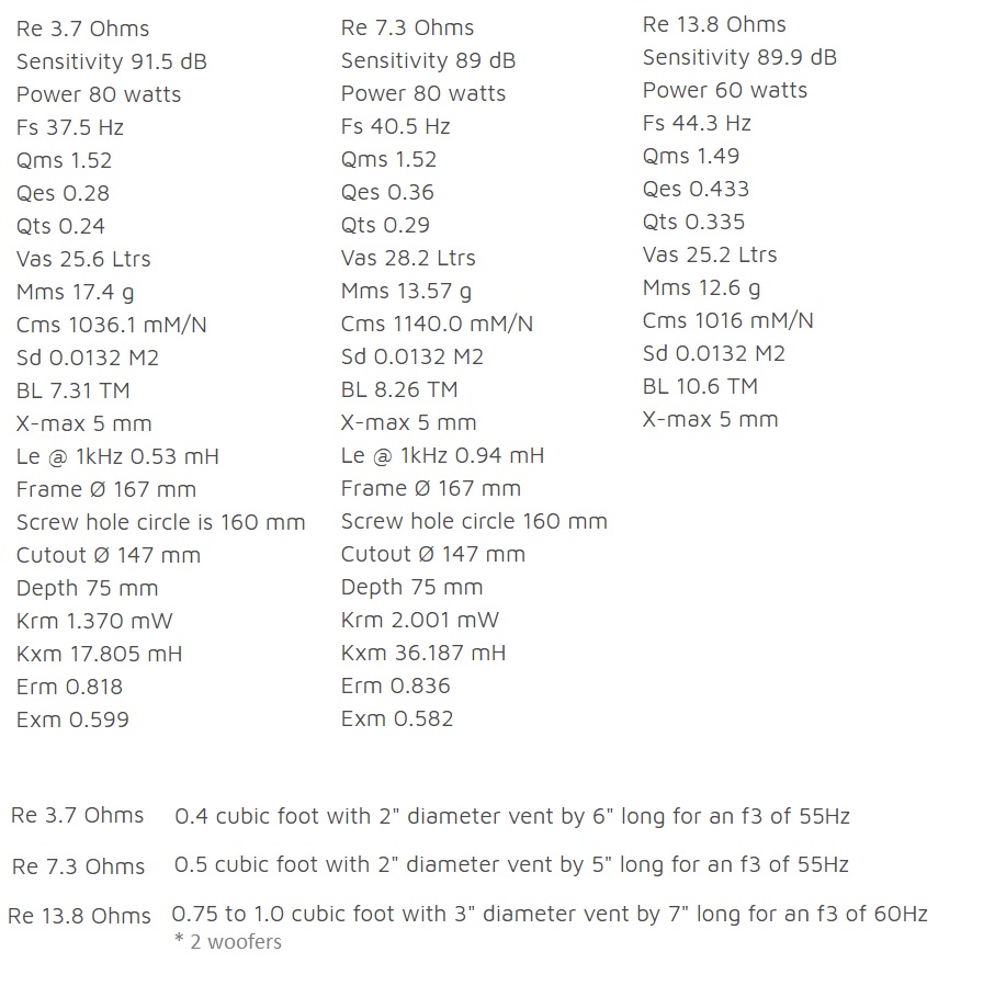

I don't see a response graph on the MS website, although they have some suggested alignments, 2 woofer and a 4 woofer box.
Silver Flute W17RC38-16 6.5" Woofer Wool Cone - 16 ohm

What makes you think the response will be different? The W17RC38-04 and W17RC38-08 responses are basically identical - within manufacturing and measurement repeatability.
The W17RC38-16 does not appear to be any different except for a 16ohm coil (half the wire gauge, twice the number of windings). Of course, i'm happy to be proven wrong on this assumption.
