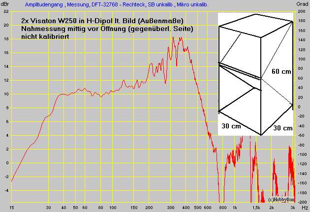

For the Phoenix W-baffle Linkwitz reports very different cavity resonances (190/270 Hz) for two different drivers (Peerless XLS 12 / Madisound 1252 DVC) in the same baffle. So I believe there is no really easy way to predict it.Can the cavity resonance be predicted?

Certainly I get it now. And no - rounding the enclosure edge will have no benefit. The length of a 100 Hz wave is 3.14 m, so it doesn´t "see" such a small extension. This is even more true for any edges inside. Rounding them off is only for aesthetical reasons.
A W-frame like yours will have a quarter wave resonance almost at lambda/4 = depth of W. A H-frame would have its resonance at double that frequency. So you will be pushed hard to get that W-frame up to 250 Hz. Have a look at mine:
http://www.diyaudio.com/forums/attachment.php?s=&postid=1013862&stamp=1159221400
And this is the nearfield frequency response:

So rounding off the edge is only good in baffle or box with HF operating range, for dispertion right ?
Then i can see from your drawing that you are using it with the 2 drivers on top of each other?
is that a good way to use it ?
then from your graph, ur system doesn't go down as soon as i would've thought ..
still going strong past 300hz nah ?
i am not sure i understand how to measure the wavelength effective for the enclosure of the H and W

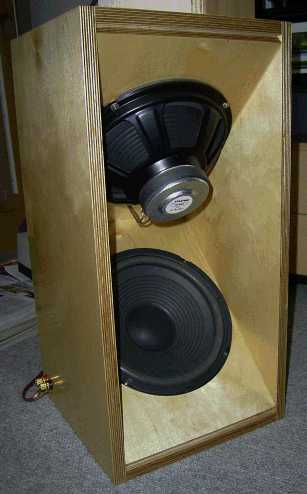

I have two 18 inch drivers (Ascendent Audio Avalanche drivers)in "W" baffle (phoenix style with one driver mounted in line with the other, not offset at 90 degrees like your diagram shows) and two 15 inch drivers on "U" baffles (mounted on the same baffle as the midrange drivers which in my case are Lowther DX4s).
The commenters are right that the W baffles tend toward resonances (mounting them at angles that you show would help to increase the frequency that the resonances occur). When I low pass them at 100 hz with a 24 db/octave filter, I avoid most (all?) of these resonances. But I tried one configuration where I crossed them over using a 12 db/octave filter at 250 hz and these resonances were clearly audible.
I don't know that the U baffles had similar resonances, but certainly they were less than the W baffles at the frequencies that they occurred.
I had significant problems with the U baffles shaking significantly, despite the bracing I was using (they are made out of 3/4 inch conventional plywood) when they were the sole drivers I was using. When I construct a final baffle and if I continue to mount thes 15 inch drivers in this fashion, I will at least double and maybe triple up the thickness of 3/4 inch material that I use for this baffle. This is one of the reasons I why picked up the pair of 18 inch drivers and mounted them in the separate boxes.
The W baffle is constructed out of 13 ply birch plywood. The baffles that the drivers are mounted on are 1 1/2 inch thick while all other faces are 3/4 inch ply. This thing is about 21 inches high, 24 inches deep and 40 inches wide (I suppose I could have made it narrower, but I did not want to increase the Q, I was hoping to avoid resonances, and I wanted to create a TV stand out of it). Playing very dynamic CDs (i.e., drums), any lighweight items sitting on the box can shake off it which demonstrates that the panels can still vibrate despite the cancellation benefits it enjoys. It weighs 160 pounds (80 pounds for the box and 80 pounds for the drivers). If I keep it for the long term, I will double up on all the 3/4 inch panels which will reduce its vibrations significantly.
I am planning to make a rectangular box that I will bolt onto the back side which has the common vent for the two drivers. The sounds being emitted from the drivers off that side of the box will have a lot longer distance to go before the sound can cancel. Once I have this in place, it will increase the equivalent baffle width from 24 inches to 60 inches (it will create a hybrid W-U baffle), thus providing significantly deeper bass extension.

I believe you're definitely on the right track adding the extension to the back. Not only do you pick up the extra rear wave travel distance on a 2 for 1 basis, but dipole bass is extension limited by the room's fundamental resonance, which the cardioid characteristic resulting from the U hybrid helps avoid. I've had great results with my W/U baffle hybrid test boxes using cheap drivers. I look forward to doing something similar with quality drivers.
Jin & Rudolph,
Once you get that kind of splay in your panels, I don't believe 1/4 wave resonances can exist. GM told me anything greater than 1" per 6" of depth should avoid resonance. The parallel top and bottom panels are a problem though. Something that will help avoid resonance (mentioned by DJK for boxes with manifolds) is to fill in the deep corners both front and rear with angled wood or rigid fiberglass.
As Retzel mentioned, you need a lot of mass to avoid vibration. Also, even though the box isn't closed you've got to address panel vibrations. Closed box alignments don't have panel vibrations due to a change in absolute pressure changes in the box, it's due to the pressure waves striking them with significant force. The angled alignments pictured will help, but the forces are still significant.
In a pure dipole alignment like Rudolph's pic, the distance differential is only the depth of the cab. The part you can't really quantify is the floor benefit, which is more than just boundary loading. The difference to measure is the travel distance of the rear wave from the cone to your listening position vs the travel distance from the front of the cone to your ears. That's why a U-baffle is +6db at the bottom over a same dimension H-baffle, because the "D" is doubled, which moves the F-equal point down a full octave.

the initial impulse to build my W-frames was the hope to avoid that lambda/4 resonance - exactly on the reasons you have stated. But – with all respect for GM – it doesn´t work like a switch you can turn at certain angle values and get rid of that resonance.
Compared to the same drivers in ripoles the resonance is “smeared” somewhat, but in hindsight I would have liked it more to be small and well defined so it could be “notch filtered” better. If I had to do it again I certainly would do one of the purer principles: either a conventional W-frame / ripole or a conventional H-frame.
The 300-400 Hz resonance peak of my W-frames surely results from the depth of the frame and NOT from the height or width, since the depth is building the only cavities to speak of in the design, that can be correlated to 300-400 Hz.
So changing the left and right panels in the way JinMTVT has illustrated in fig. 1b will change almost nothing compared to fig 1a. He will have to make the outermost angles almost 90° to make a difference.
BTW, as far as bass is concerned, nearfield measurement means little for any OB alignment because it greatly discounts the effect of the rear wave both in terms of spl vs distance as well as the front/rear wave travel differential. [/B]
That´s true for sure. My nearfield measurement was only meant to illustrate the resonance.
Rudolf
