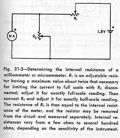

Anybody knows how to wire this thing up to measure line level signals? Do I need extra components? Does anybody have a schematic?
So your basic VU meters come in 2 varieties. Voltage driven or, more commonly, current driven. You need to read on it what the "full scale" range is. On most meters it'll say something slightly cryptic like: FS 50ua. Which stands for Full Scale: 50 micro-amps. It might say: FS 100mv if it was a voltage meter.
In any case, now that you've gotten the range right, you should go to Rod Elliots site, he's got a circuit for using analog VU meters. Project 55.

A cheap and dirty way of wiring it would be to use a 10K 10-turn pot to calibrate it to zero VU when bridged across an audio line. This works assuming that the meters have built in rectifiers. One of the nice things about the Sifam is that they use very good diodes so that when they are bridged across an audio line they introduce very little distortion. ($70 bucks, they ought to)
T and H pads can also be used for isolation and calibration.
The Rod Elliot solution is nice too.

Now, with the Sifam meters... do you just connect them across the audio lines without the need for addtl components? It will be line-level signals for a mic preamp output.
I used the AL 29 bridged across +4 dB voltage matched balanced lines.
The sources ran around 50 ohms and fed high impedance inputs.
To calibrate I would use a O Vu reference tone, verifying the level with a distortion analyzer. A 10 kohm pot was used to dial in the proper meter level. It’s not a very scientific approach, but it let us deploy a lot of meters (they were only half the price a dozen or so years ago) quickly for not too much money.
Using the ESP # 55 is a better approach. Having a high impedance op amp drive the meter as this circuit does gives nice isolation form the line that is being measured. The amp has a high impendence input making its presence on the line negligible.

All analog meters are current meters. Even if it says "V" it's a current meter with the appropriate current limiting resistor.
If you come across some good looking meters (and there are scads of them on EBay) you can determine the internal resistance with the setup at the bottom of this post. Sometimes there will be an internal shunt which you can remove. Note that some meters are compensated for steel rather than aluminum panels.
