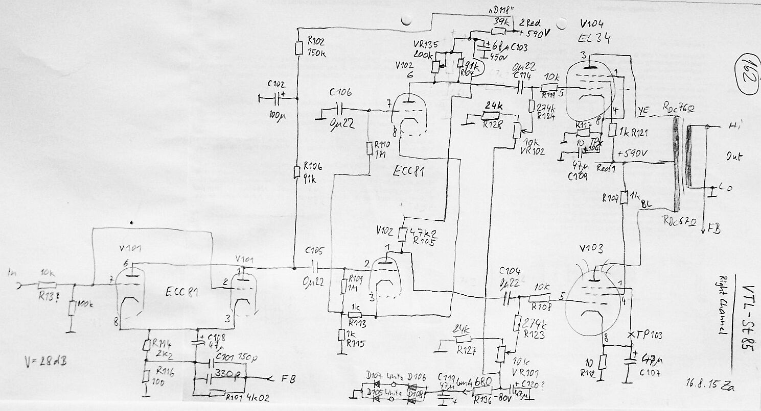

Anyone have a schematic for a VTL ST-85 amplifier? I have contacted VTL and they won't give me one.

I just have "painted" a circuit diagram about the vtl st-85 https://www.dropbox.com/sh/dwx3uhbl...eX_qs5aZt9Ra/20 Schaltplan VTL St-85.jpg?dl=0
may be too late for you
best regards, frank 🙂

Sorry for necrubumping, but I am also interested in a VTL ST85 schematic. The dropbox link does not work anymore. Does someone have a schematic that could be uploaded here?
Same hand-drawn schematic
Thanks a lot!
The 590 V B+ seems rather "hot" for the EL34 tubes. Is this how VTL does things?
Also, what's the purpose of the 200k pot on top of the second ECC81? Balancing the symmetry of the phase splitter outputs? Is this pot a set-and-forget thing, or does it make sense to tweak this setting when the driver tubes are replaced (or when they are aging)?
Any other insights or hints related to servicing this amp?
