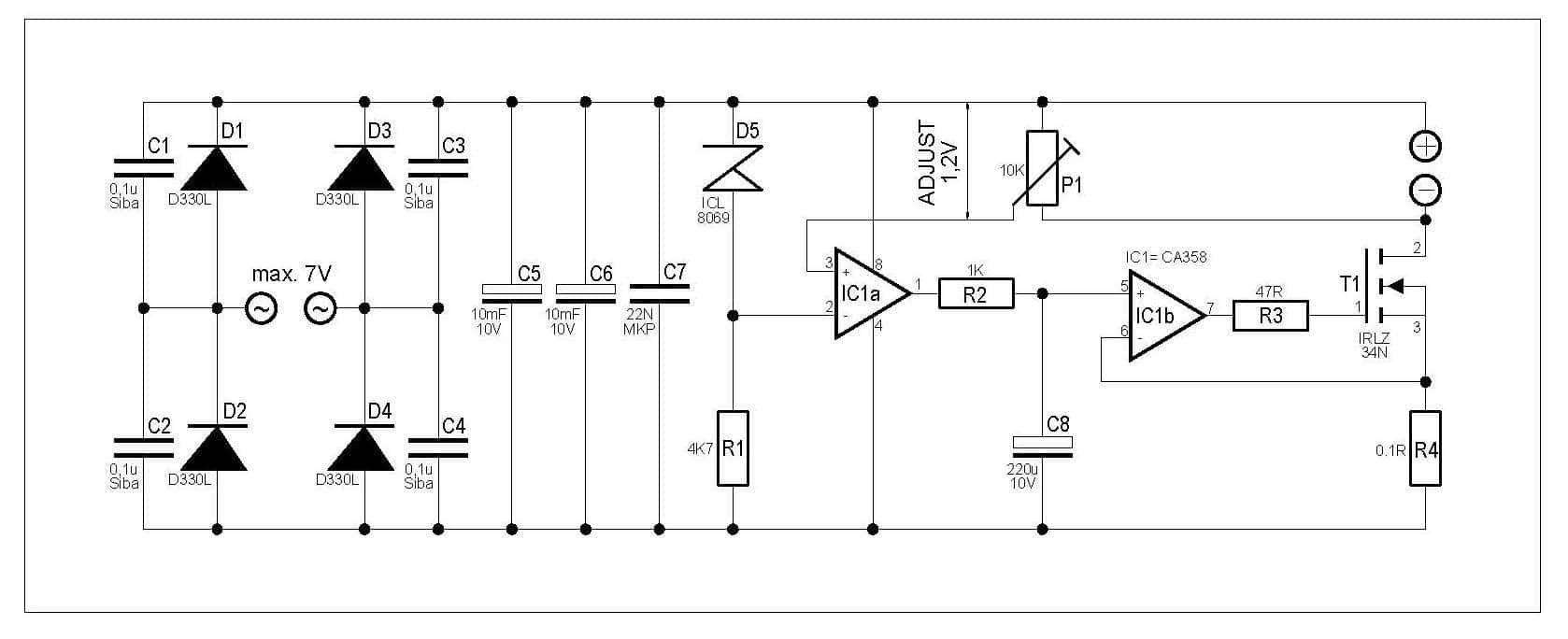

Hi.
In my VT25 I'm using these filament supply.
Problem is when I turn on preamp for 1 second I have big glow from valves.
I tried to measure output voltage from filament regulators and it is around 10V for couple of second and then goes to 7.5V.
I'm suspecting problem is low resistance of filament when they are cold.
I never had that problem with these regulators when I used 300B tubes, only with VT25.
I'm just afraid that these tubes filaments will break eventually because of that.
Is there any way to edit this schematics to have slow start?

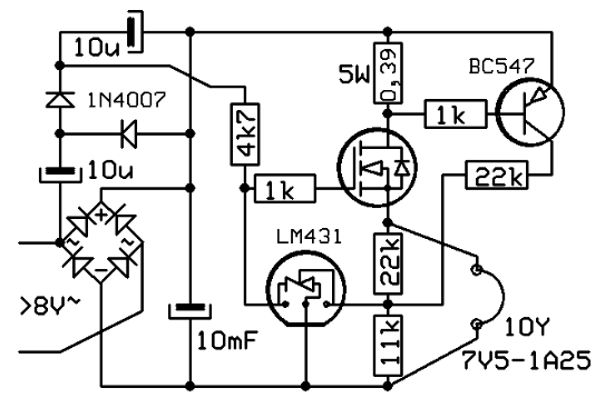

IMHO the worst scenario heating TT (thoriated tungsten) filament with constant voltage.
Thoriated Tungsten Filament power cycling
Why not use any constant current device (the simplest is made for LT108x) for slower heating (even in combination with any voltage regulation)?
BTW I usually use Rod Coleman regulators for DH tubes.
Rare DHTs (such 01a, #26, 10, 801 etc.) are expensive toys, protect of filaments is cheaper.
I wanted to avoid bulk power supply and heatsinks for Coleman regulators.
Wanted simple elegant solution and I already had these regulators.
I would like to keep them so modification of current schematics will be the best if it's possible.

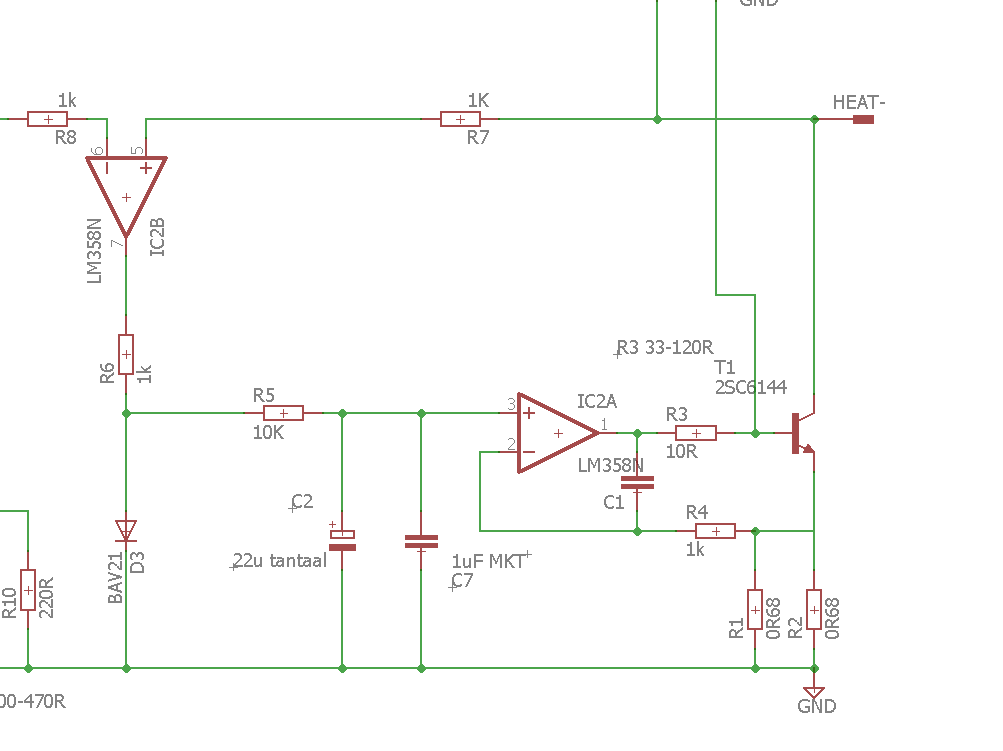

Can we add some transistor and capacitor to form soft start?
Something like this to implement in my above schematic?

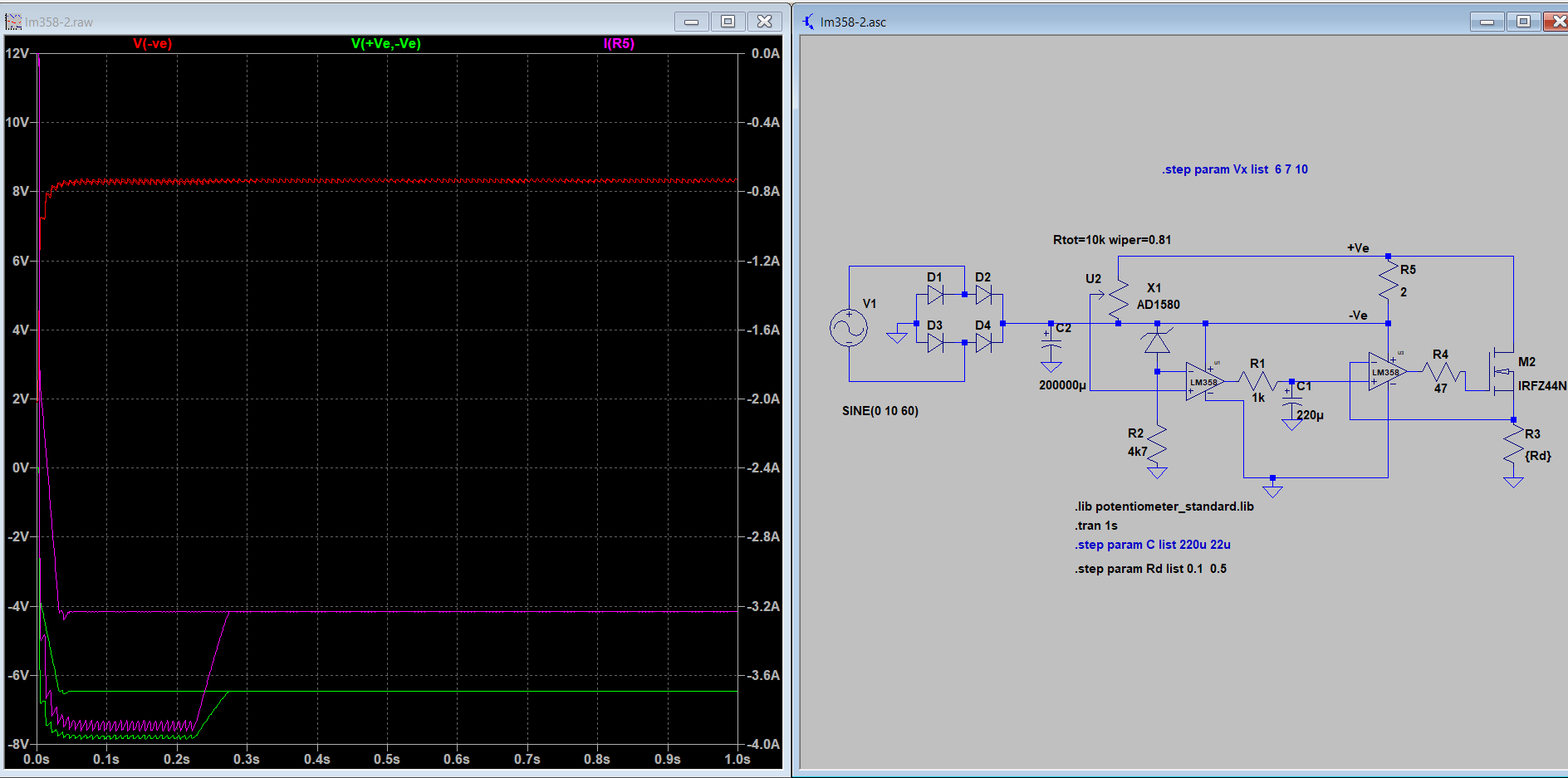

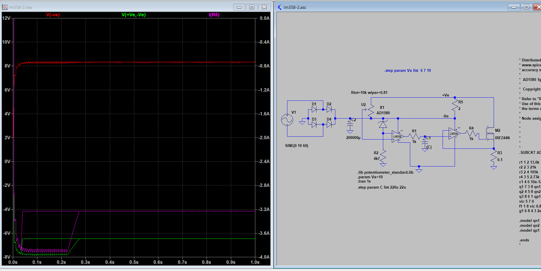

The time constant of R2/C8 is about 0.5s, so if C8 is reduced to 22u, it's reduced to 0.05s. i.e. making it faster for device to regulate, time of 10V out will be shorten to 0.05s from 0.5s
be careful not to get oscillations , altering that capacitor value

Late to the party but its because the 220uF capacitor can charge faster than discharge. And once the filament warms up the constant current through a hot filament will cause the voltage to rise out of specification momentarily.
The solution is to clamp the output voltage from the voltage comparator to some low value with a diode, and run the RC filter from there.
