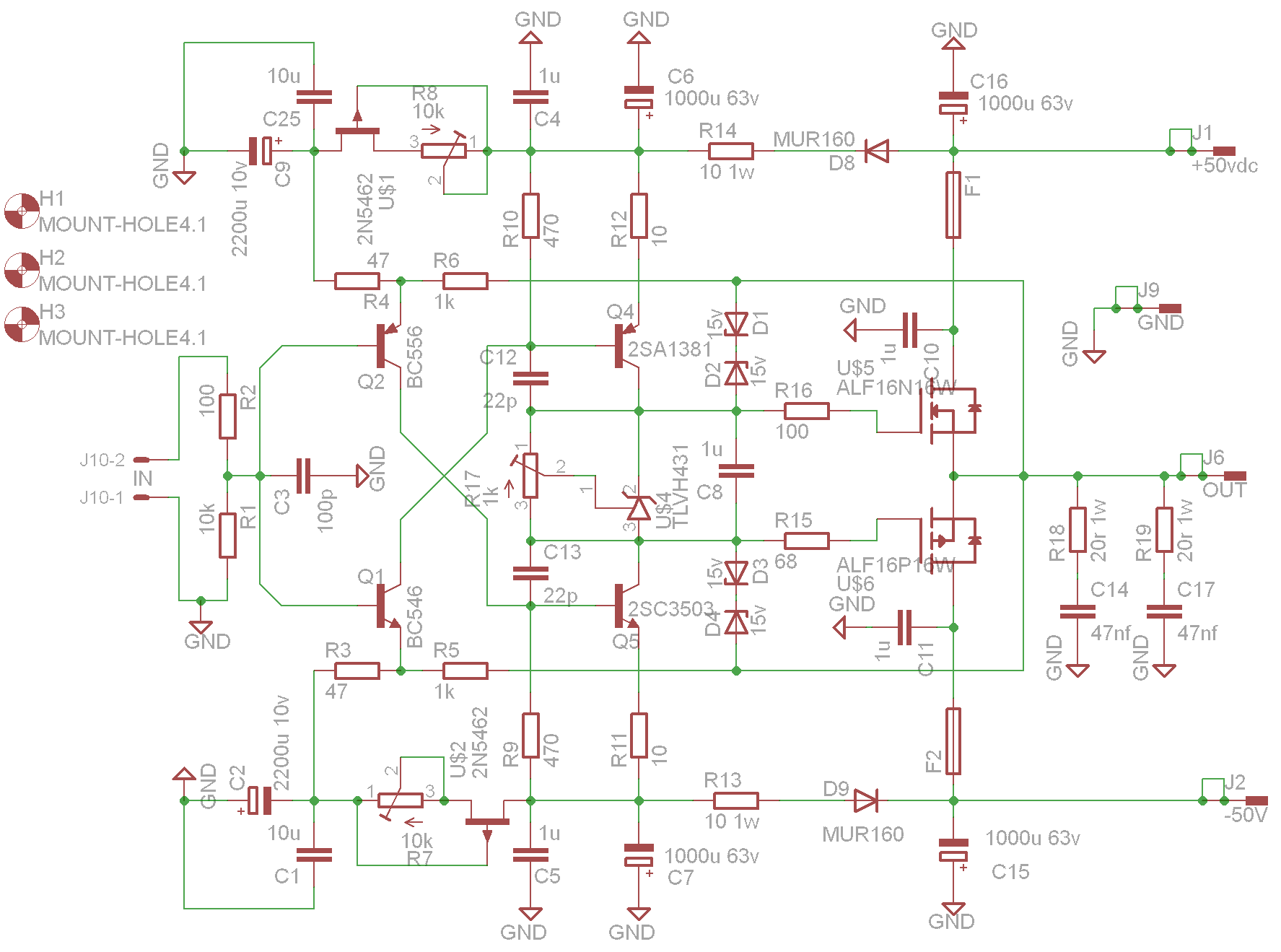

Last week i put together LC VSSA module with +/-36Vdc rail as i had 300va 2x25vac stock trafo. As i wrote it in vendor bazar thread, this module as some magic in how and reproduce sound with natural, detail, live sound. The "issue" (it's a really one??)for me is the samll amout of power comparating to the speaker that i use. Power volume button is turn on 2/3 to 3/4 from total possibility without having a really lound level. So the idea for me is to use 2 another stock trafo : Rcore 500Va 2x36vac (2x120 pri), that give my +/-50Vdc on rail in VSSA 104 public schematic.
As answer Lc that need small changes :

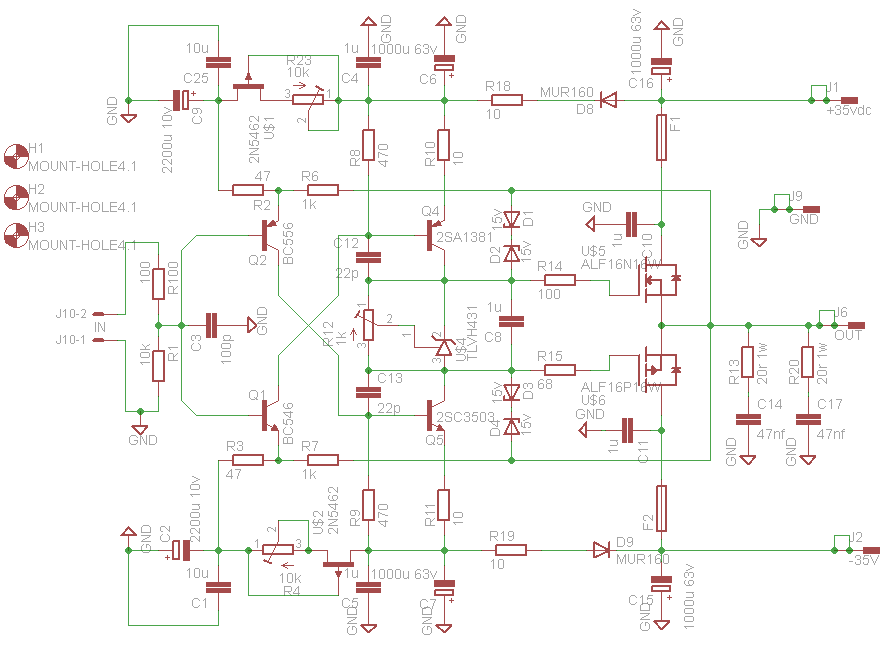

-First swap entry bjt to higher Vceo one : BC546/556 but is there an issue to use B grad instead C that are obsolet
-second change ALF08NP16 to ALF16N16 and ALF16P16 combo
-change R7, R8 to 10K : ihave difficultie to identify them as there's no numerotation on 1.4 schematic
-handel to ouput bias i suppose i have to swap from 182mA (2 die) to 364mA (4 die)
So that are questions turning in my head...in answer waiting time i take eagle rout as i've been more aware with it than with parts and schematic adaptation.

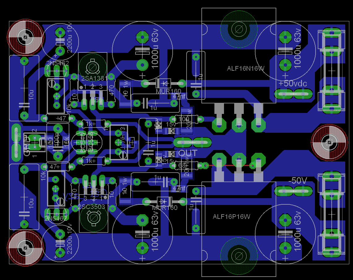

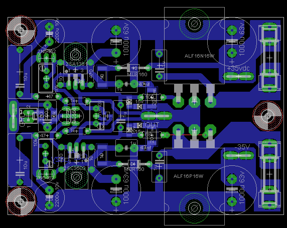

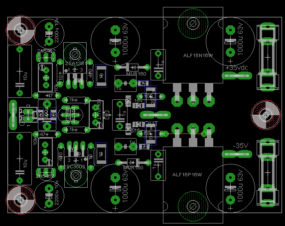

Under first attemp to layout

Can i change ALF with SK1058/sj162 ?
Didiet
They have not the same package and not same rating : To264 versus To3P and 16 versus 8A. ALF16 are double die in same package. One pair 1058/162 won't be enough for +/-50Vvdc rail voltage. Bur one ALF running i don't sink there is issue to modify layout icluding 2 pair 1058/162 and will do it if there is some interest

use 2 pairs K1058/J162 😀 but for lower voltage you can use it.
I made 2 pairs output version layout but not tested yet...

I have only K1058/J162 combo, for +/-45VDC we can still use BC550-560
for +/-50VDC why not try 2SC/SA combo...
LC answer me twice(at SSA & VSSA) about the hFE of input pair,
suggested value of 600+ hFE to get better gain per stage performance

For Add on, Exicon seem to have a similar device to ALF16 it is ECW20N20-Z and ECW20P20-Z you can find by profusion plc.

For sure i will share if there is an interest to. But first i need help to achieve mutation from VSSA 1.4 to VSSA 50. Without there will be no VSSA 50 alive.

While i was reding one more time whole VSSA thread i think i found answer to one of my interrogation : it's handel on R7 and R8 These are JFET-CCS resistor in fact multiturn TY93 on my board. So i redrawn schematic with new and more clean parts numerotation.
A this time the output bias for ALF16N(P)16 question and BC556/546 has no clear answer...

I think the 2N5462 is a 40v max device...
