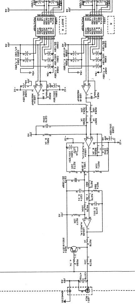

I have been working on upgrading my TEAC VRDS-8, trying to come closer to the presence and ambience of my analog system.
So far I have installed a clock upgrade, changed I/V and filter/output opamps to OPA627s, and changed all the decoupling/filter caps to BlacK gates.
The VRDS-8 uses dual PCM1702 DAC chips per channel. From the schematic of one channel (should be attached) it looks like I could get a balanced signal output at the output of the I/V stages (two per channel).
I like the idea of keeping things simple, less components in the signal path, and I know how good transformers can sound from my S&B TVC, so I was thinking of some kind of transformer connected right at the I/V opamp outputs (is the opa627 the best in this application), driving a balanced output.. this would also provide filtering...
Or maybe I could go for a simple circuit with discreet components...
Or.. any other simple suggestions? I know there have been many threads around this topic but they seem to deviate off topic and they probably go way back in time.
So what is the current thinking / experience?

I would not assume that because there are two dacs it automatically follows that they are in a balanced configuration. The labelling R and SHIFT R suggests that they are in a staggered configuration.
Since the outputs of both I/V opamps feed straight to the + and - inputs of the next opamp, I would have thought they could just as well drive a transformer and give a balanced output... or am I missing something?

Yes, if the output to the dacs is staggered. You would have to remove the stagger and invert the input to one dac.
Have you looked at the schematic?
I know its sideways (to fit the size limits) but if one DAC output was not inverted then nothing much would come out of the next opamp after the I/V stages since they seem to preserve polarity.
As far as 'staggered' goes, I fail to see the significance (a nice way of saying I dont understand but I dont believe it anyway until proved otherwise).
Could you explain what you mean?

It is not about the input to the I/V stage. It is about the input to the dacs. That part of the schematic is not there so one has to speculate. Based on other VRDS schematics and reviews a staggered configuration seems more likely to me.

You are most likely right that the DAC output is staggered. The input circuit to the DACs (too big to attach as one legible file on the BB) has an AD1893 sample rate converter, followed by an SM5843 digital filter, plus lots of inverters, serial to parallel shift registers, analog multiplexers...
There is a control on the CD player for 'DS point' which I think changes the effective oversampling rate.
Tomorrow I'll stick a dual trace scope on the outputs of the I/V converters and see what it looks like.
However, back at the schematic - even in the case that the DAC outputs are 'staggered' or whatever, since they go to the + and - inputs of one op amp after I/V conversion, couldnt I still just wire in a transformer instead?

Forgive me for banging on about this, but regardless of the dac shifting/inverting/whatever, what would be the problem to connect a transformer to the outputs of the two dacs in one channel? This is really the issue, since you brought it up.
My hope is that I can remove all the circuitry after the dacs. I would connect 390R resistors from the Ioutputs to ground, then connect a 1:4 transformer across the Ioutputs for one channel to give me a useable output voltage.
I could even try connecting the Iouts with one load resistor and connect the transformer across it.. (maybe a little bit more dodgy)
The main question is, what is so wrong with this approach as long as the original circuit (attached to Post#1) shows the outputs of two dacs driving one opamp?

I can't see any reason why a transformer should not work. The op-amp is working as a differential amplifier so you should be able to replace it with a transformer but you will not get any common mode cancellation as the two dacs are not converting simultaneously assuming the output is not balanced.

So, finally I have some data!
I disconnected the Iout pin from the two PCM1702 DACs in one channel. Each Iout was connected thru a dedicated resistor to signal ground using an old passive balanced shunt resistor volume control which I retired when I converted to TVC.
Then I connected up a dual trace scope to Both the Iouts and looked at the P-P voltages while playing a maximum amplitude test CD.
For a start the DAC outputs were identical but inverted. When I added the signals I just got background noise. When I added the the signals with one channel inverted (ie differential mode) I doubled the output over the single DAC outputs.
I have plotted the differential output versus the I/V resistors used - attached are the plots.
There are a number of conclusions:
- Low resistor values (28 & 73 ohms especially showed more background noise)
- High resistor values(over 400 ohms) started to show a non-linear response. Not a sharp clipping but the plots show the voltage output started to be limited. This would lead to less dynamic range.
The optimum I/V resistor value for the PCM1702 seems to be in the 300 - 400 ohm range. (see the plots).
