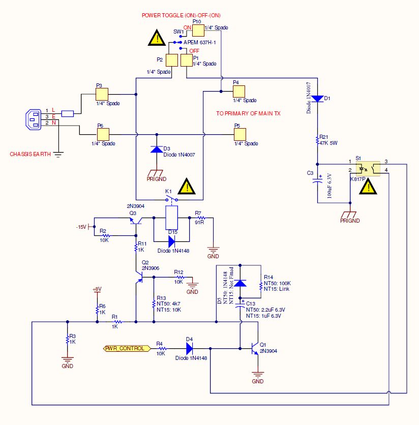

I looked at the schematic again out of curiosity and this time I made it to the 4th page where there is some sort of system that can shut down the amplifier. It's wired in between the power receptacle and the power transformer. A relay can control the power in some amps. It appears that the relay driver is connected directly to an output on the microprocessor through a connector labeled "MIDI."

Just thinking aloud: I looked at the übercomplicated power on circuit on page 4, top left.
I don´t see a thermal protection switch or similar "safety" or "convenience" 😕 features but a nerdy power switch.
Apparently Power ON toggle has 3 positions:
* Up: ON like on a standard circuit, it connects Mains Live to 1 end of power transformer Primary winding (the other end is always connected to Neutral)
* Center: "intelligent" 🙄 ON . Called APEM something. (Automatic Power Management???)
Mains goes nowhere through switch but Relay K1 *can* (if so ordered) connect Mains Live to PT Primary.
* Bottom : "Intelligent OFF" (again [rolleyes] smilie)
It sends mains live to an Opto which I *guess* turns K1 relay OFF, no matter what.
My point is that rather than a FAIL condition (which anyway may be possible) I guess somehow the Power ON switching is failing.
Might be any of:
* bad/flaky power switch SW1
* bad/flaky K1 ... which might be as simple as having it poorly plugged in if in a socket, or cracked solder on its pins, or weakened/pitted contacts
* damaged relay drive circuit, built around Q1/Q2/Q3 and associated components OR simply -15V supply might be missing , or +8V line
* OR for some unknown reason Microprocessor might be ordering Q1 to turn K1 OFF
BUT at least as shown, SW1 does have a "straight ON" position, where 2 metallic contacts connect PT primary to Mains, "like in the old days" ... this switch *might* be weak/flaky.
I would check all circuit possibilities, including "direct turn ON" through SW1 , would even bypass it with a regular switch, just vto confirm/discard this possibility ; measure voltage across K1 coil; check whether Q1 gets turned ON by microprocessor (check that it gets around 700mV BE or not).
Just suggesting a few few possible issues to be checked.
And yes, it may be a reaction to a yet unknown prioblem.
Me? ... I am a minimalist, love simple straightforward solutions to problems, even if now and then I have to .... ugh!!! .... think😱
In general "intelligent devices" trying to "help" me scratch me the wrong way.
NOTE: be careful, part of that circuit is connected to live Mains voltages.

The supplied schematic shows two versions.
Page 1 is the standard PSU version and page three shows the remote standby PSU version.
Would be useful to find out which one is employed as there will be totally different possibilities.

Excellent way to find faults in a "normal" amplifier, such as 99.999% of them.
But in this crazy one, a problem in the area I suggest to check will not even feed mains voltage to power transformer so you will find:
even if none of them is at fault 😱
