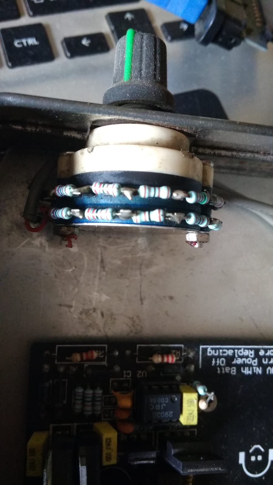

I use stepped attenuator with handpicked matched resistors., for my O2 H/P Amp. DIY Cost under 4$
