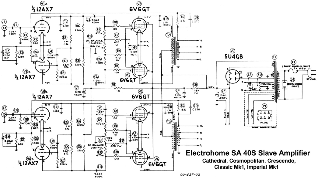

Where is a good location for adding a volume pot on an Electrohome
6v6 push-pull tube amp? Also what pot value?
Add the control at the inputs, before the coupling capacitors (or delete them).
Use a 100k stereo volume control, but a range of values could work,
depending on the source. The wiper goes to the capacitor (or grid).
Let's keep this simple. Insert either a ganged, stereo, or 2X mono log. taper pots. between the I/P jacks and the 0.047 μF. capacitors. Use 50 Kohms for the control value. Connect the "hot" jack terminals to the control "tops". Connect the control wipers to the 0.047 μF. capacitors. The control "bottoms" get grounded.
I plan to use this amp with a DAC, which outputs 1.95V rms
Is the 100 kohm pot suitable in this case?

Yes, although perhaps a 10k volume control would be even better with the DAC.

"Standard" practice is for the O/P impedance of a driving component to be 1/10 the I/P impedance of the driven component. 50 Kohms is, for practical purposes, 1/10 of 470 Kohms.
Commercial products will be capable of driving the IHF 10 Kohm "standard". If the DAC is a commercial product, 10 Kohms as the control value is fine. OTOH, a DIY unit might not do well into 10 Kohms.
