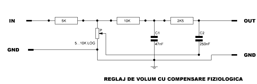

I have build many volume control units but i stumble'd upon a pasive volum control made only with R.C. components i have built it ( can put pictures since i dont own a camera ) but did not teste yet and i want to know wath do you think about him,some ideeas , opinions are welcome'd ! The schematic is for mono channel but for stereo are 2 and a dual gang potentiometer,so hope you are interested ! Thanks allot ! 🙂
P.S.- Its physiological compensated volume regulator so it follows the
" human ear line "

It will work in the sense that it will vary the volume. It will work in the sense that the frequency response will vary with control position, assuming that is what you want, but to what extent this will mimic the Fletcher-Munson curves I don't know. It looks like it will let through some bass even at 'zero' volume.
Im disapointed it does just that , bass at zerro volume level ! 🙁
