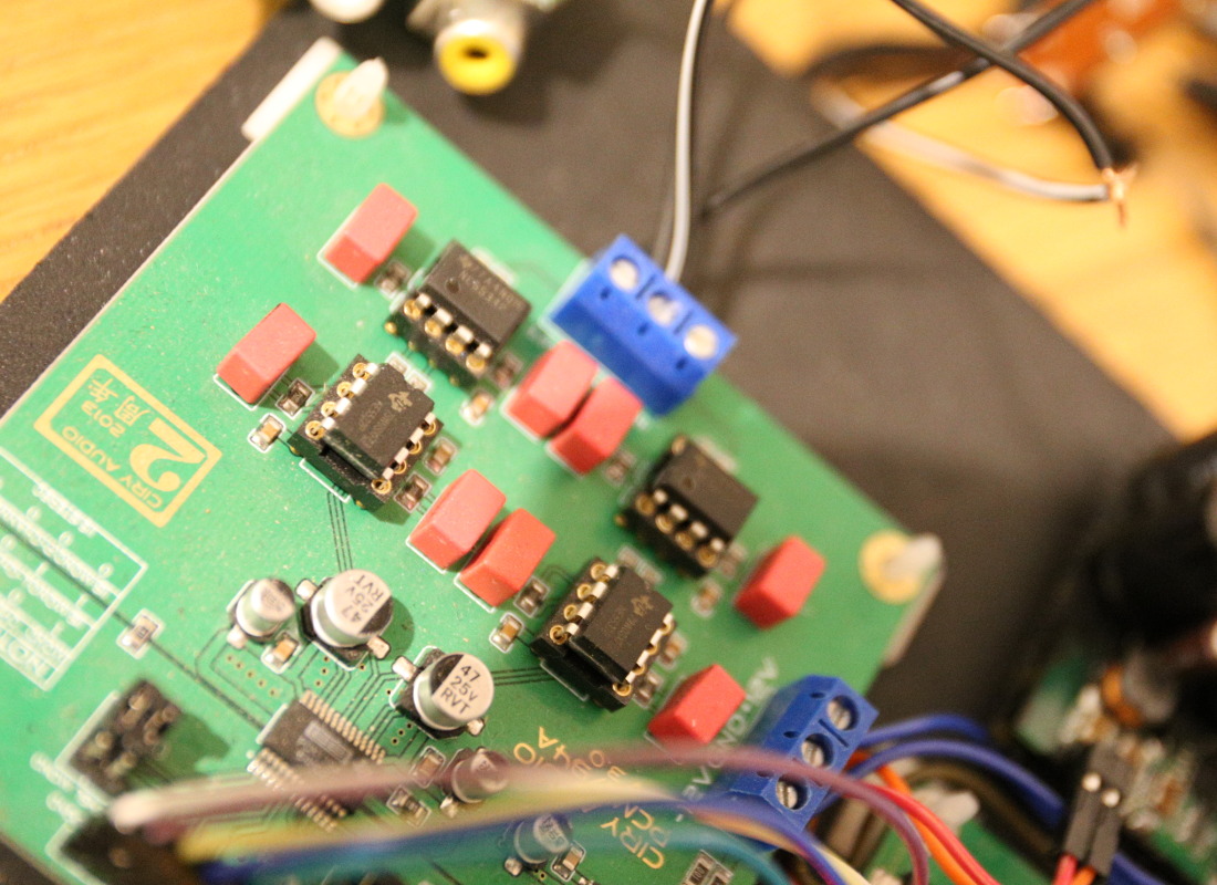

I have a USB Dac based on the PCM1794 chipset. There is no volume control and I'm feeding it into active speakers (also with no volume control).
The active speakers have an impedence of 47k. The volume is high enough at present so I'm only looking at a reduction.
What would you recommend? At first I tried a 10k sliding potentiometer but the quality of the output suffers and it has almost no control.

It should be possible to use a potentiometer at the output of the DAC. If the DAC output (the filter output) cannot pull 10K then try with a 47K potentiometer.

So I have a 10k slider potentiometer from the output to ground. At anything above about 500 ohm it's at full volume.
You have a linear slide pot, so it's no good for a volume control in this application.
A volume control that you need has a log taper, like the one linked in post #3.

It would, you would just turn the knob further clockwise before reaching 500 ohm/9500 ohm.
<500 Ohms across the output "near-shorts" the output, making it work too hard and distort more.
10K in series "strangles" the signal to the amplifier. In this case the amp input is not a pure 47K, but apparently lower in the treble, lost highs.
THE answer is a combination. As said, 10K across the amplifier (light load) and take a TAP from a selectable position along the 10K to go to the amplifier. If you tap in the middle you get half the signal(*); tap at 1K up you get 1/10th signal.
With a 10K potentiometer the maximum impedance at the wiper is 2.5K, which the amplifier should not mind. (Long cables can matter.)
A true Linear potentiometer is good for making small changes around 25%-75% of max. The way we usually run audio systems we need good control down below 5%. An "Audio" taper stretches-out the lower levels so you do not have to dial-in 0.07 on a 0-10 scale.

Any DAC which will not drive 10K (8K full-up) must be very strange. The observed DAC output is near 500r, so 10K-8K is a light load and it will be happy.

Nearly sorted, the pot's I was using were wired incorrectly.
