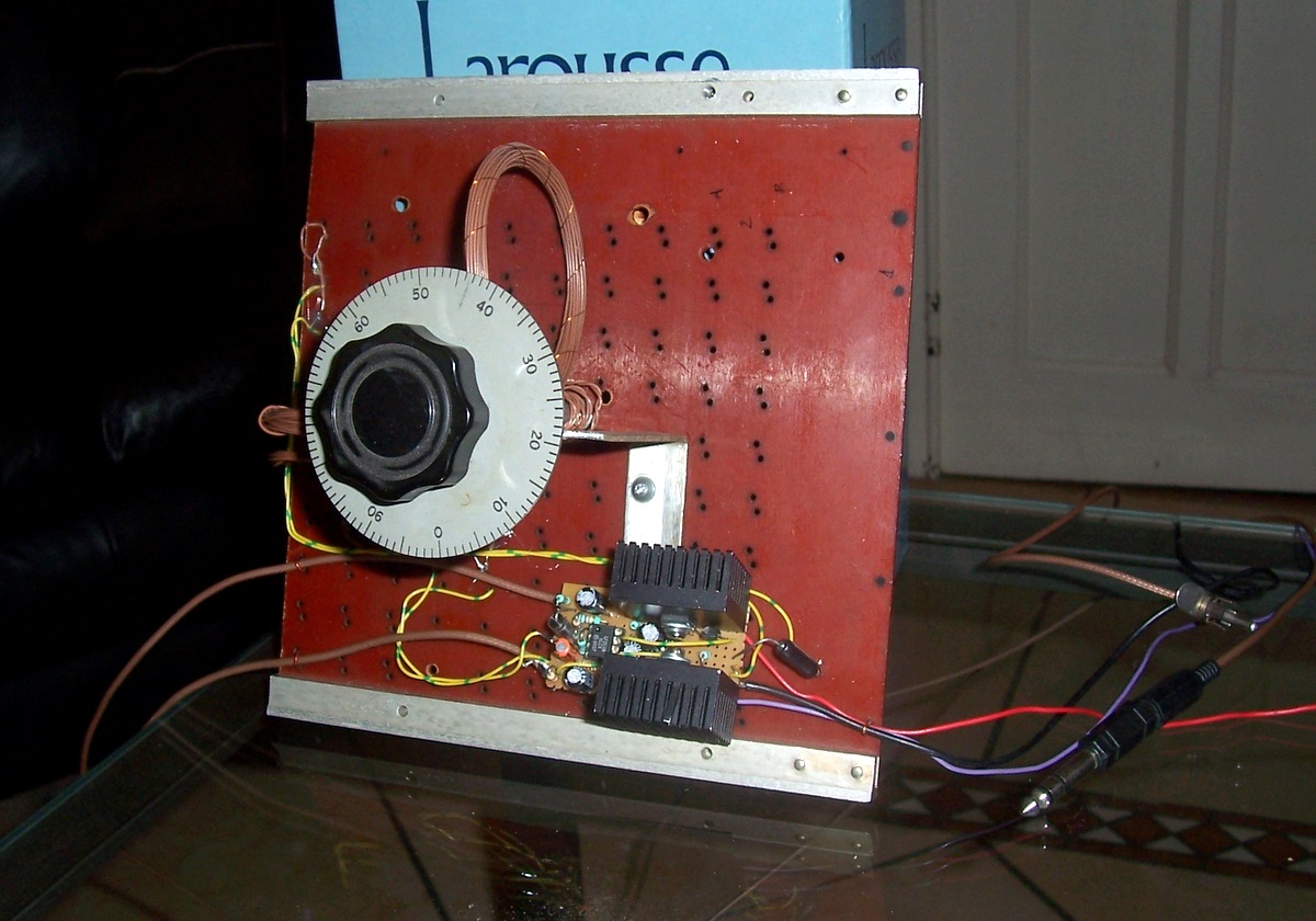

Here is a new idea for volume control: it uses the principle of
:magnet:variable magnetic coupling :magnet:
:hypno2:
The coils used are air-cored, meaning they introduce no distortion. 😎

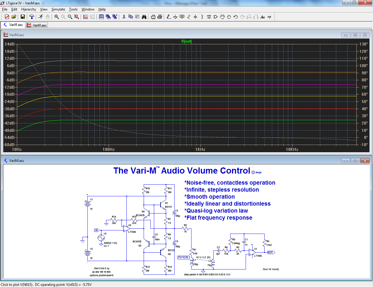

Obviously, there has to be a frequency correction, but this is pretty straightforward, it is essentially a first order compensation.

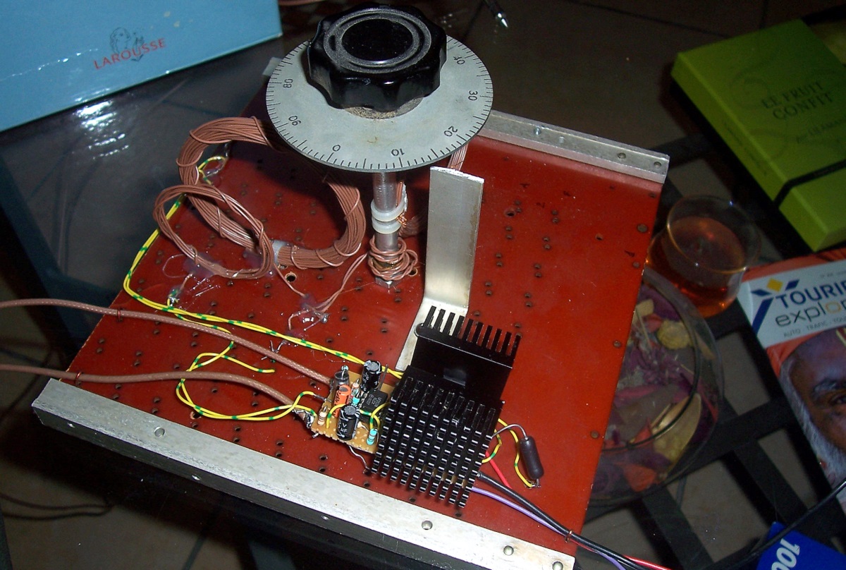

The prototype is a proof-of-concept demonstrator, bulky, open and unshielded, for real applications the coils should be made with proper wire, not PVC covered wiring cable, have sufficient turns, and the assembly should be enclosed in a shield.
The values on this prototype are preposterous for audio: the coils only have 35t and 25t, with correspondingly low inductances (I made them first, measured them and made calculations and design around them) .
The transmit L/R time constant results in a 13KHz corner frequency, meaning there has to be a huge correction and a hefty Tx side amplifier.

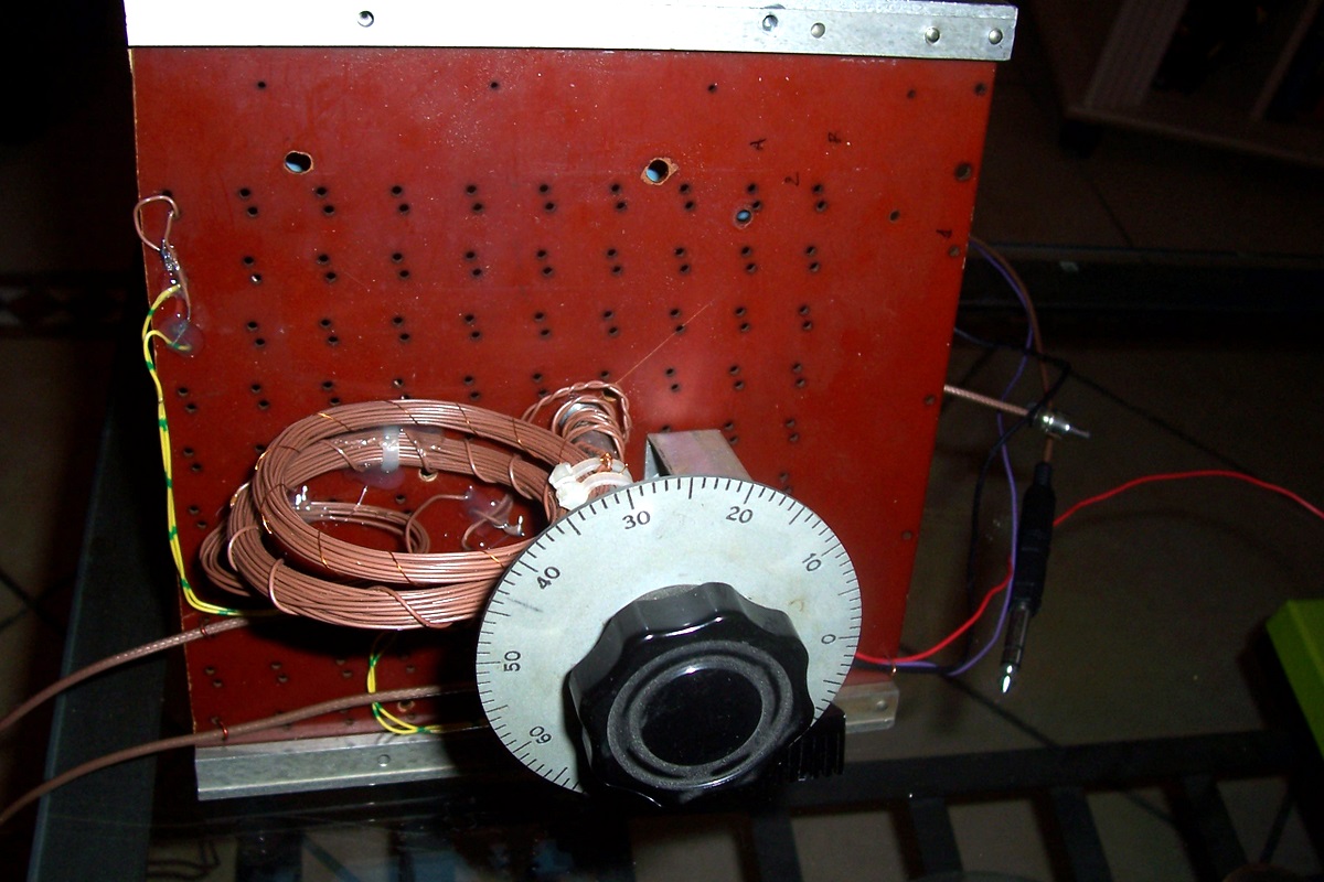

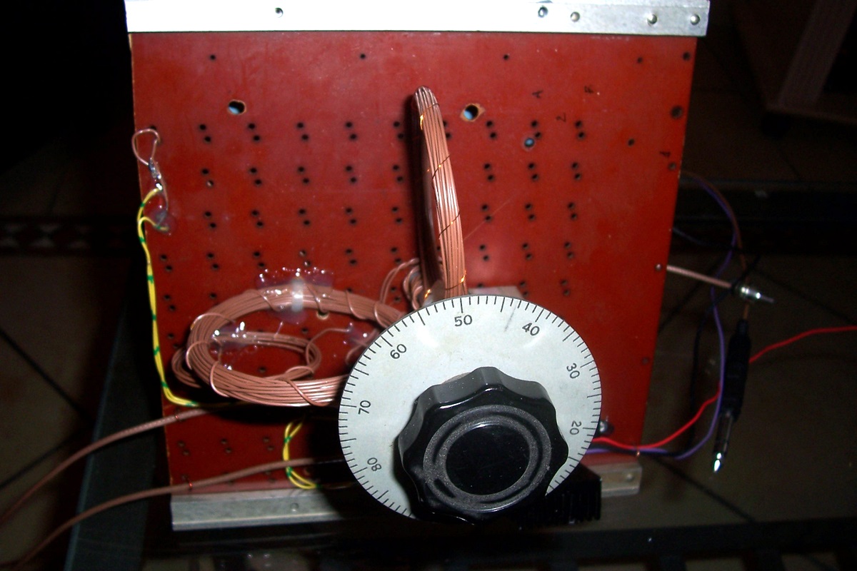

Even so, the prototype works exceedingly well, with a nice and smooth variation, a perfect null thanks to a small auxiliary coil and a perfect audio transparency. Very pleasant!
The overall gain is much larger than 0dB at the maximal volume, a resistive pad is included at the output to restore the level and reduce the noise.
Other strategies would be possible.

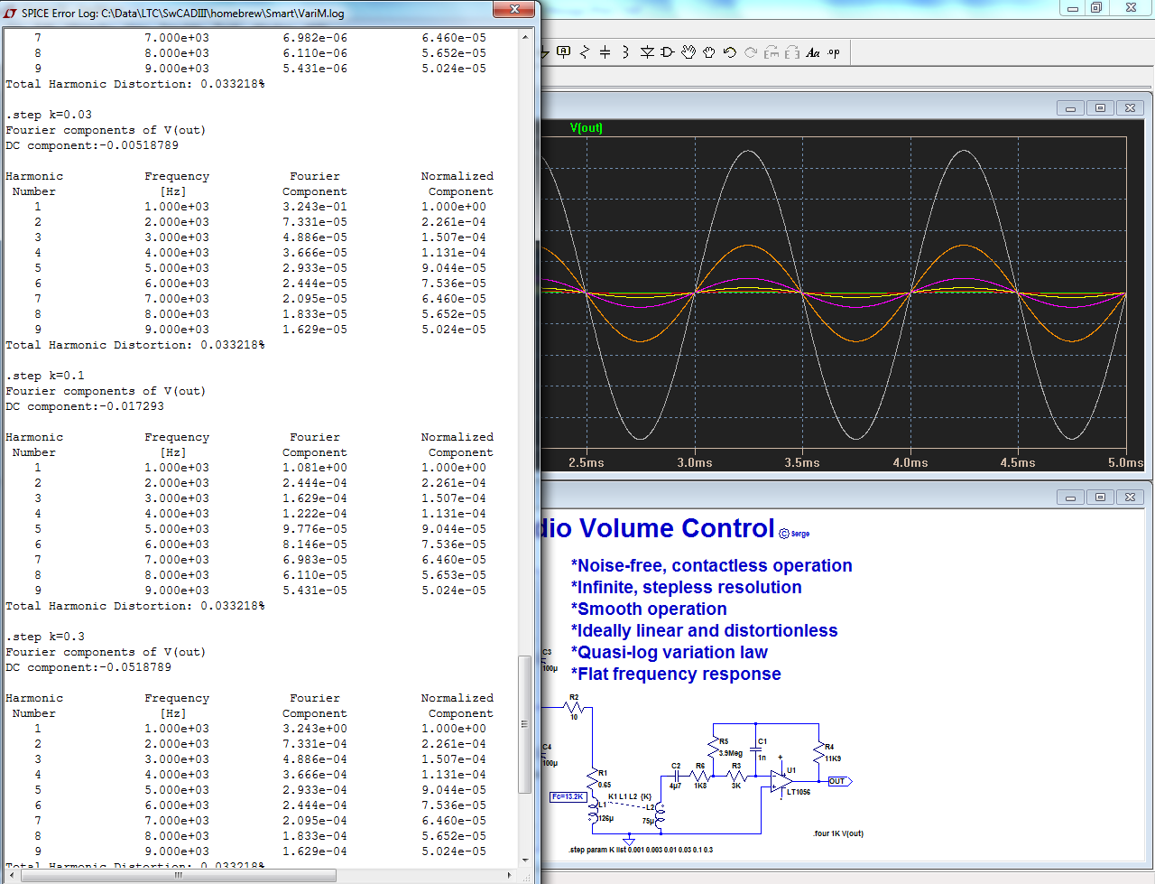

The distortion you see in the sim is almost completely caused by the output integrator because of the silly ~100µH value of the coils.
The LT1056 is not particularly low THD, and the values around it have not been optimized. But the value shown is highly realistic, because (unsurprisingly) LT parts are very well modelled in LTspice
With realistic coils, a good audio opamp and a little care, ppm levels could easily be reached. Not only in sim, but in reality too.
