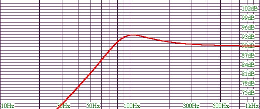

Actually, It was just out of interest. The question was more of a "what will happen if....?" I am butchering a pair of old cabs to make monitor wedges for stage use. The cabs are only 22.5 ltr. and I have a pair of Audax AP210M0 8"

Qms 3.30
Qes 0.92
Qts 0.72
Vas 63.751

Here you go. An Audax AP210MO in a 22.5 liter sealed cabinet.
You have a 4 dB or so hump at 100.
If you stuff the box full of stuffing, you might be able to take that hump down a bit. Or, you might just equalize.
