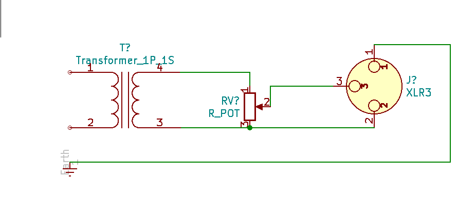

A level adjustment pot has to be either on the input side of the pre or between the two tube stages.
This 1K pot is at the wrong place and wrong value in the schemo.
Wrong as drawn
MIGHT work if shorting pot placed across the XLR pins, *after* the 300 ohm resistors R5 and R6 but still the proper way would be to wire it as a non shorting volume control.
Transformer secondary end to end, "ground" and wiper to pins 3 and 2 respectively.
1k pot value is fine there.
It is a drawing error. With the pot on the right side of the 300ohm resistors it will work perfectly.

No, its not. Its the complete wrong pot type in this application.

The circuit provides a perfect balance, an acceptably low output impedance and does not overload the amplification stage.
It does not have a constant input impedance but does it really matter?
Sorry but you are wrong.
It stays a balanced output for the very good reason that it´s floating, completely unreferenced to ground, it comes from the secondary of a transformer.
If it drives a true balanced input, either active or best, a transformer, it works as intended.

It is balanced. Only i/p o/p impedance is not constant. Does it matter?
It will pass audio and is adjustable.

My concern was not to short the output transformer which is never a good thing.
how would this circuit work when the pot is shorting the OP transformer?

Did you read what you were told above? Move the pot to the right side of the 300ohm resistors and all will be well. For the record, shorting the transformer won't blow anything.
